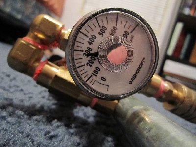

Despite the revised pump head, the o-rings are extruding themselves through the clearance gap at pressures above ~220 PSI.
My piston is 3/4" diameter, and type L copper tubing (3/4") is .785" inside diameter.
However,
Working on the pump, I noticed I had somehow bought a piece of type M copper tubing for the pump body, giving a clearance gap of 0.0305".
So, unfortunately, the testing I planned for today is delayed even more until I buy a length of type L and a female adapter to fix this.
Or, I might wait to but a HPA source, since, after cutting down the chamber, I can now get about 14 shots from a fill. Not spectacular, but it's better than 6...
EDIT:
*blares Celebration Day from Zep. III*
Finally got my pump working. As stated, I simply replace the pump body with some 3/4" type L and have no more problems with o-ring extrusion.
However, my piston leaks past ~250 PSI, I've found out. :roll: I'll just have to attack that tomorrow with some dowel rod and stick-on sandpaper I guess. Even with the leak, I just leaned into the pump as hard as a could, but ran out of steam at around 275 PSI (the thing would have been to 450 by then without the leak).
Overall, the HP side of this project is coming along nicely.
Preliminary results, thanks to the leak through the barrel port. After about 15 minutes of vein popping, winding effort to keep up with the leak, this is about all I got to.
Revised pump head. No teflon tape here. :D

Double post, but I want people to see the updated version and video. Tell me what you think!

First post, people. Updated pictures and damage video. Problems all solved.
(Except my wimpy stature not capable of pumping the gun to 400 PSI.) :lol:
