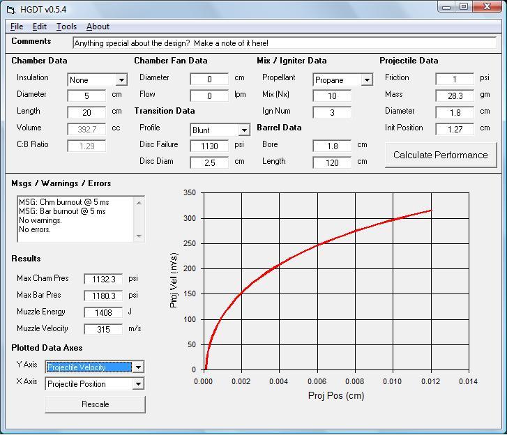

Maximum pre-ignition pressures in this cannon are more like 10bar, I've never exceeded that before and don't intend to. Maximum chamber pressures upon ignition are closer to 70bar. I've never modeled a cannon in HGDT which has pre-ignition pressures of 20bar with peak combustion pressures of 150bar so I wouldn't know how close your guess is.
