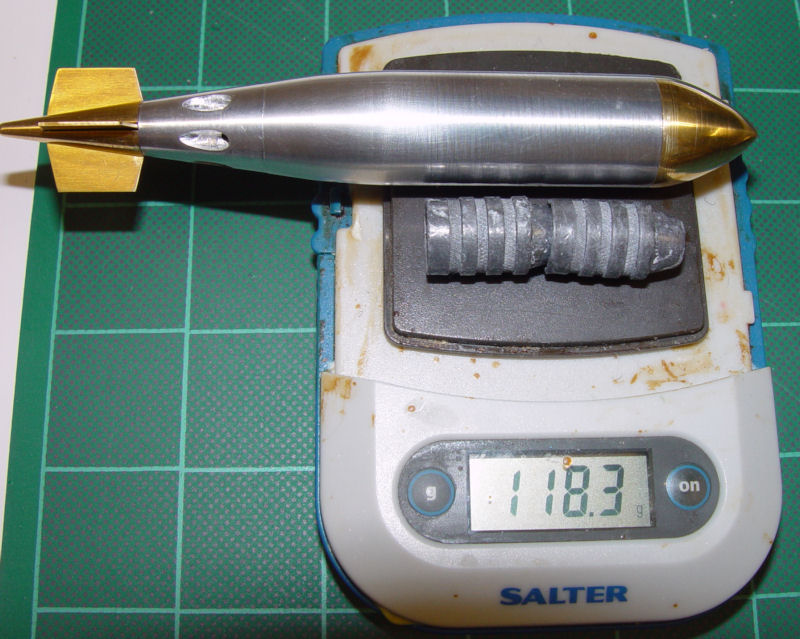

Every thing so far exceeds the weight of the projectile. (if it is 100 grams)
It's 68 grams empty... but remember it is supposed to be filled with tungsten bits. So I expect it will weight more than that!
Half filled with lead, it's about 120 grams.
