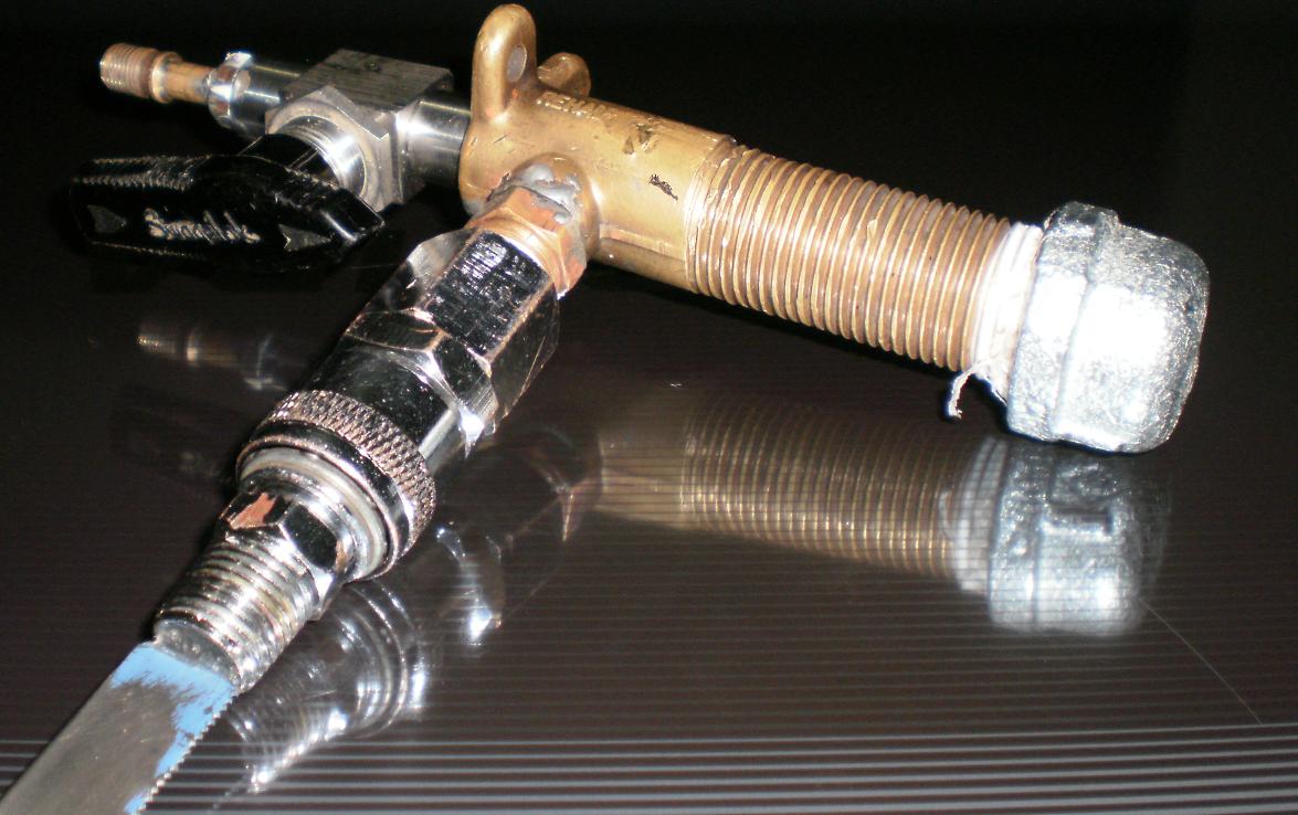

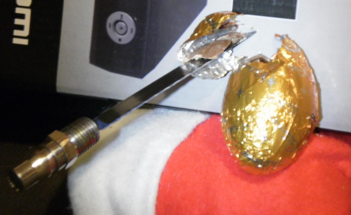

Jsr was talking about using a quick connect to make a ballistic knife in another thread(cant find it), so i gave it a go. Its quite powerful at only 75 psi it made it thought a ester egg and 1 peace of card board, not bad since it has no barrel. The blade is made from a broken hack saw blade pretty sharp.
edit vid
damage pic.
damage pic.
the blade. it only sharpened on one side with a bench grinder
the hole thing. good entry for teh ghetto comp.

So all you really need is a blade and a QD without an internal check valve? Neat :)

yeah thats all there to it. just gotta leave the rubber washer in there. its only good for about 200psi because its super hard to open any higher.

Good, will like to see what you come up with. If you want it for long range(2m+) you will need a front heavy blade. This one will fly about 5-6m, most of it sideways :D

i could mod what i have, like
the rubber washer in side the QD would hopefuly seal the pipe connect.
