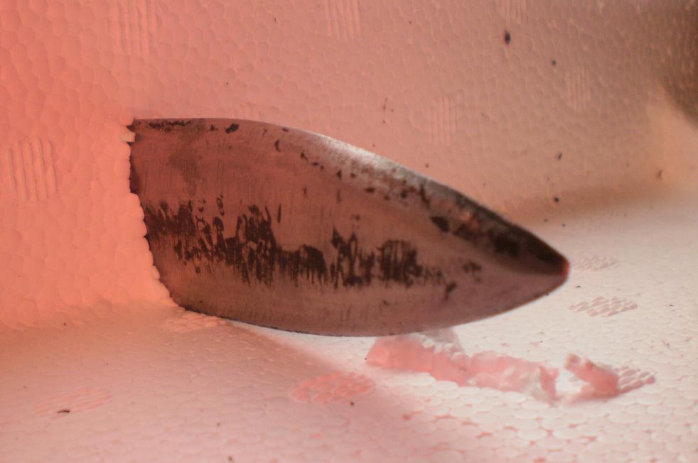

i also have an update, more damage pics/vid. its only at 100psi again, because i cant find something good to shot at.
edit [youtube][/youtube]
went right through, like its polystyrene or something.
the target is 5 and a bit centimeters of polystyrene
