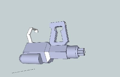

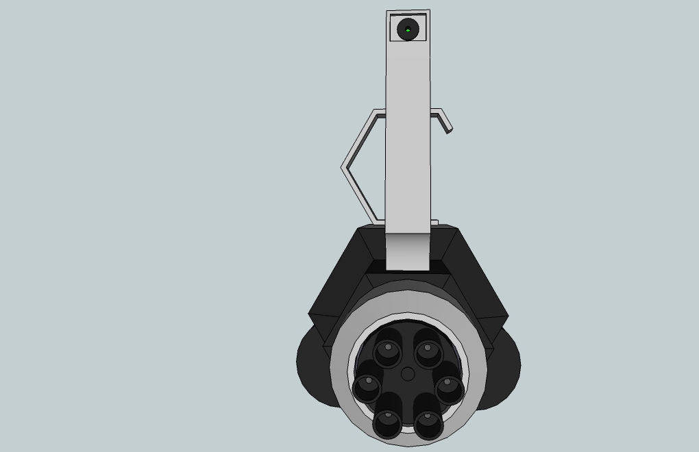

I also have roughly worked out my size limit for inside the case. See picture below.

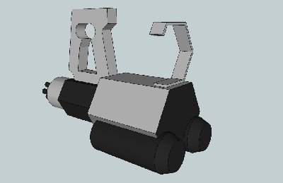

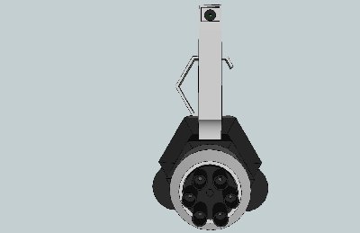

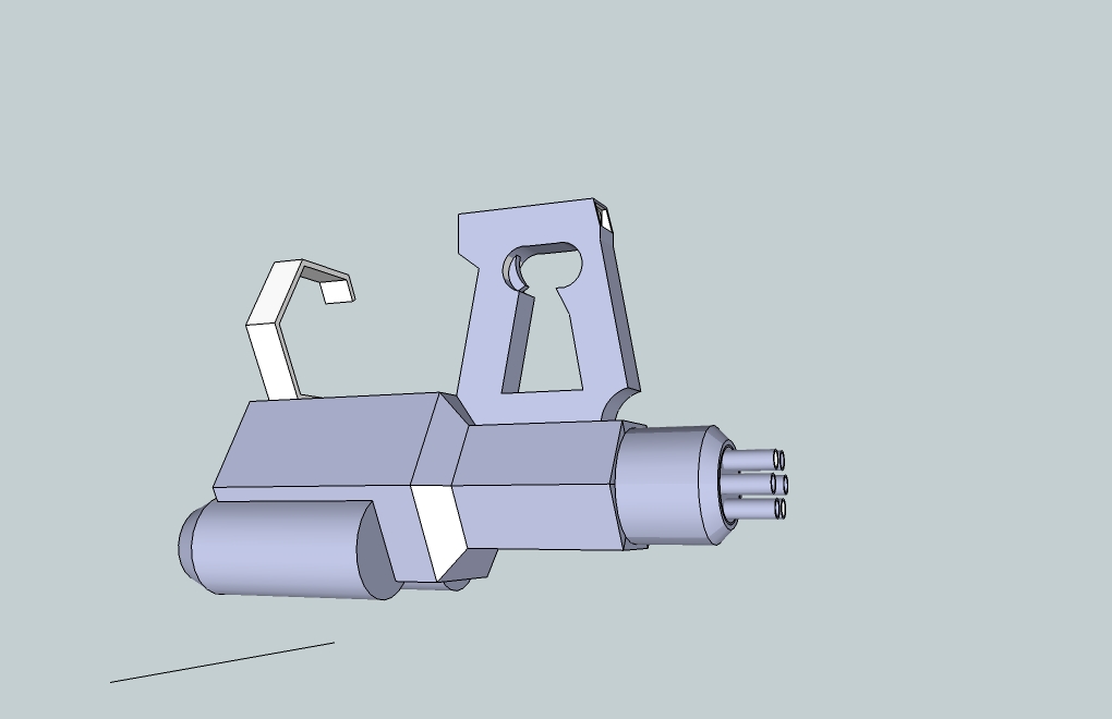

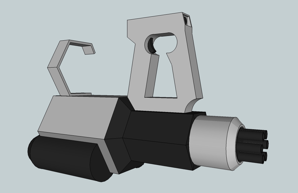

Been playing around in sketchup trying to get happy with the size and shape of things. It's missing a ton of detail and beveled edges, but you get the idea.

Well I made the images look better in hope that someone will comment. haha
Still missing a ton of detail, but I am more concerned about getting the mechanism to work first, all the beauty can be done when it works.
I'll be adding a green laser sight like in the movie, unfortunately due to it's placement at the top of the pistol grip it will take quite a bit of adjustment to get right, and even then it would be off by a bit at distances. I'd probably work out some kind of scale so you can tune it based on the distance you are from the target.

It will certainly look good when finished, but you should sort out worky bits before worrying about aesthetics ;)

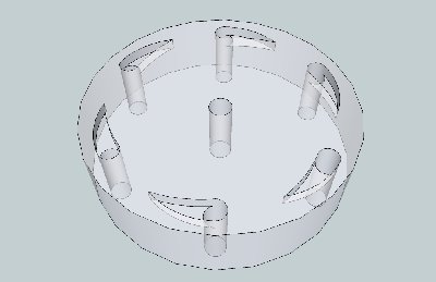

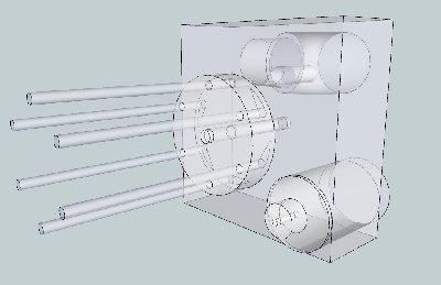

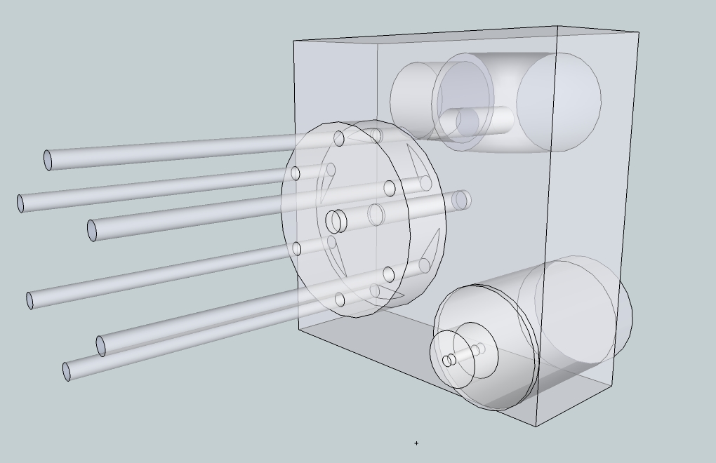

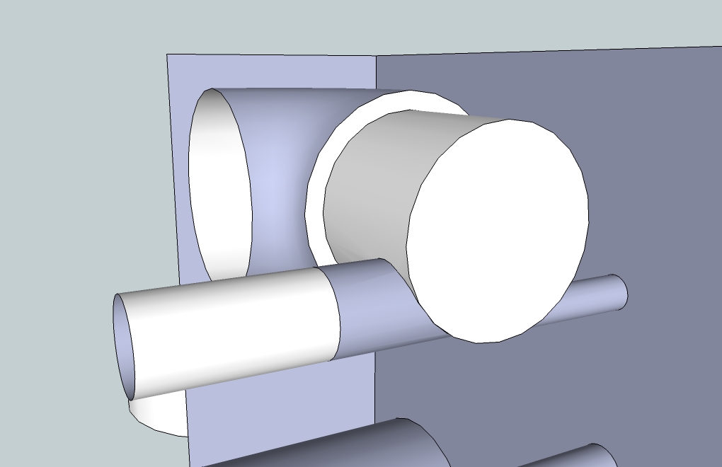

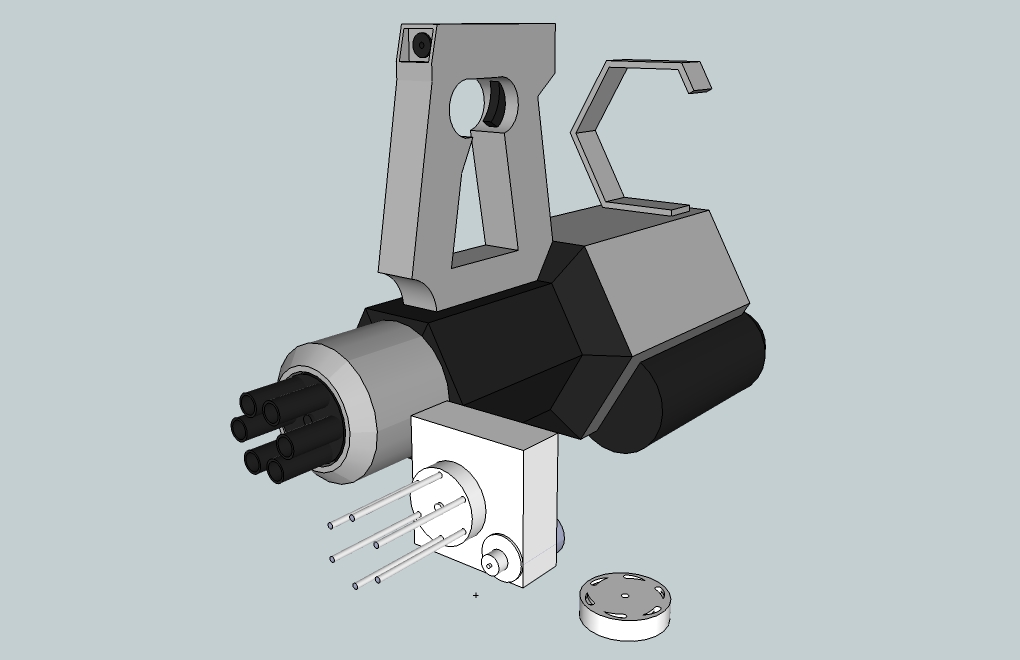

Been doing some designs of the actual mechanism to make the plan more clear.
I also did a separate model of the MOARair block. Though it is a horrible model as I couldn't be bothered spending ages just drawing it up. In the actual aluminium part the tails would be sloped and the leading edge would be beveled to also help the BB enter. I can hand sketch a better drawing if anyone wants.
The barrels in the image are way shorter for convenience of making the model, they would be almost full length in the real gun.
Size comparison compared to the full gun. Not too big really. 110x110x40 (mm) for the main mounting block.
My patented MOARair device.<br />see comment for details.
Full x-ray of the whole firing mechanism, excluding O-rings, bearings, belt drive and a few other details.

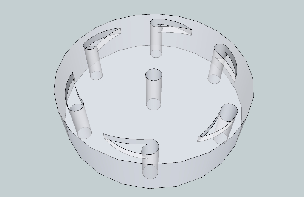

Simple vortex cap, bigger air input than barrel size to help fix the dead air problem
