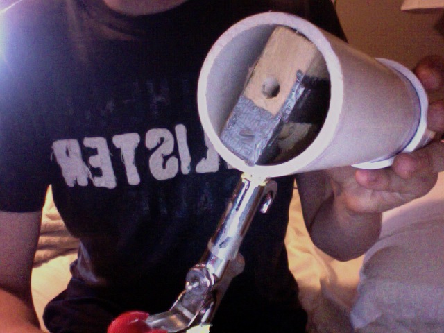

the above pic is my first attempt to add a photo that went succesfully and also is my first idea to reduce the rpm of the gun, would this actually help? it seems to me that decreasing the volume of the loading chamber would decrease rpm, maybe lol

I think that if making the chamber smaller would do anything it would be raise the rof because pressure would build up quicker between each shot...

hmmmm really? is there any design aspect other than this that'll slow down the rof? and are you talking about the hole in the vortex block specifically or the chamber as a whole? is it something that you've experimented with for optimization, and i could just do the opposite?

I'd suggest a 3/4 to 1" hole for the vortex. You can try smaller if you want but I think a detent would slow the rate of fire much more efficiently, and give you more power.
I think a detent will slow down ROF, especially if the popping pressure of the detent is close to the pressure of your air source. If you go that route, you could use a smaller valve orifice on the input to the vortex block. Those two changes would slow up ROF, but hopefully not just having you spraying air...

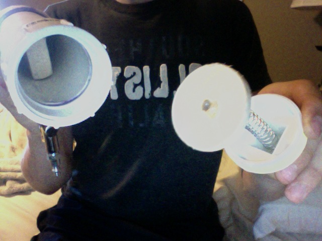

and one other question, what's a good spring to use for the plunger? have left over airsoft springs but those seem to powerful compared to the ones i've seen use

Try to find a weaker one... Too strong a spring will jam the vortex block.

hmmm well i think i'll just deal with the high rate of fire lol, but i made a super ghetto model with duct tape end caps and a wooden block with cardboard shield over the the hole, used a one inch hole and i just stuck a 3/8in brass nipple fitting into the bottom and drilled a hole just big enough for airsoft bbs which were the first things i saw laying around to shoot i got one good burst out of at 20psi with an ultra ghetto 2- 2liter bottle back pack air tank shot at least 100 bbs in like 4 seconds lol, couldnt get it to work after that, i think it blew to duct tape away from the vortex block and then the air just escaped out the hole in the duct tape, not through the vortex block, any way i'll try to post a pic above, but how do you post pics in like a comment?

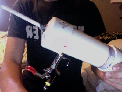

hey alrite got parts to actually make the thing, didn't even need to glue it, im still using a wooden vortex block, i tried working with acrylic (now my least favorite stuff to work with) but gave up cuz it just cracks, i bought an air compressor too, finally
i've been having fun with that but i just put my little ghetto version together with a pen body as a barrel and the old spring that was too strong, it worked... well it just worked it would spray short bursts maybe 2 seconds long then i'd have to shake it too feed more, wondering what the problem is, is it a crappy vortex block? or is it just my spring that doesn't really work quite right?
im running the thing at 105psi for like 2 seconds because my compressor only has a 1 gal tank on it (getting 5 gal for it soon) but at that pressure with a pen body thats like 6inches long the bbs go pretty darn fast and at 75psi-ish it put some pretty nasty dents in a pop can from like 35ft away,
any help with little things you guys have figured out after working with these things would be great to know lol

A weaker spring would probably help with the feeding. Also, typically, less ghetto=better working gun lol so yeah a good vortex block might also help.
