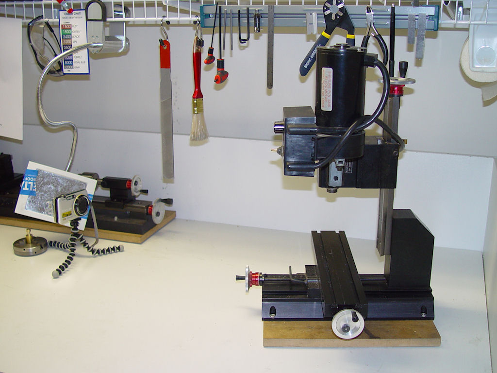

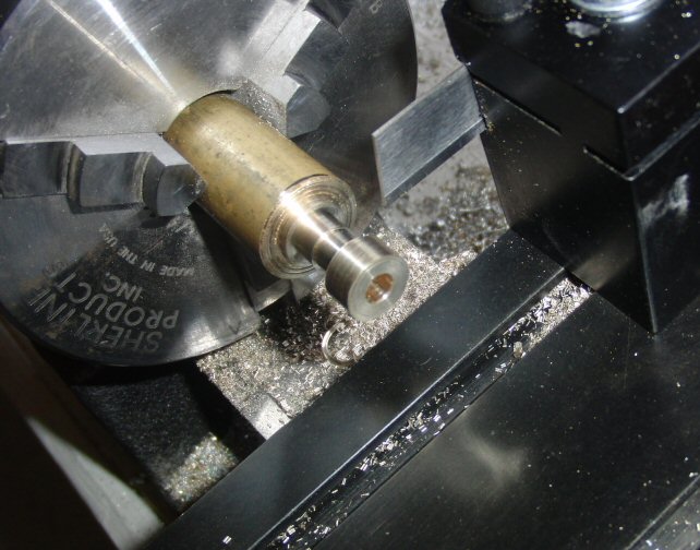

Damn... took me forever to find the correct setup to be able to film the mill...
The piece is done, and I will try to finish the movie for tomorrow early afternoon... in the meantime... here's a little teaser :D
[edit] Silly YouTube 15mn limit! The movie is too big to describe both the lathe and mill operations...
So I'll split it in two. If everything goes well while I sleep first part will be finished uploaded when I wake up :D
To be forgiven for being so slow, here's a production still ;-)

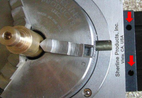

Clarification, what's the correct way to mount the table to the cross-slide?
Here it's done with brackets:
... but logic tells me it should be bolted directly though the holes provided:
LeMaudit
Posts: 665
Sun Jul 03, 2011 7:50 am
Both are correct, but yes, both holes can be used. You don't need 4 locking points, 3 are enough (remove one one the rounded side).
Be careful not to use screws too long for the holes or you will beump the T slot's internal (guess how I know that).
I HAZ A BANG!
Sun Jul 03, 2011 7:55 am
LeMaudit wrote:Both are correct, but yes, both holes can be used. You don't need 4 locking points, 3 are enough (remove one one the rounded side).
Two bolts are provided, aren't they sufficient?
