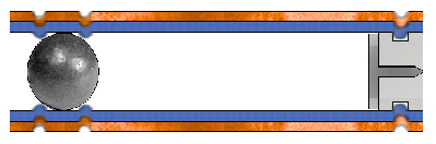

Um, it looks like that one won't seal... Gas can get from behind the burst disk to the gap between the projectile and cartridge, then on to the atmosphere provided that the projectile doesn't seal perfectly.
Of course, with a 'rubbery' burst disk it will seal, but as-is gas can escape without ever encountering an O ring...

argh you're right... damn... I need more coffee :shock:

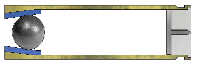

I thought through a possible design, quite similar to a regular firearm round. I'm not sure how it would work as the reloading of the individual shells might be an issue. If you manufactured several of these shells and varied the thickness of the cone tip on the end, you could fill them up to pressure and possibly store them "loaded." Just thread in the cartridge and fire. You'd probably have to make a reloading jig from a vise and a steel block with a conical hole though.
As to the fuel and air mix, the syringe idea, except with a sort of pump. Make a large volume mix and use the pump to pressurize the cartridge with that mix.
The light gray around the projectile is the seal. It's rather difficult to see sadly.

That is essentially what JSR has already constructed. The problem is in creating a cartridge that seals reliably, releases the projectile at the right pressure, and doesn't rapidly degrade when used.

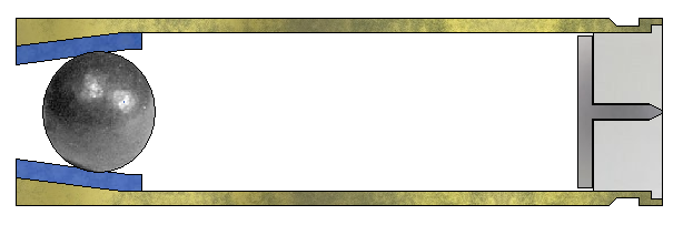

We could replace the theaded section and o-ring with a length of silicone tubing forced in a cone
:shock: How weird... here's what I had in mind during the night :lol:
Using a length of copper tubing, a length of silcon tubing fitting inside, and some crimping to keep everything together.
In term of "mass" production it would be ideal.
The operation would be:
- Put the tubing in the lathe, ball side on the jaw
- crimp the lefter groove (a bit less deep than the other two)
- insert the ball
- crimp the other groove to keep the ball in place
- insert the plug (with a little groove in the middle)
- crimp at the groove position
- separate at exact length with the blade

Alright, here's with two pieces of tubing inside, and a little crimping at the end to be sure the plug stays in place

Interesting thoughts. I wouldn't recommend that setup for the base plug, I have a feeling it would blow out.
