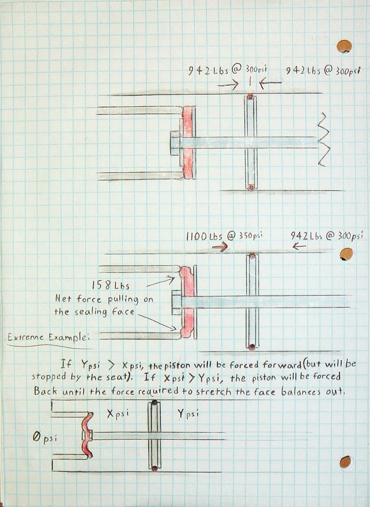

I did some brainstorming and I think I figured out your low opening pressure problem. Ok, I guarantee I figured it out*

As you can see, when a sealing face is not secured to the rest of the piston completely, the face and piston will not move together in a uniform way. It will move long before the valve actually "opens", which in your case will cause it to dump the pilot volume.
Below is a quick approximation of your valve and what it will most likely do upon firing. There are a couple solutions to this, but the easiest is just to glue the face down.

Unfortunately, my sealing face is epoxied to the washer behind it and I just went up to the garage to double check the epoxy hasn't come unstuck. The sealing face is quite secure and except for a chunk of epoxy 2mm x 2mm that has been removed, the epoxy isn't cracked.
Interesting solution though, not one I would've thought of.

Ok, that should mostly rule out the flexing issues, but it still could be the seal on the pilot instead. You may eventually want to replace your current pilot with a QDV-ish design. A couple washers, orings and a short length of copper pipe with porting holes drilled in the side would work fine.

Okay, I'm back with some numbers.
Pilot charged to 260PSI, dropped to 255PSI over 5 minutes, didn't drop any further.
Pilot charged to 260PSI, chamber charged to 40PSI, pilot dropped to 255PSI over 5 minutes once again.
Pilot charged to 110PSI, chamber pumped slowly up to 145PSI before the piston opened prematurely. There was a slight leak out the barrel port (roughly 1PSI/minute) and I monitored the pilot pressure while the chamber was being pumped up; there was no change or fluctuation in pilot pressure until the piston opened.
Back in November when I filmed the cannon up at my friends bach, on one occasion the piston opened prematurely at around 130PSI with 220PSI in the pilot.
Even if there was a problem with the sealing face, I can't think of why that would open the valve.
