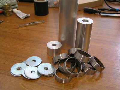

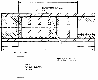

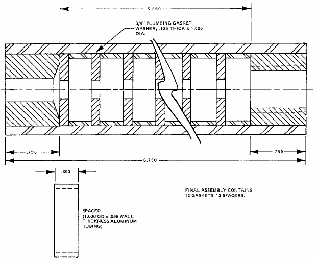

pic below of the basic design. Mine is different but the same basic principal. Aluminium pipe, washers and some aluminium rod. Not too hard. The difference being that mine is longer and has 10 sets of washers. I'm using 1.5" outer (1/8" thick) with 1.25" inner bits.
Once done, i'm going to polish it up so it looks the part.
The bit that is going over the barrel itself is 3" long to make sure it's nice and stable. The end plug is 4/5"
The design picture comes from a pdf that i found in 'the usual places' called 'The silencer cookbook'
There are more in depth designs but for something this small and only air powered, i cant see that the better designs would be needed.

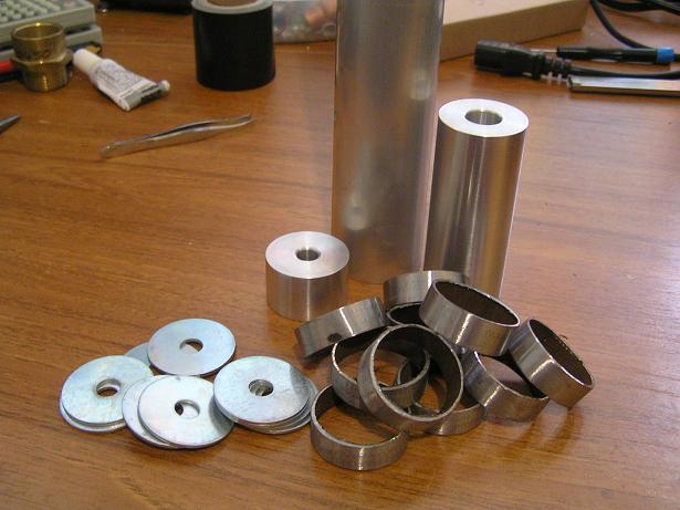

Status of silencer pic below...
Just have to assemble it now. Shouldn't take long but it'll have to wait till a bit later in the day, other things to do....
Silencer parts
Silencer parts

Hmm, well i've got mixed emotions on the silencer. It works well to quieten it down but by no means makes it silent (not that i expected it to). It also appears to reduce the power of it by a reasonable amount. i.e. i'm now getting a consistently low shot by about 25cm at 15m so it's reducing the power quite a bit.
It could just be percieved lower power tho - The weight of the silencer may be flexing the barrel - i don't think it is but it's a possibility.
There may be some other options to make it flow a little better but still retain the silencing effect but i'll have to investigate. I may be able to reduce the amount of washers in it but keep the length or just reduce the whole lot. It does seem a little weird that this is supposed to work really well for a .22 but it's not doing so well with the bb.

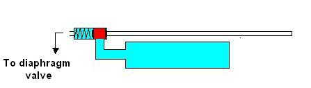

Hey just wondering about your design, I still can't figure out how it works... I've attached a simple sketch, anything like it? The red is the piston, blue is the pressurized areas. (The air leaks around the piston as in a normal piston based cannon)... It's got me puzzled... :?

Jolly Roger wrote:Hey just wondering about your design, I still can't figure out how it works... I've attached a simple sketch, anything like it? The red is the piston, blue is the pressurized areas. (The air leaks around the piston as in a normal piston based cannon)... It's got me puzzled... :?
Yes, it's identical to that. No spring however, it's just free moving.
In my original design, i just had exactly that - a 'T' piece went to a schrader valve, the other to an exhaust valve.
The multiple valve setup just simplifies this charge/discharge procedure.

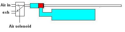

Basically, air is permanently charging the chamber. When i hit the button on the blue valve, it pneumatically activates the solenoid on the other (big) valve. This then switches the 'chamber' air to exhaust through the blue/white/black thing (it's a mini silencer), throwing the piston back (as would normally happen.
This has some real advantages. There is no need to be fast on the trigger, as soon as almost any air hits the solenoid, it activates and does so very rapidly. Also you get the added bonus of not having to constantly recharge or even worry about leaks. It does however make it a little risky when it comes to disconnecting from the air source as it will fire. What i ideally need is a schrader/check valve on the air 'in' so that it will not fire if for example the air line came off or burst.
To explain better, adding to your diagram...
