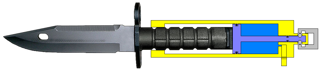

here's a brain fart, a "valveless" launcher that could fire an unmodified knife with an appropriately shaped handle silently...
a more "conventional" coaxial version with a thumb trigger

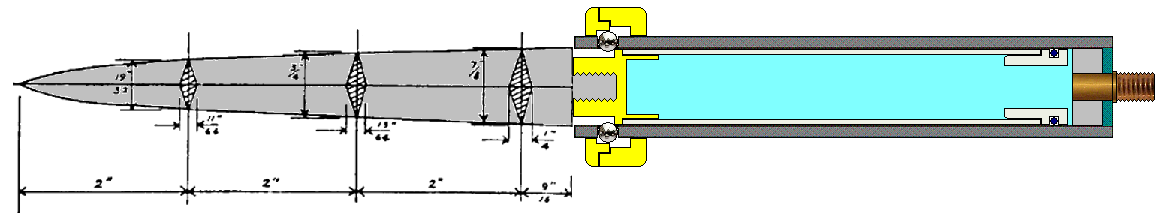

Hmmm... That shape isn't very appealing though.
How about something like this?
Remember this is travelling head first, unlike a normal throwing knife.

That looks that it could take some beat, and looks like easier to make :D
