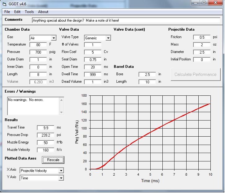

Tue Sep 06, 2011 9:20 pm
2.5" x 10" tennis ball barrel
1" x 8" chamber
2oz tennis ball with a CD of about .6
Valve:
valve type - generic
# of valves - 1
Flow Coef. - 5
Seat Diam - 0.75 in
Open Time - 20 ms
Dwell Time - 999 ms
Dead Vol - 1 in3
Can I get screenshots at 200, 300, and 700 psi?

For Lockednloaded. IDK how tight they are in the barrel so I just left it at 0.5
Lockednloaded
Posts: 1566
Location: Texas, USA
Wed Sep 07, 2011 9:52 pm
Thanks a bunch,
well its a very tight barrel, but those numbers look very low compared to what im actually seeing... I'm getting a 6s hangtime when i fire straight up at about 300psi

Thu Sep 08, 2011 12:00 am
With a higher valve CV, and chamber size, you should be able to get a much longer hang time. The shot below was launched at just under 100 PSI. A 2 inch chamber will hold 4X the air of the 1 inch chamber. A 2 inch valve can be fitted to the 2 inch chamber for a higher valve CV.
