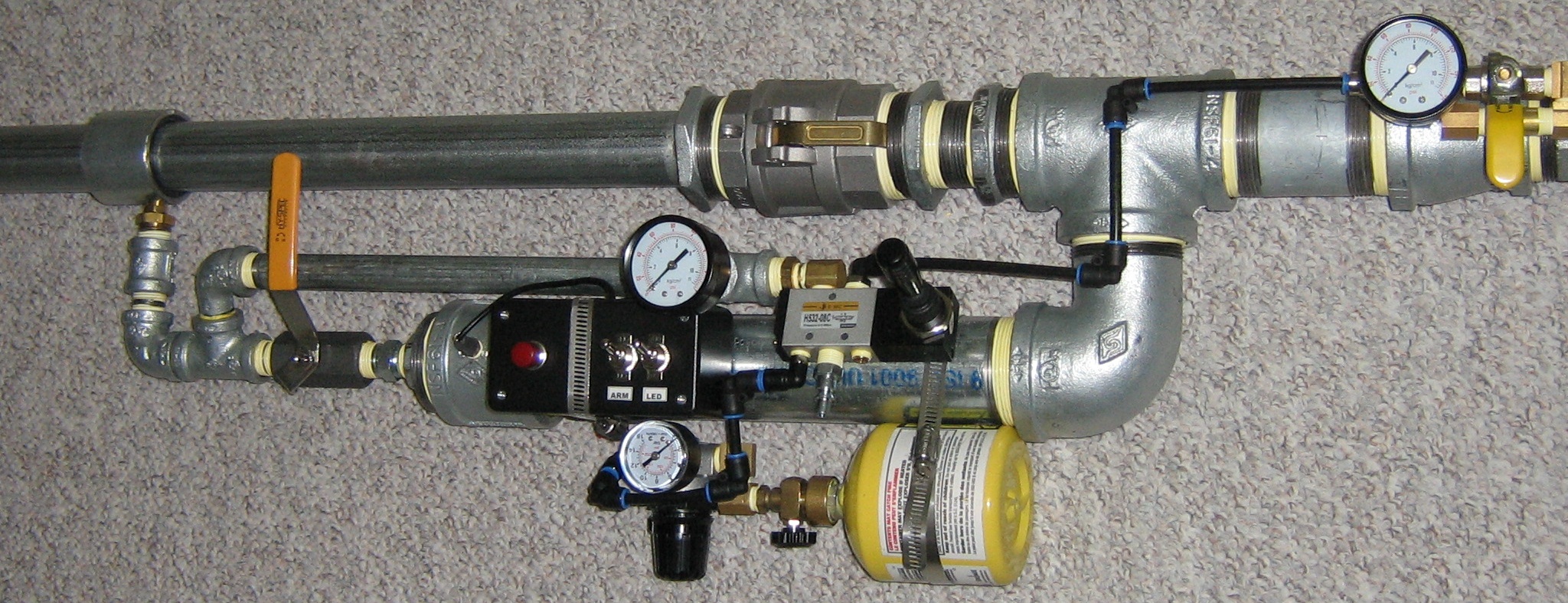

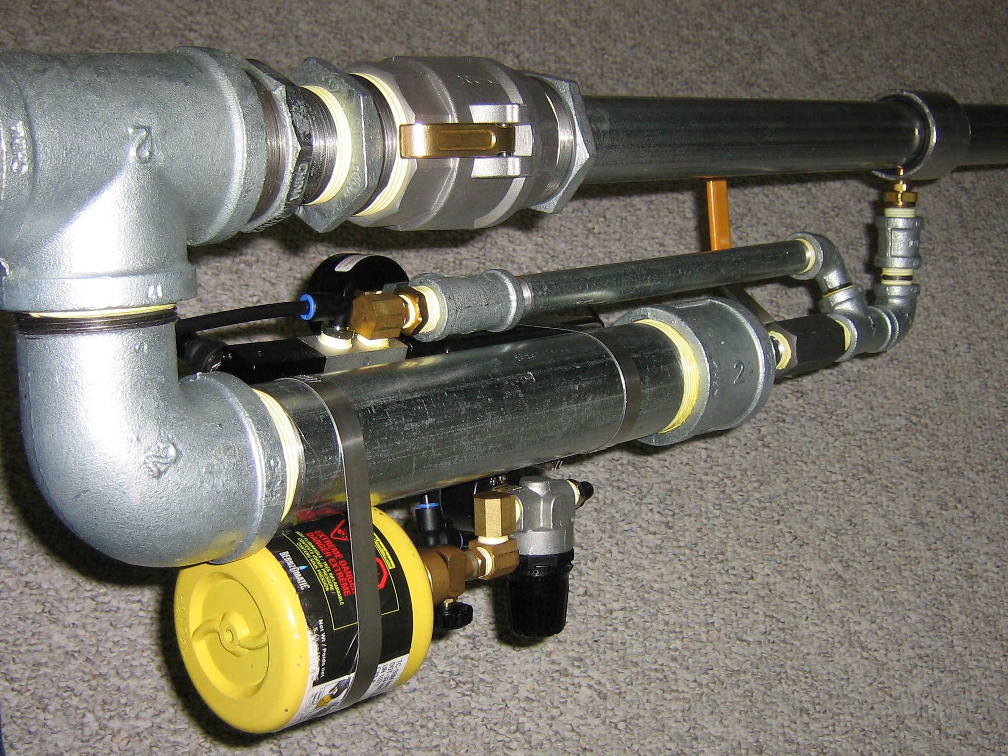

Recently, I decided to rebuild the TBMA-230, which had been sitting in storage for nearly a year. The primary objectives were to compact the launcher for transport purposes, improve the fueling system, and solve the piston and chamber vent valve failure issues. All of these areas have been addressed in V2.0.

Fueling and filling operations are managed by a lever action 5 way 3 position directional control valve (5/3 DCV):
Pilot setup:

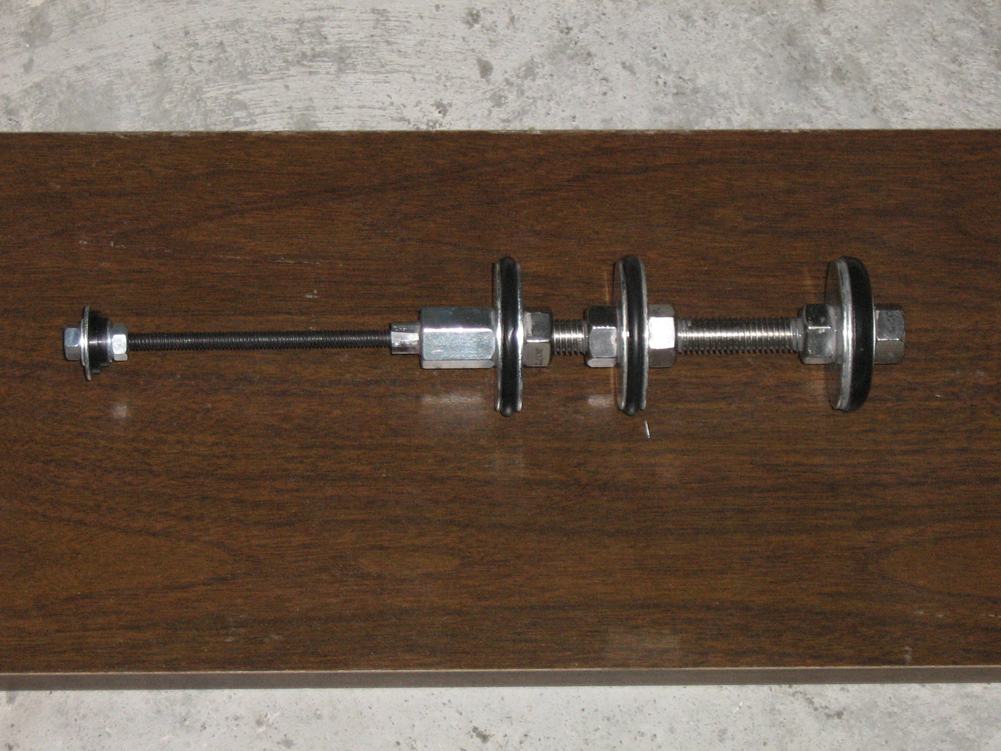

The piston now uses 1/2" UNC 304 stainless steel threaded rod, which improves corrosion and bending resistance. Travel distance is ~1.5", with a calculated opening time of ~6ms at 5X.

Piston bounce or sealing issues?SpudBlaster15 wrote:and solve the piston and chamber vent valve failure issues
You actually hip fire this thing or do you rest the elbow against your shoulder? Unless you fire lefty, looks like there's a lot of stuff in the way that would hit up against you with recoil
I've always loved the sleek pilot setup, now even more nice looking.
