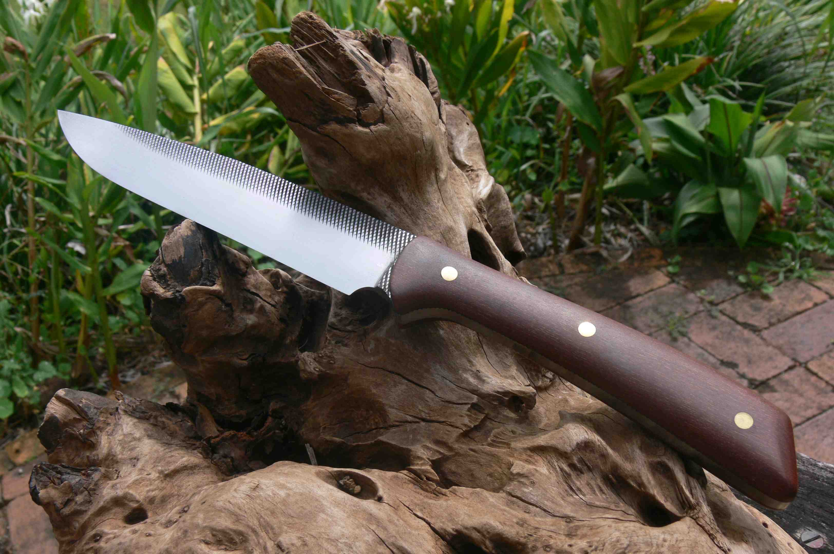

ilovefire
Posts: 511
Sat Mar 03, 2012 8:39 pm
hey, just thought i would post the outcome, could be sharper but its pretty good
