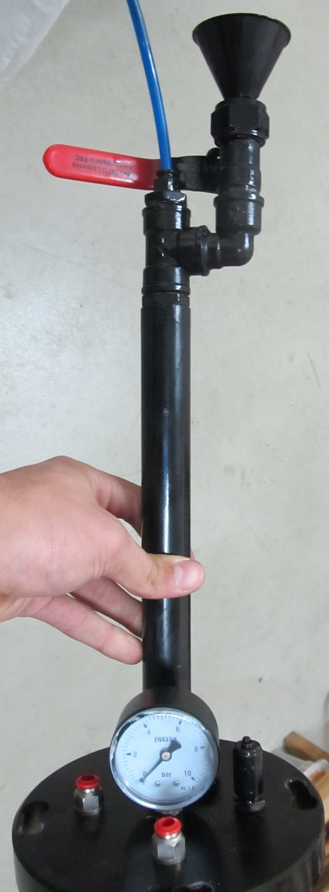

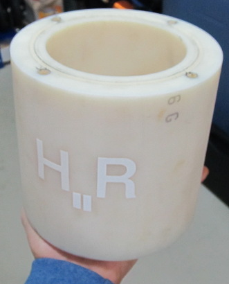

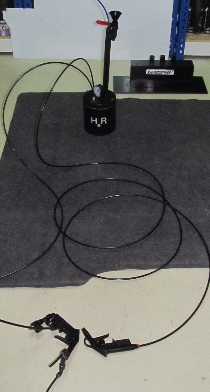

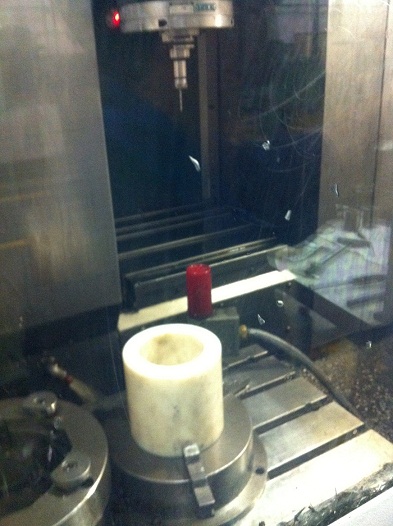

Hi everyone

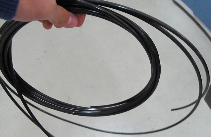

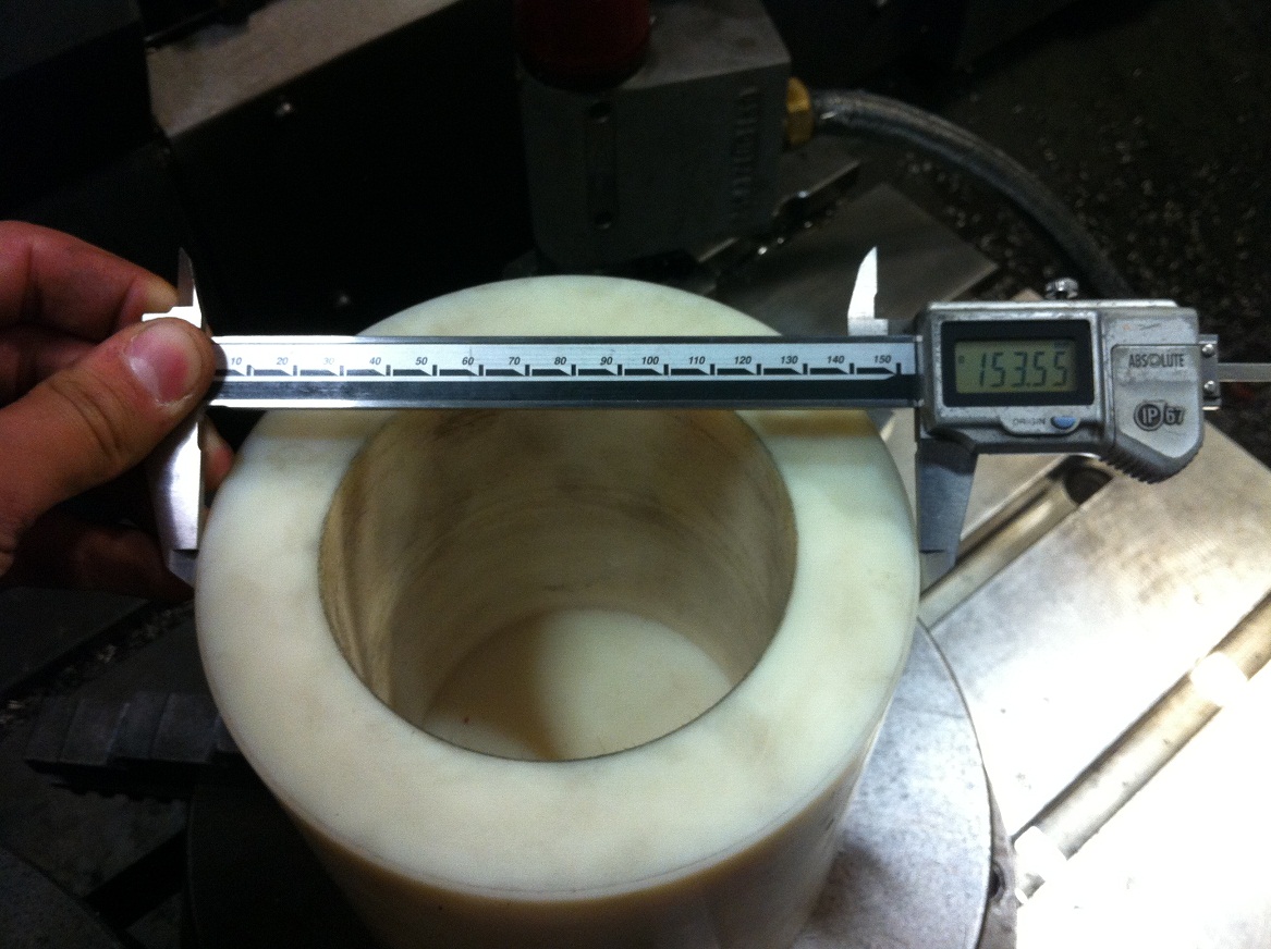

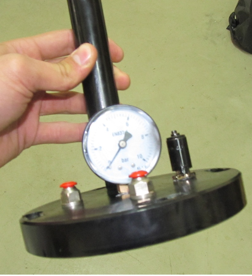

The reactor is made of Nylon 1FR4 and all the pipes are these dimensions/ material: 4milimiters inside and six outside diameter and are made of high pressure plastic, they stand at least 6/8 bars....
The reactor as all of you Know has a safety valve and I have also put in a valve,(pistol one) that i have with me while the reaction is active, to reduce the pressure inside the H2Reactor, it reaches 4 bars, today I have filled a ballon with H2 and did a fire test, with a remote ignition system i have done and shown in the following picture, i had used Zn instead of Al because Zn is more reactive so it produces the final product really fast, the ZnCl2 didn´t react with the nylon as I first thought to do and the H2R also has a Pressurized Injection System (PIS) designed by me that consists in not only the use of gravity force to put the HCL in the H2R, it is a chamber, PVC chamber to not react with the HCL, and it has another valve,(pistol one) in my hand that is connected with my compressor, at 4bars, and it injects all the HCL (0.5L), inside the H2R.(I have used an electrolysis but it was to slow... and with my scrubber on H2R it is now a better option to follow.
(I´m going to load the H2R pictures)
In the RIS, I- BLB (burn laser box), the ignition;
II- bearing that allows the thread which brings the ballon of H2 that has less density than the air and rises high, touch the laser beam to explode(this was done already);
III-The electric motor that rolls the wire to pull the balloon to the ignition.

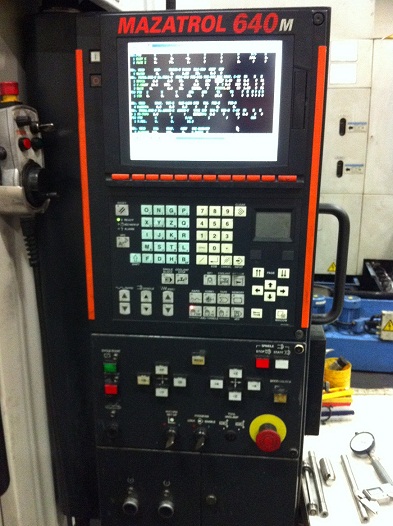

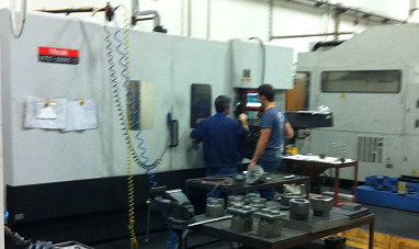

The reactor was done in a CNC.
RJB INDUSTRIES[/GVideo]
The Block
The Block
Measure
Measure
CNC program
CNC program

wyz2285
Austria
Posts: 2388
Location: Porto, Portugal
Wed Apr 11, 2012 10:49 am
How long does it take to produce enough hydrogen to power our hybrid? :D
Oh and one more thing, did a little research, nylon may not be a good material to deal with acid... If any body knows more about nylon+acid could help. I still think it´s better to do a anti-acid coating in the inside of the chamber, like fiber glass or epoxy, before further using.

Wed Apr 11, 2012 12:59 pm
There is no problem using acid inside the Nylon 1FR4 reactor, I guarantee you that I have done a long research before doing it, dont`t you think?
Now I have the pictures.
I will load them as soon as possible....

Wed Apr 11, 2012 4:22 pm

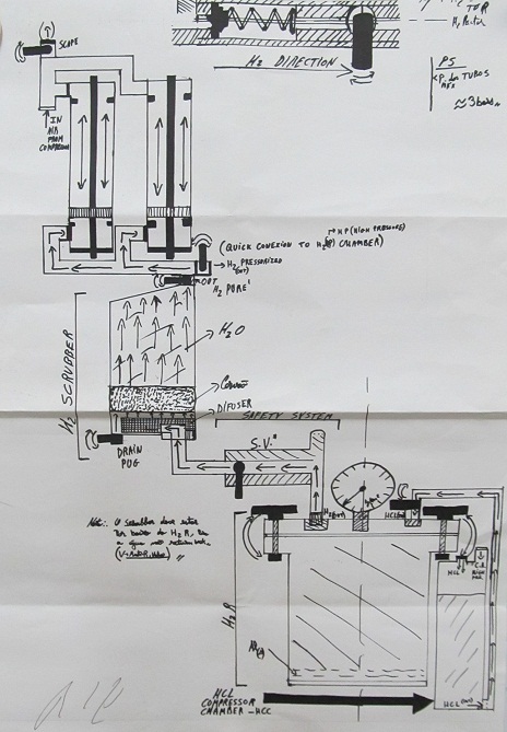

The pictures....
RJB INDUSTRIES
The Project in paper

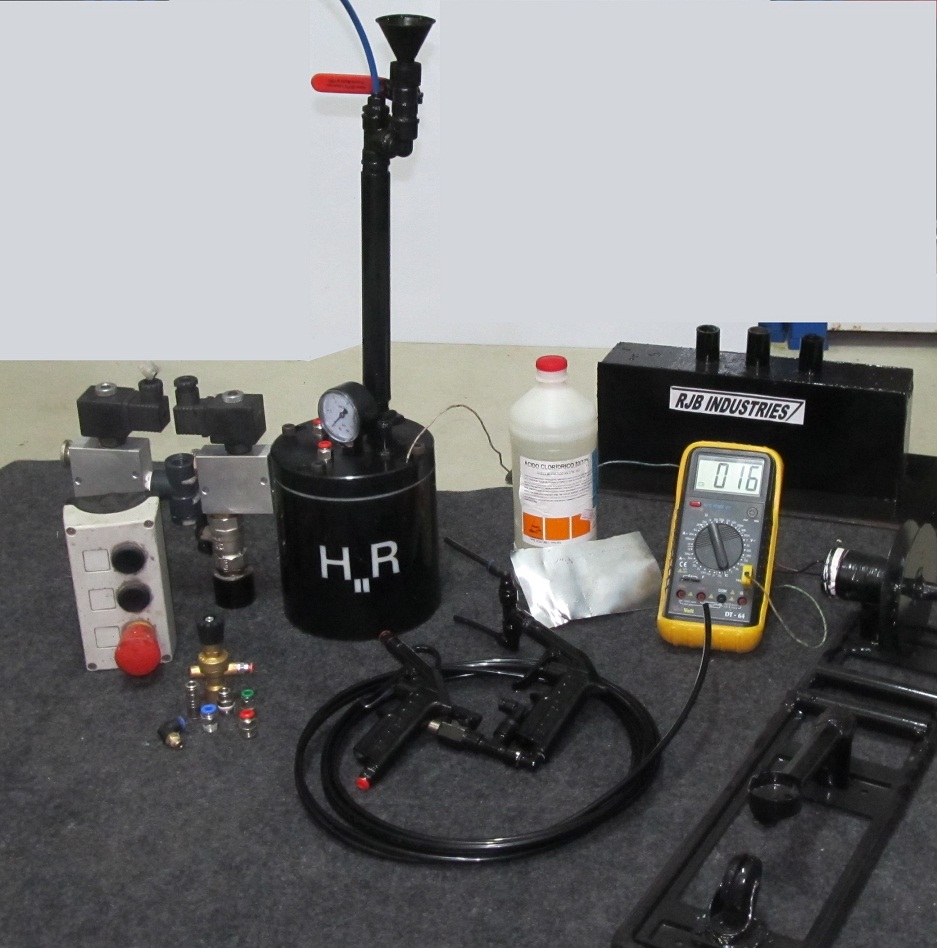

Reagents
Reagents
HCL and Zn.jpg (10.55 KiB) Viewed 4337 times
RJB INDUSTRIES EXPO
RJB INDUSTRIES EXPO

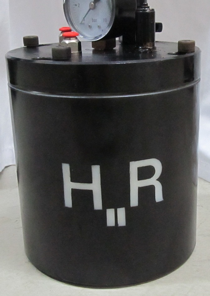

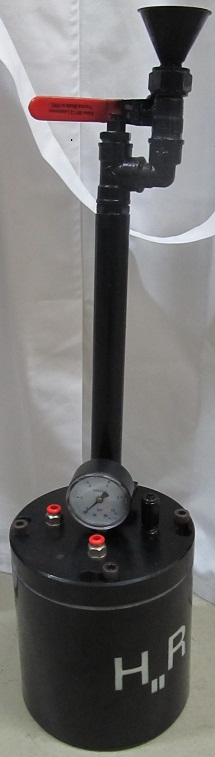

H2R
H2R
A global view of the H2R

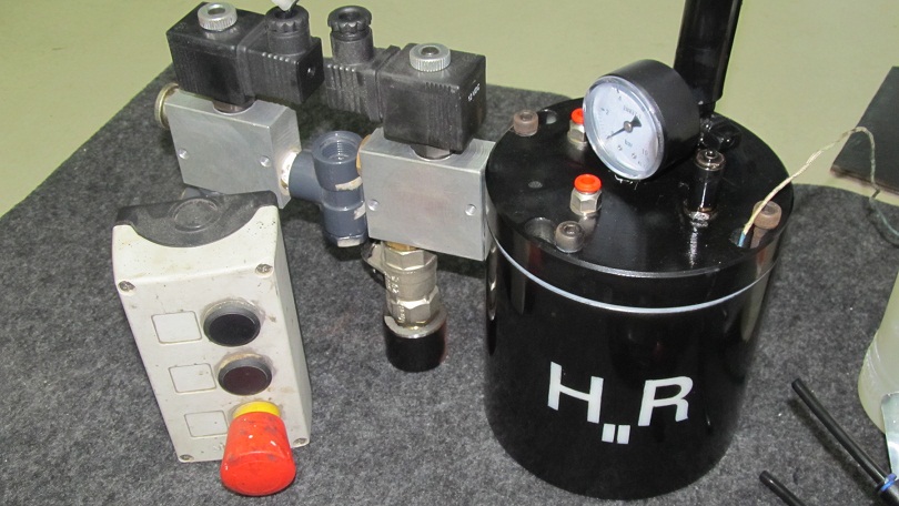

The electro valves to keep distance from the Reactor while working, and the remote control comand

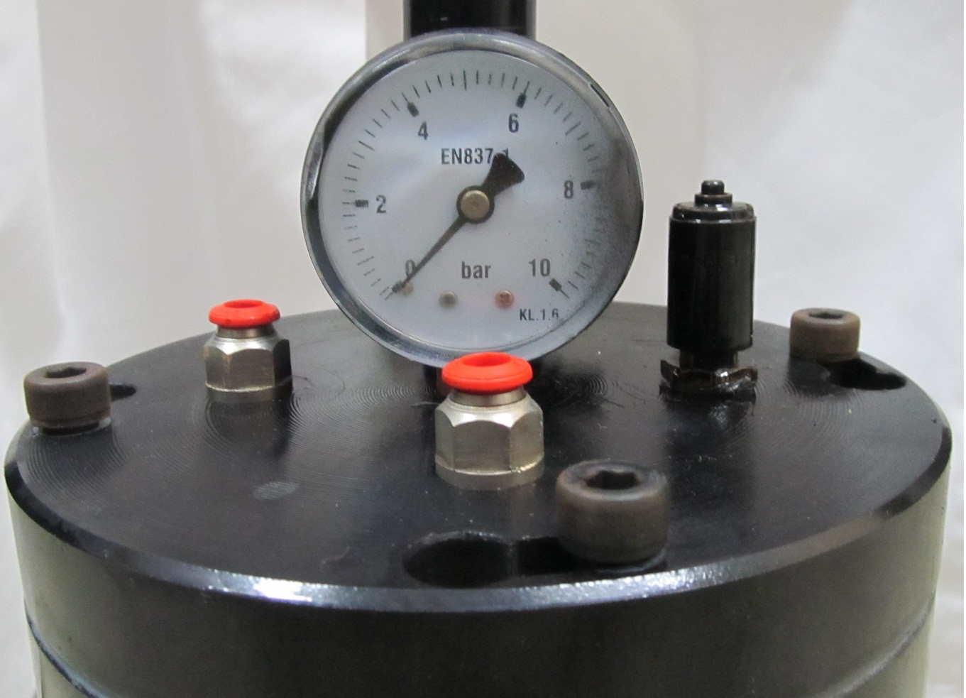

The pressure gauge and the safety valve
An easy and advanced system

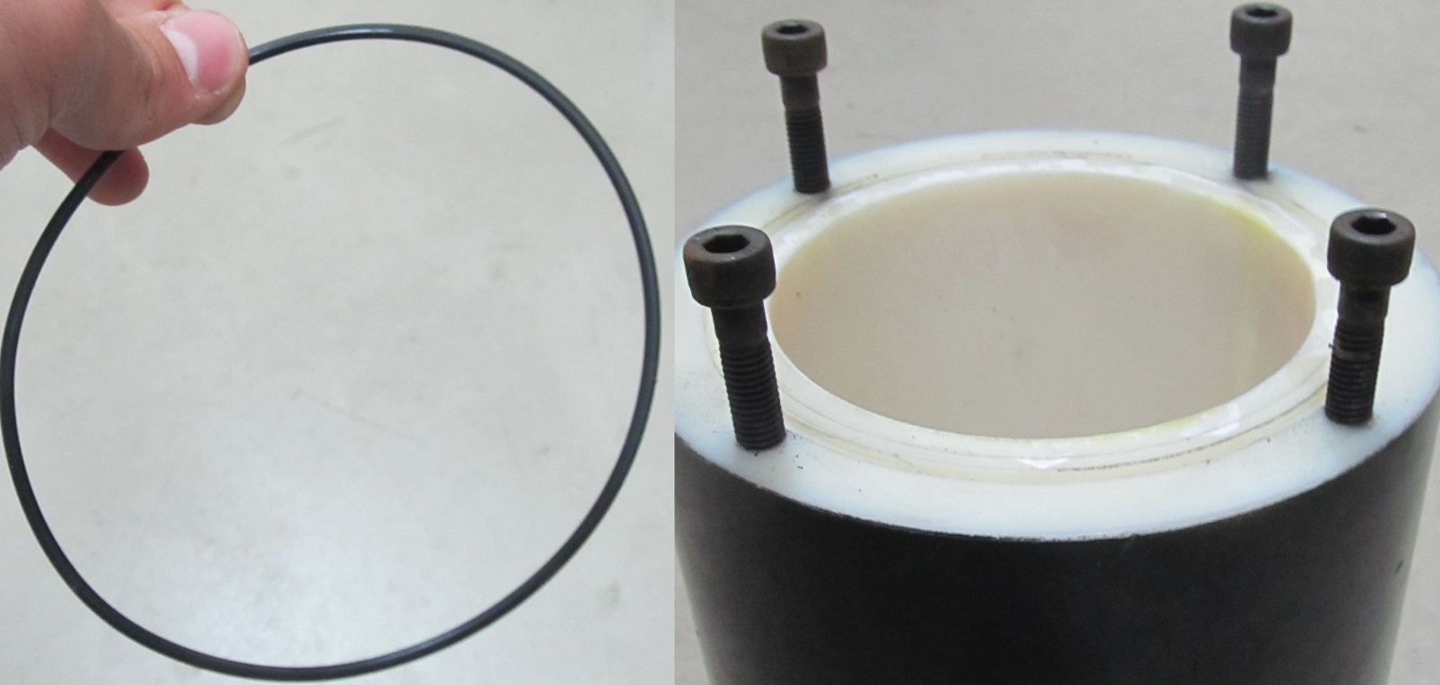

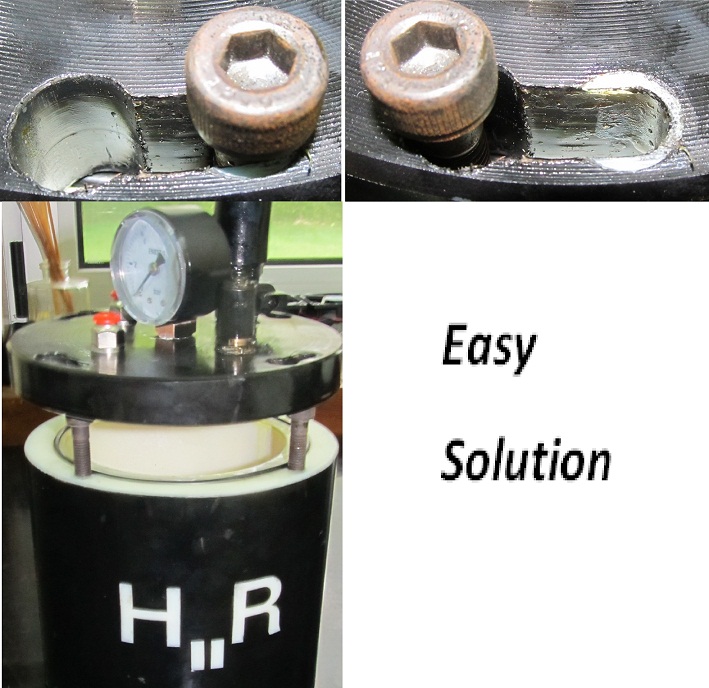

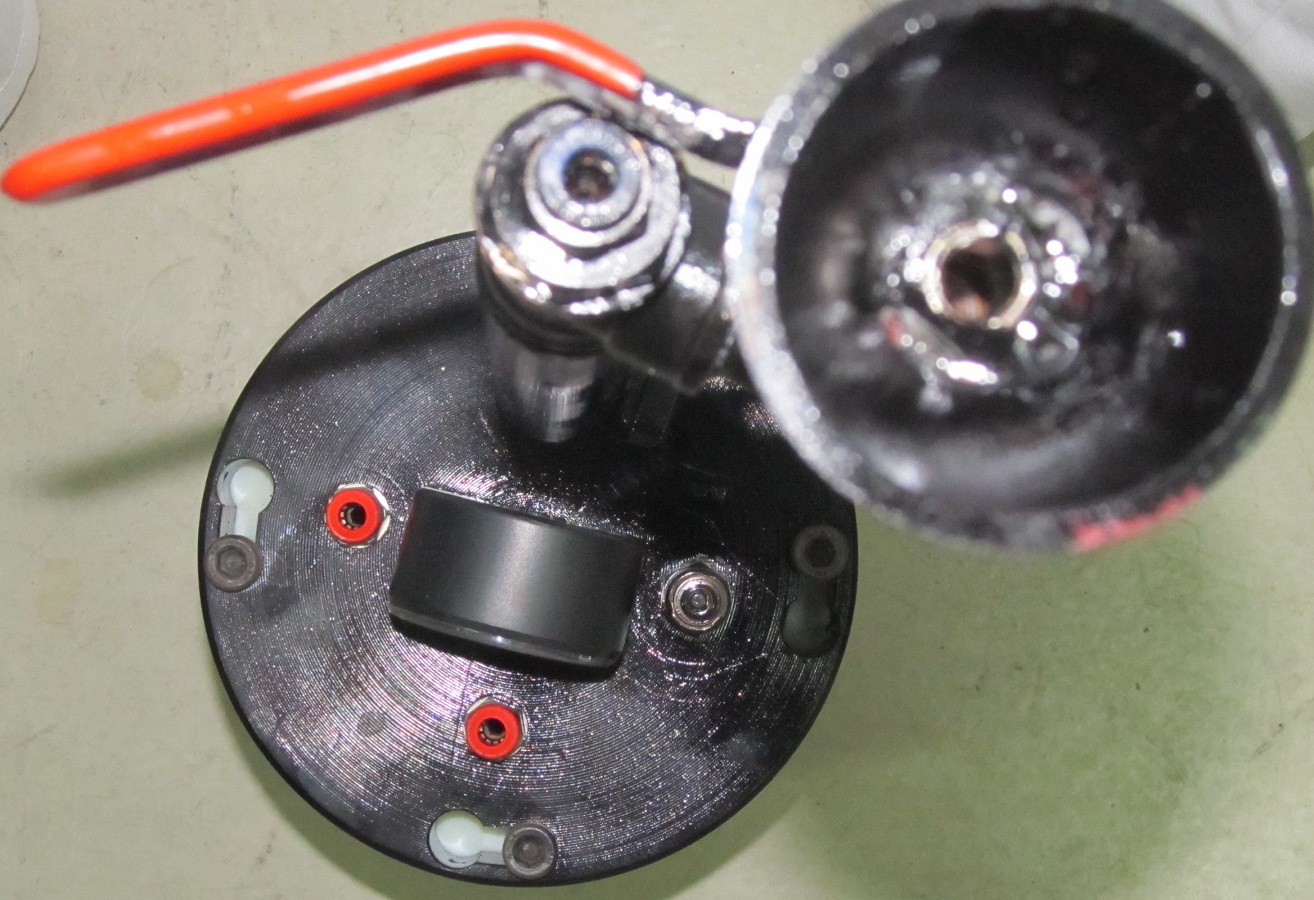

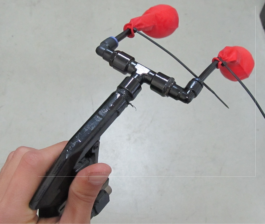

PIS
PIS
The Pistol Valve with the ballons, sample of H2 not purified yet.
The Pipes
The Pipes

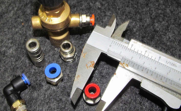

The Racors and The flowrate controller
Last edited by RJB INDUSTRIES on Sun Apr 15, 2012 12:17 pm, edited 1 time in total.

wow it looks exceptionally good, far better than I ever imagined, certainly the best homemade hydrogen reactor I have ever seen. Congratulations.
