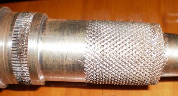

Are you making something or is this just a practice piece?Crna Legija wrote:I just did knurling yesterday at trade school. The first bit of the crosshatch one be was really crap even the teacher didn't know what was with it.
There can be a few reasons this happens. Bad knurling wheel axle, dirty knurling wheel, changed pressure or speed, tool became misaligned etc...
Did you use the same tool for all the knurling on this piece? Did you hear/feel any chattering?

just practice it started off as a 50mm round bar.jrrdw wrote:Are you making something or is this just a practice piece?
it was a brand new, knurling tool i un-boxed it, speed and pressure never changed. Maybe with the pressure it could have moved but wouldn't it have made the hole peace bad?There can be a few reasons this happens. Bad knurling wheel axle, dirty knurling wheel, changed pressure or speed, tool became misaligned etc...
yep keep on pushing in till i got the right depth then turned on a very slow feed rate.Did you use the same tool for all the knurling on this piece? Did you hear/feel any chattering?

Depends, if the wheel rubs the side of it's housing or has enough side pressure at first then centers it's self with rotation it could start off bad then get good.Maybe with the pressure it could have moved but wouldn't it have made the hole peace bad?
You should examine the tool next chance you get for scoring due to side load, slop in the wheel at any and all directions etc...
