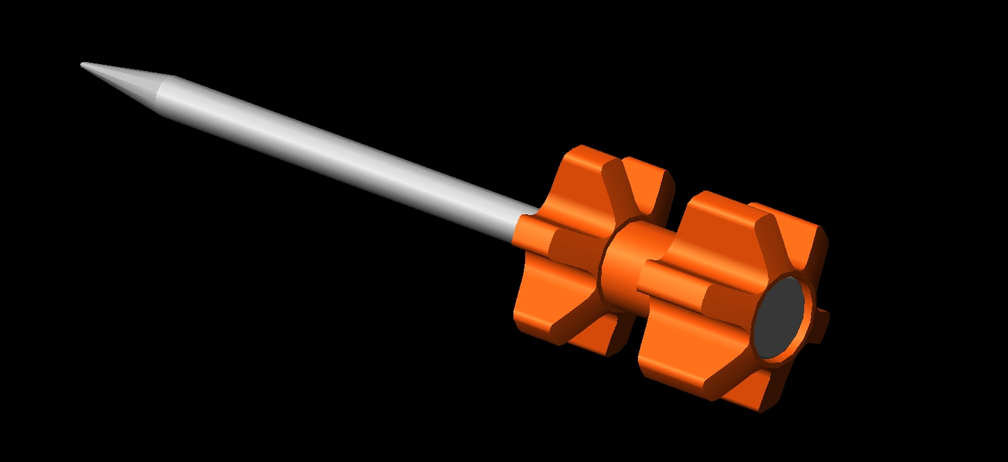

Hybrid ThorJack
Sat May 12, 2012 6:01 am

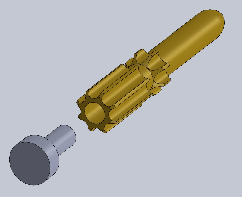

uhmm it seems that the tungsten rod is too long - the projectile's cg is probably going to be too close to cp
ohh BTW it looks like a dildo - seriously JSR - what was on your mind when you were designing it ?? :D
Sat May 12, 2012 6:24 am
POLAND_SPUD wrote:uhmm it seems that the tungsten rod is too long - the projectile's cg is probably going to be too close to cp
The current CG according to solidworks isn't that bad, though I do need to drill it out a bit further.
edit: pushed the rod forward 5mm, didn't make a huge difference but the CG is well ahead of the CP.
Does it? I think the mind that saw it as such is more troubled ;)

Sat May 12, 2012 8:10 am
It goes through anything! :D
ok for the delrin but it will put a disk as for the other sabot
very beautiful 3D !

Sat May 12, 2012 10:03 am
Actually, making the delrin part a separate sabot looks like a better idea after all...

delrin is free in the body and shall leave once out of the barrel
Sat May 12, 2012 10:38 am
Petitlu wrote:delrin is free in the body and shall leave once out of the barrel
Yes, it's had enough of being the junior partner in this projectile-sabot relationship and will storm off at the first opportunity :D
