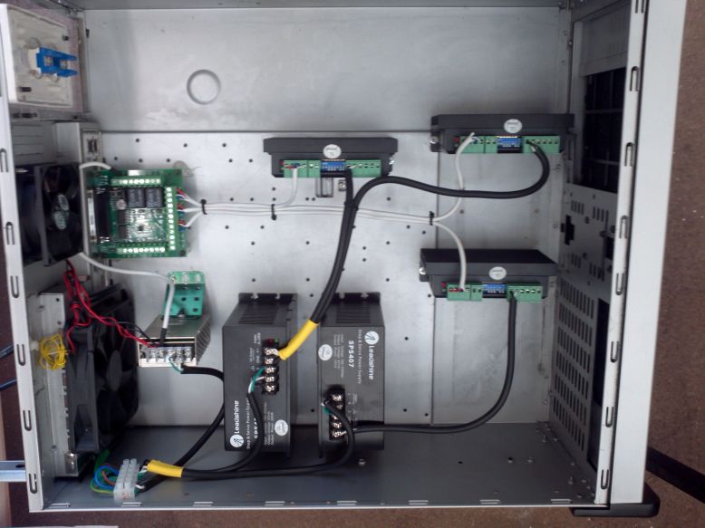

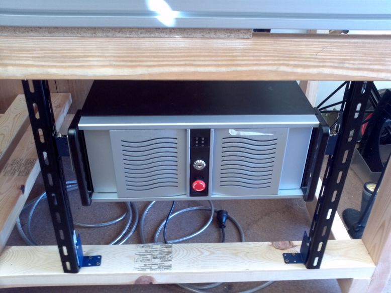

I was stripping some old gear at work for the dumpster and salvaged a 19" rack mount case. Perfect to house the electronics for this project.
See images below.

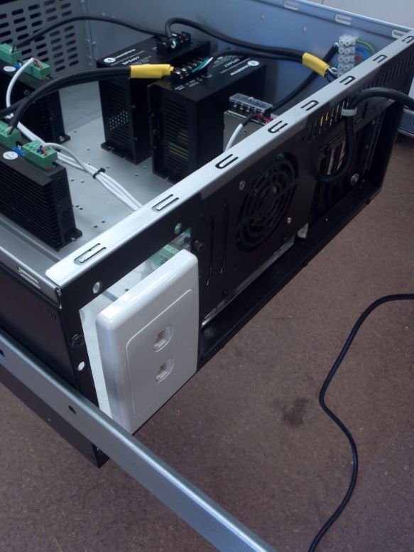

I am open to some suggestions for cables between the motors and the controller boards. I want to have them as plugable so i can easily pull out the electronics box for maintenance as needed. The motors are running at 42vDC at about 3A. I need a four conductor cable, preferably shielded. I have read a few posts on using DIN or MIDI cables but wonder if they will handle the current load.
Comments from someone with an electrical background ?
Thanks

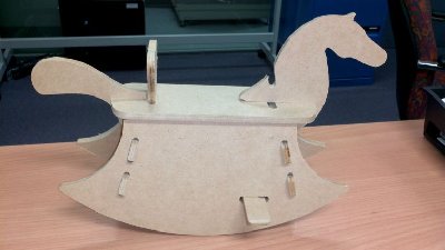

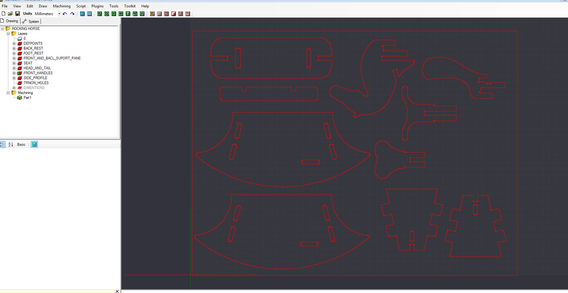

As an aside, if there is a member who would like to offer some ideas for some plastic or MDF fabrication then I would be happy to give them a go. Fifteen minutes of coding and fifteen minutes of machining last night gave me the attached result.
Imagine what I could do with plans for a stock or lower receiver for all you mil-sim fans. Right now I need ideas to practice my machining skill on, as long as it can be done as a series of 2D shapes then I can do it. I can also machine quasi 3D, (a ball can be made in two hemispheres) but for now I will stick to simple tasks.
No cost you to, I have the materials, just need the ideas.
