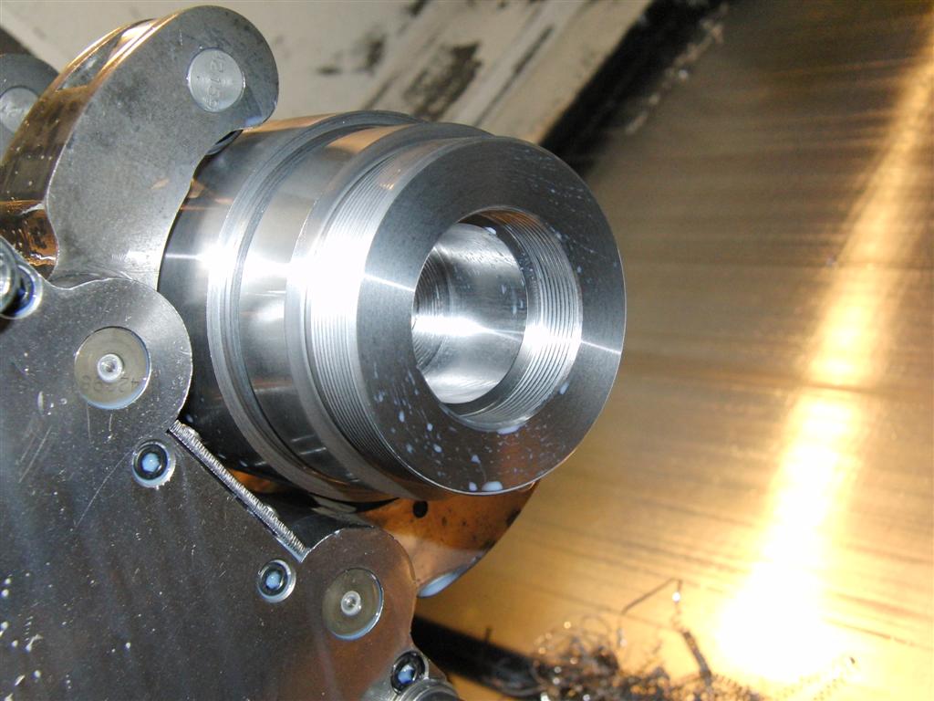

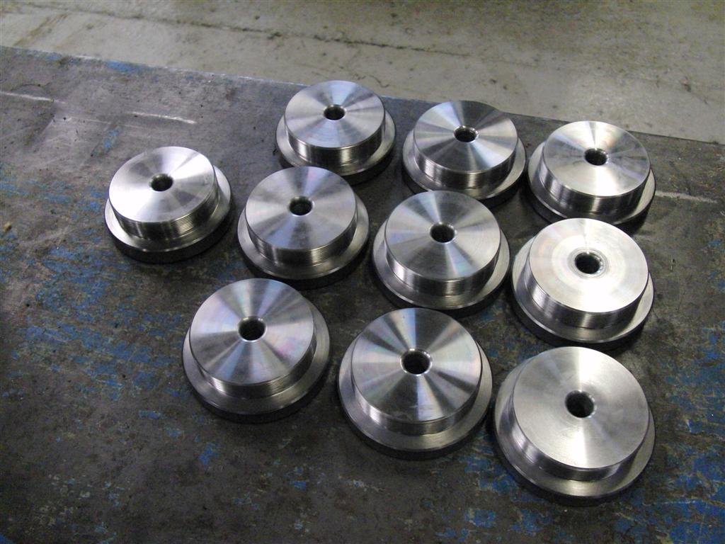

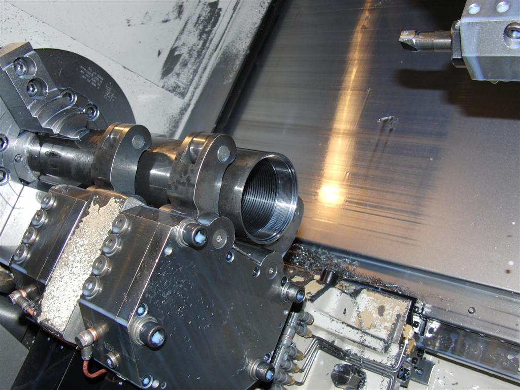

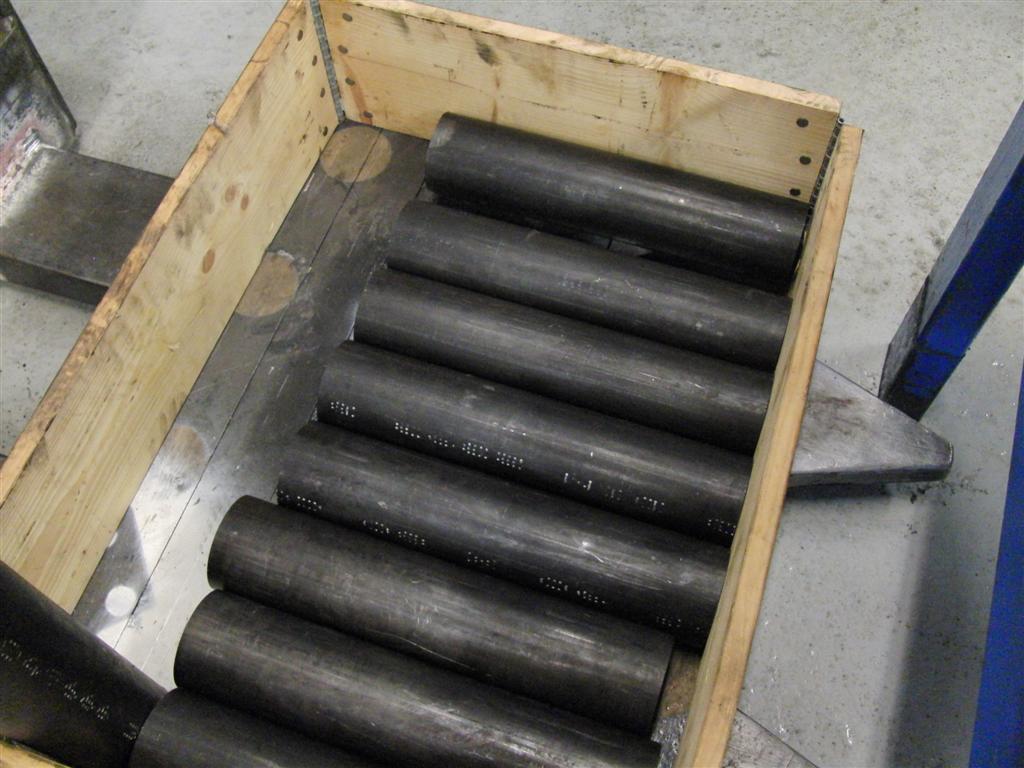

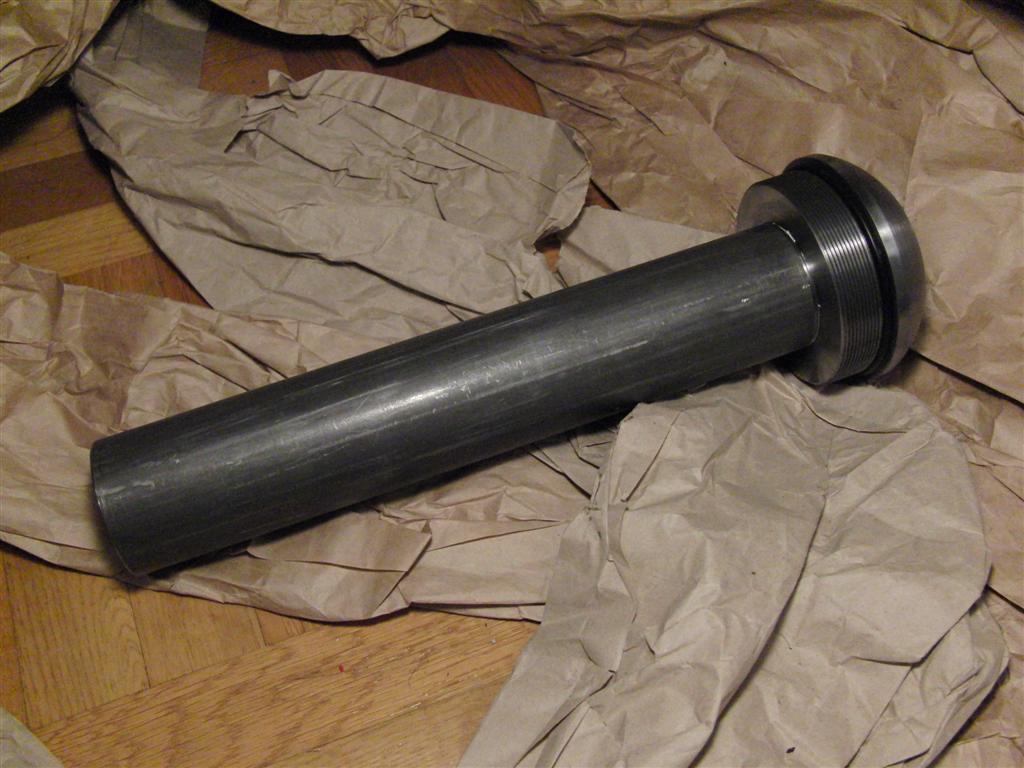

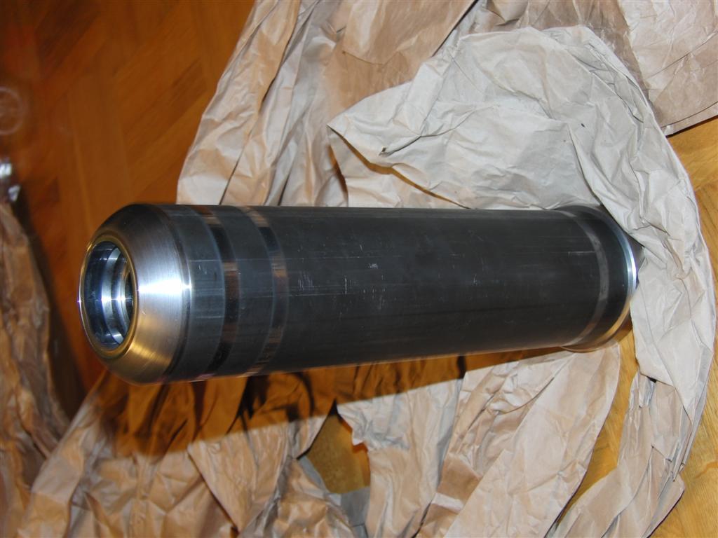

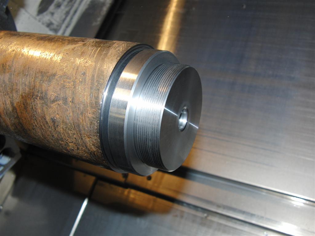

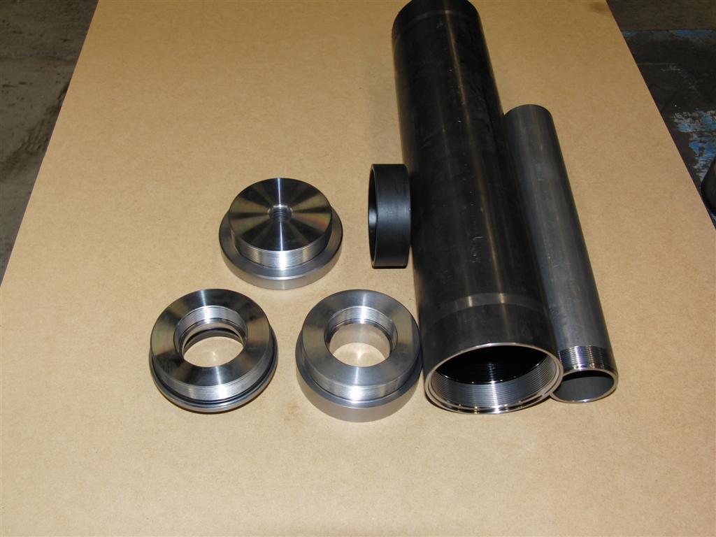

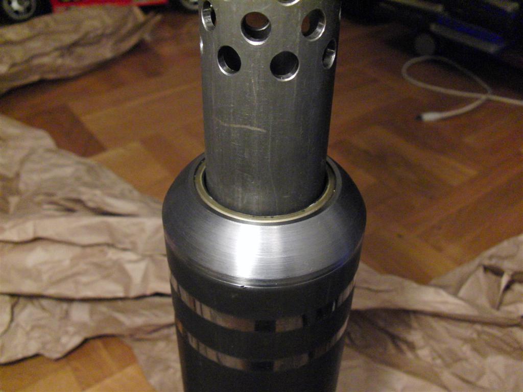

Last week i started a small summer project, a vehicle mounted airsoft gun.
A gun that you load with 90mm preloaded pneumatic cartridges.
Each cartridge consist of a 400mm long 90x5mm steel tube with threaded end caps, and a coaxial piston-valve that is piloted through a burstdisk.
The burstdisk is going to be punctured by a spring loaded, tube shaped firing pin.
Here is a few pictures during construction of the cartridges.
