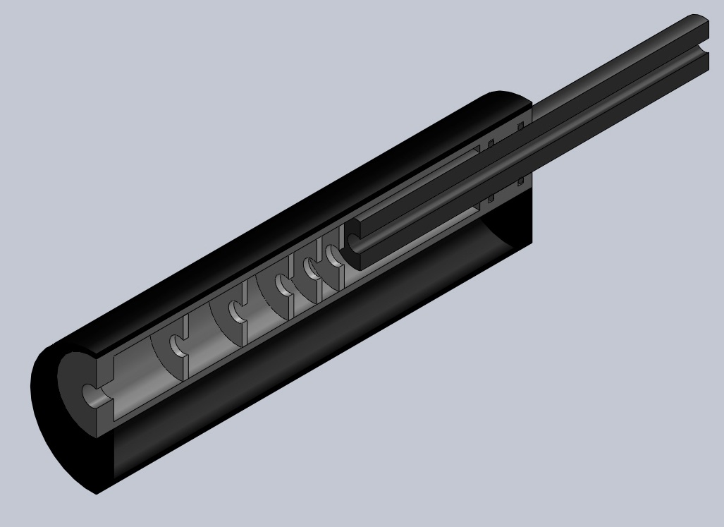

Here's a massive one I made for one of these in 9mm:
I made it similar to the Shinsung suppressors, but it slips over the existing shroud instead of being threaded and the first baffle area is perforated to allow air to expand into a large 70mm (around 2.75") diameter tube I slipped over. The eccentric design allows a large area without interfering with the scope line of sight.
3D rendering is the original idea, a little different from what I actually made.
