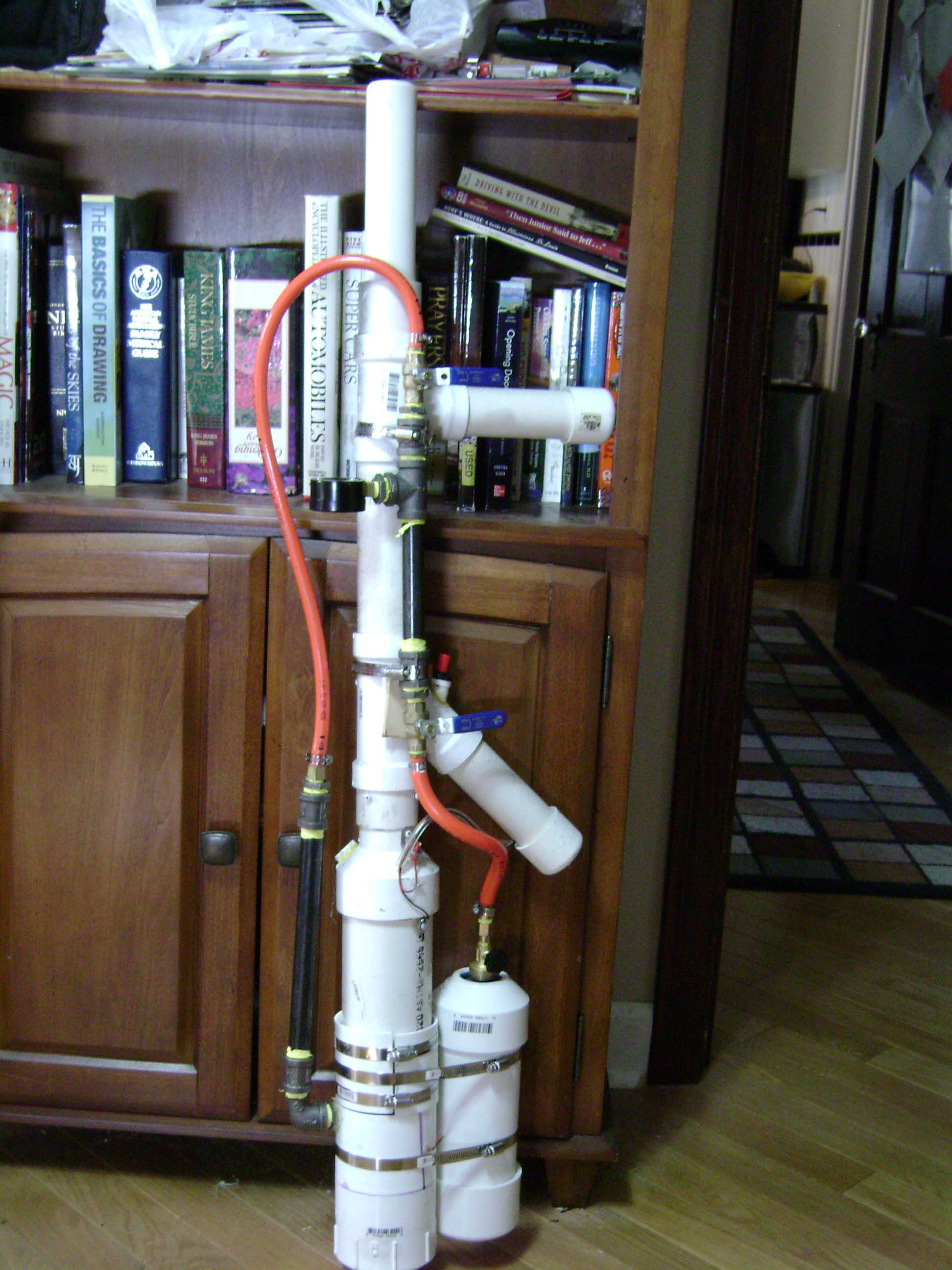

Hello, I am a new member to this site and I also built my first potato combustion cannon. I just got done building it today, but i can't get it to fire. The problem is that the propane is leaving the barrel, even when its loaded. I tried stuffing more down the barrel but that doesn't seem to help. It did however fire for the first test shot but after that it wouldn't fire at all. I have no clue what to do. Help would be very much appreciated! :)
Here's my cannon.
Here's my cannon.

What exactly do you mean by "leaving the barrel"? You can see the gas vapor floating out of the muzzle? Air out your chamber very well, unload it and look through the chamber and force clean air through it. Next check your spark. Can you see it? If so cap the chamber back off and try a dry fire. If it still doesn't work check your mixture and be sure to clear your chamber in between each test.

I think the problem it's that the meter pipe it's to far from chamber and most of the fuel are trapped inside that long house that connects the chamber/meter pipe, not well mixed inside the chamber.

It is a good idea to shorten your feed hose to your meter...
Post some close up pictures of your cannon and meter so we can better help you.

Some details of your fuelling procedure and chamber/meter dimensions and fill pressure would help. There is definitely too much pipe between the second ball valve and the chamber.
I would invert the bottle and use the metal pipe attached to the chamber as the meter.

Thanks! Here are the dimensions:
Chamber 3"x 15 9/16"
Meter 1/2"x 6"
I might of over done it with the pipe but i don't plan on taking it apart and working on it any time soon. That first test shot has kept my hopes high.
