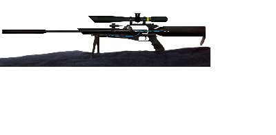

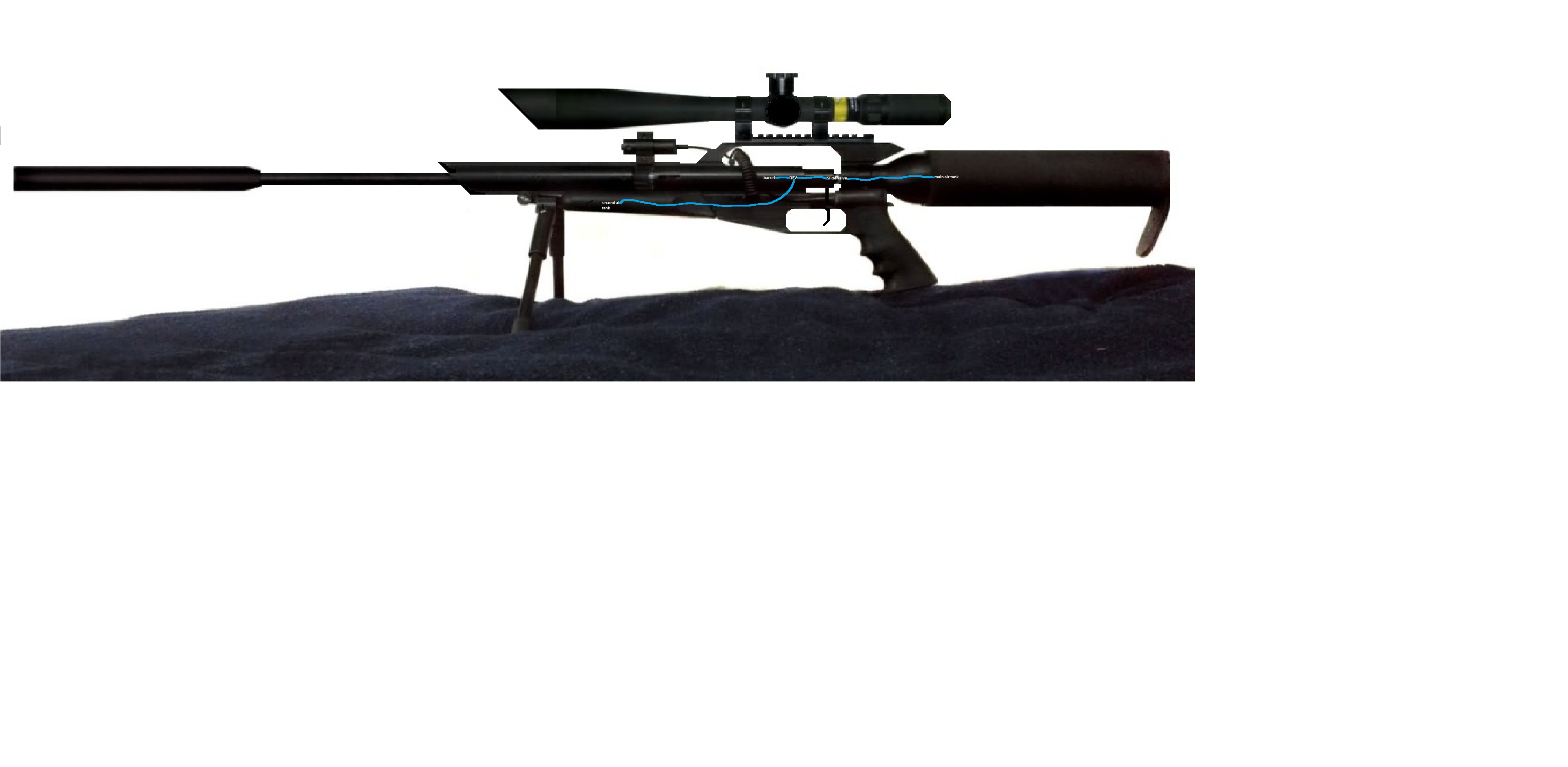

Hi guys, Im new here and i have a some questions about my design; Sorry if my english sucks(not main language)
Well so im going to use a Co2 12g as my source of air, im going to use a Co2 quick change adapter, The problem is that if i just use one valve, All of the co2 will be used in just one shot, What i mean is that if there is a way to use the same cartridge for several shots. What i had in mind was hooking the quick change adapter to a Air Spray gun and when you press the air gun, It pumps air to a reservoir chamber, and after that you open a valve which makes the air flow through the bolt
Is there a way for me to make a smaller version? Like i dont care if use the spary paint airgun but i dont want to make a the reservoir air chamber from PVC because it will need to be big for it to hold the air, Id rather make it from metal and make it long but short in diameter
Thanks in advance guys, I dont know if you understood my idea i hopefully can design something on Sketchup to post
