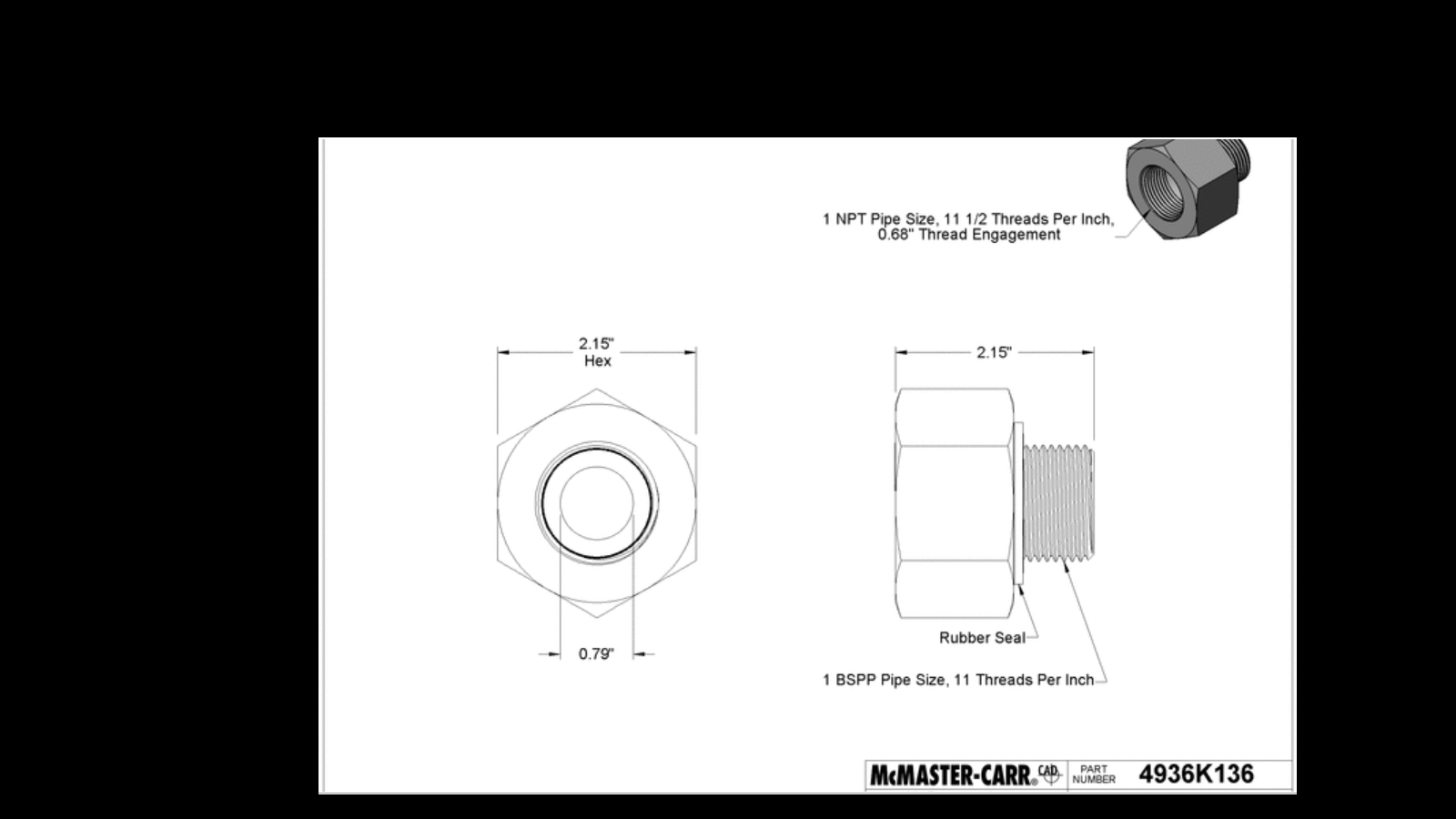

That's probably what I would go for.Tapping a 1" G plug maybe?
Here is the minmal machining method that is probably cheaper unless you already have a 3/4 NPT tap and correct drill size.
As jsr mentioned the tapped plug is better as can be seen in this picture.

Thanks for the pictures, Dewey!  I do have a 3/4" NPT tap but I'll need to find a 59/64" drill bit.
I'm concerned about making a centered hole using my whacky drill press. Would you advise drilling from the hollow end, or drilling from the closed end using progressively larger bits?
You could also use a 15/16" drill.PVC Arsenal 17 wrote:Thanks for the pictures, Dewey! I do have a 3/4" NPT tap but I'll need to find a 59/64" drill bit.
Get a a cheap Harbor Freight machinist (drill press) vise. Well worth it!
Center punch accurately on the flat of the hex side.
Start with 3/16" as a pilot and progressively enlarge. Use oil to keep drill bit cool and aid drilling.
