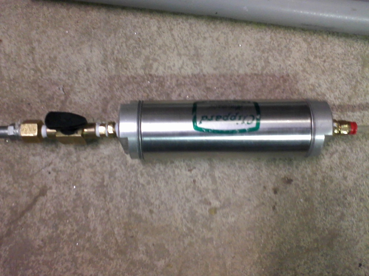

A bolt action gun, fully portable, operating at 120psi. My clippard tank is the biggest limitation, rated for 250psi, so I do not see a need to go too much higher. I have a DCV and QEV operating the pneumatic system. I am estimating 300fps.

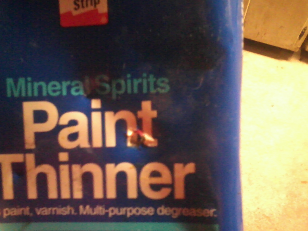

After some test shots at 20ft at an empty paint thinner can i caught ricochet and got a nasty welt, so this thing has some power. I attempted at sights and bi-pod for the first time and both are working somewhat.

Damage pics on a paint thinner can, ranging from 130psi to 120psi with 6mm air-soft pellets

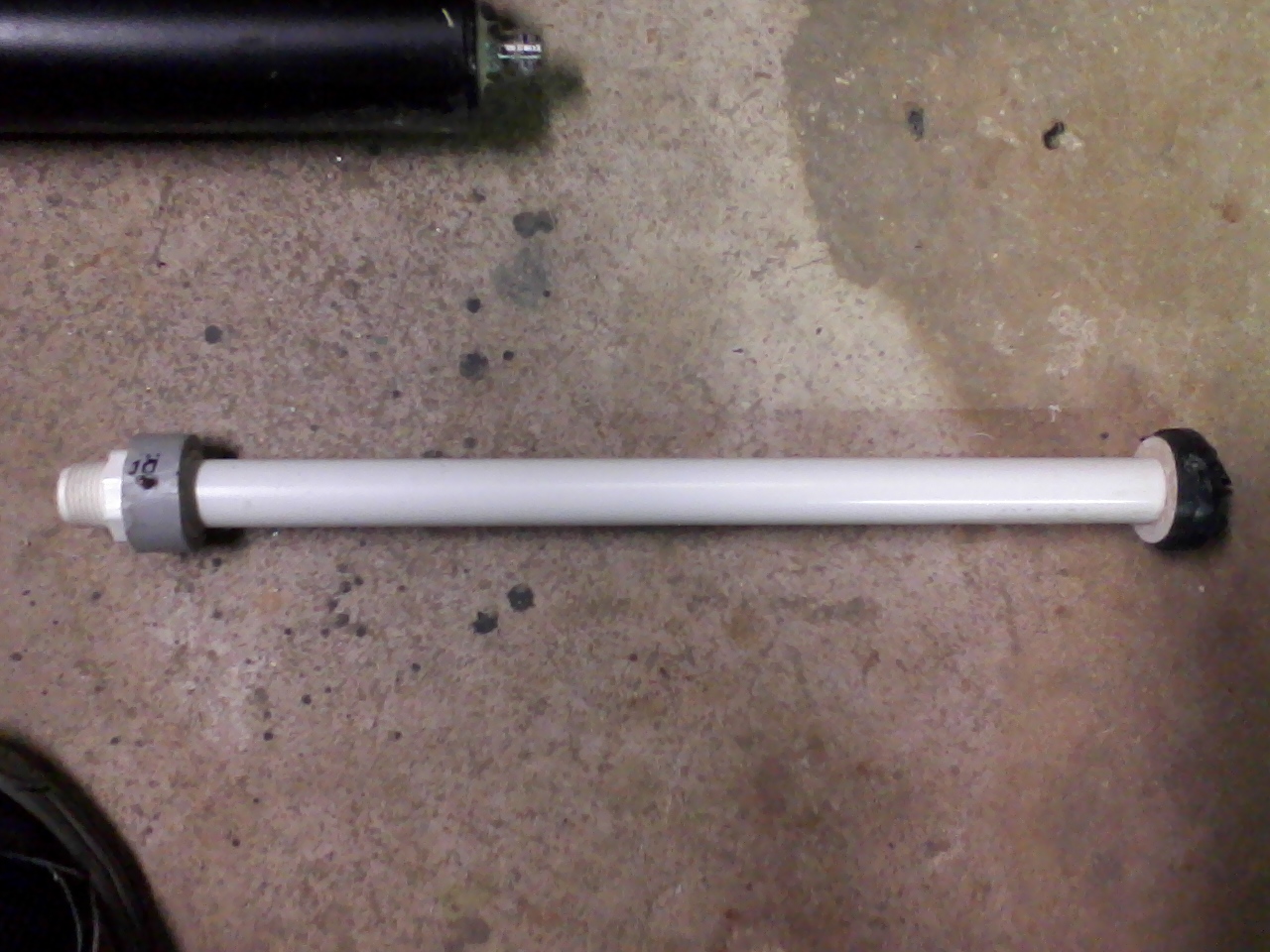

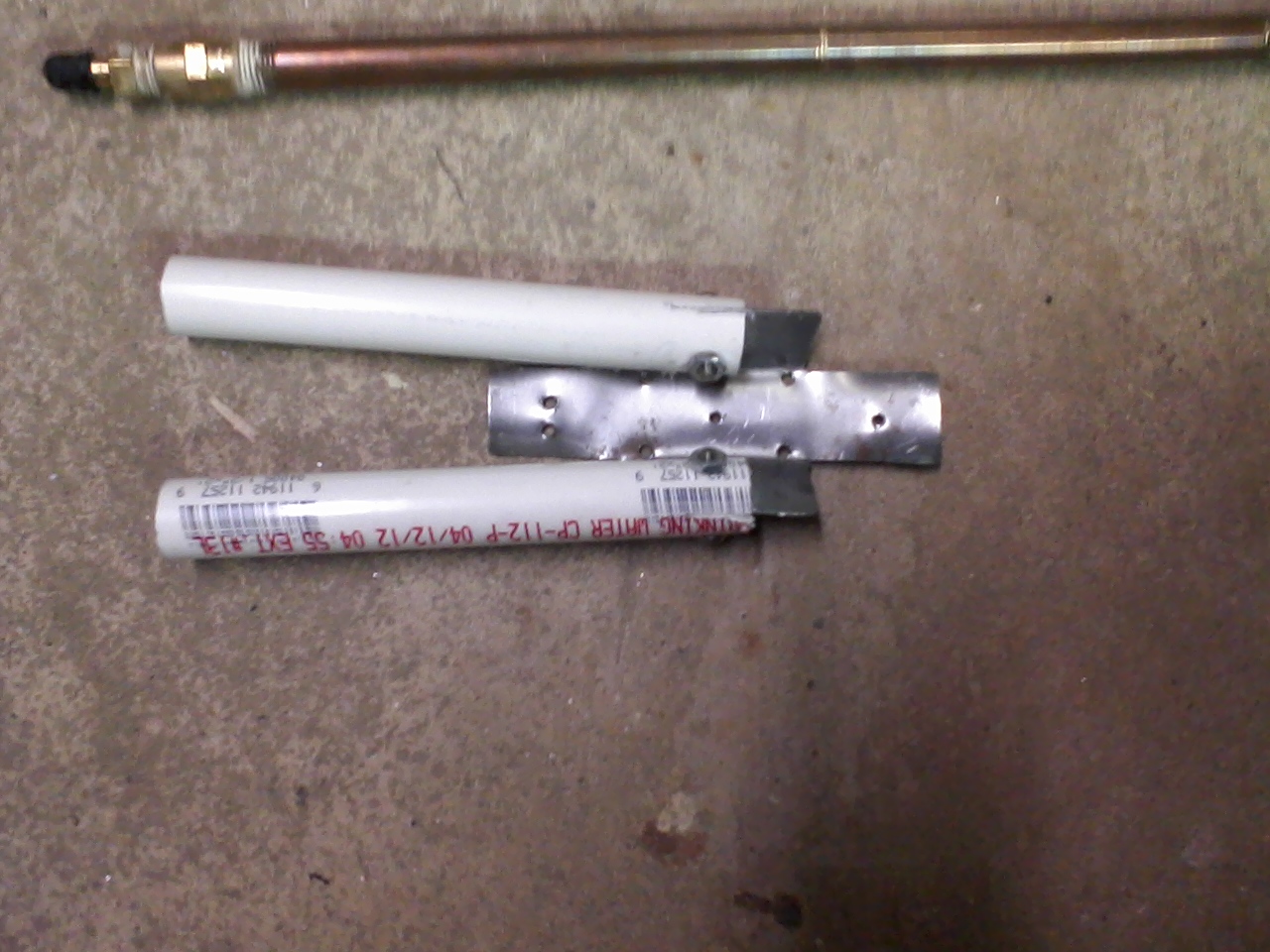

All the parts
All the parts
3ft, 6mm stainless steel tube used as barrel

barrel shroud
barrel shroud
toy silencer, was originally meant for looks (doesn't improve sound, but actually improves range)

secondary tank
secondary tank
main tank
main tank
screw on stock
screw on stock

It looks very familiar to me :lol: damage are not bad for the pressure, I got the same result when using similar pressure. Nice main chamber, what is it?

wyz2285 I'm using a clippard accumulator. We used them on our robots back in high school, this one is rated for 250psi. Thanks for the inspiration

Good stuff :D a simple magazine shouldn't be too hard to sort out, and a fridge compressor will turn those dents into holes ;)
