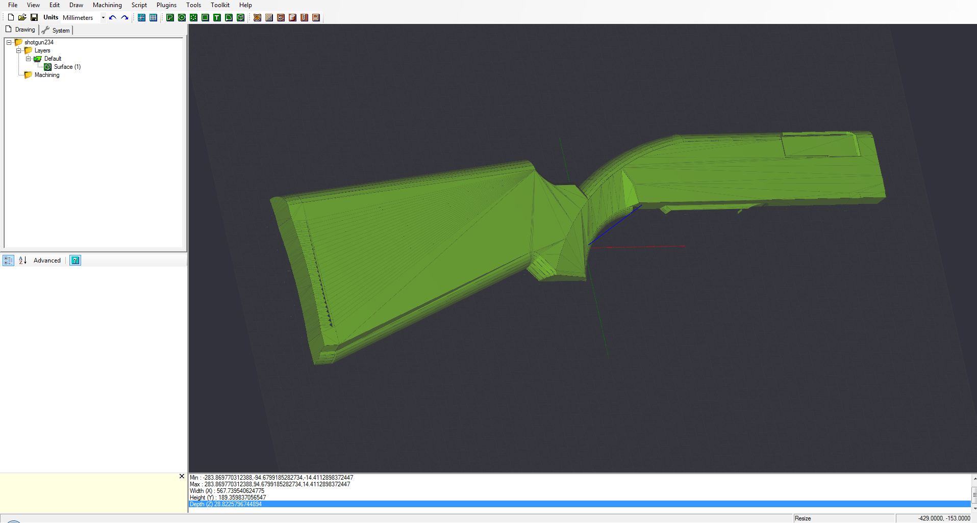

- HALO image from Sketchup
40 minutes of CAD/CAM

Right now i can do pretty much any regular solid, if it has a symmetric axis in at least one plane then all is good. i create the part as a 3D object then split it into two halves, after milling they are glued or screwed as shown into a complete unit.
The process is pretty straightforward.
Crude but effective.
My longer term plan is to add a fourth axis to the mill, then all is good.
- Create or acquire the object as an STL file
Load it into CAM and perform a series of X axis slices at the range of 1-2mm depending on the level of detail required
Delete all polylines below Z=0
Create MOP's to suit the remaining polylines
Copy and past the result and then do a Y axis transformation on the copy
Edit the Z axis points on the copy to create two "flat" 2.5D results
Machine then laminate

The main issue is getting a suitable 3D model. The one below was taken from a Google Sketchup model of (allegedly) a Remington 700, then exported as an STL format file for CAM processing. Each surface generates about 80,000 lines of code for the CNC mill to chew on. I can produce something to about 0.1mm accuracy, that's about 4 thou for you non-metric types, the result really depends on the tooling and the material.
