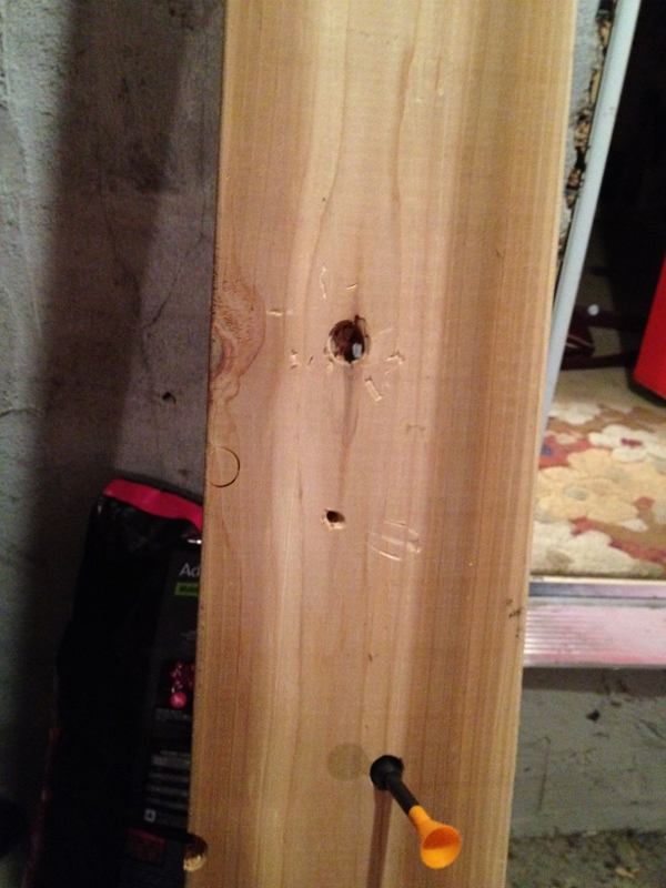

My goal is a 50/50 mix of power and accuracy. The shots I took from 25 yards (measured out and legit) were without any sights on the cannon. These are 2 3 gram darts and some marble/glass shot from 25 yards. Fired at 250 psi.

Picture of ammo added. The cannon also shoots regular arrows.
