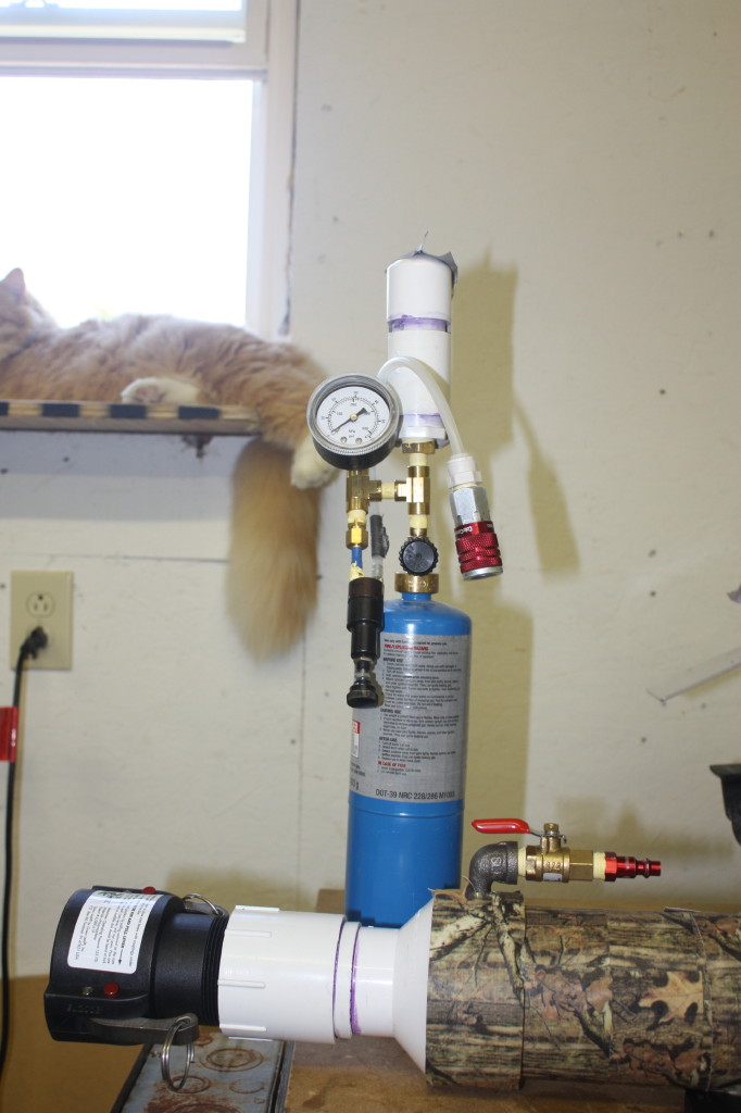

I assume you are using a system to measure your fuel?
The cannon uses a propane metering system connected with an air tool quick release coupler. Much lighter to handle that way - it already looks pretty goofy with the 10 foot barrel attached.
The rifle uses butane measured by a syringe. The pistol will be the same.
The cannon and rifle use little 1/4 inch ball valves on the fuel inlets. The pistol will have a butterfly head screw in the rear cap.
