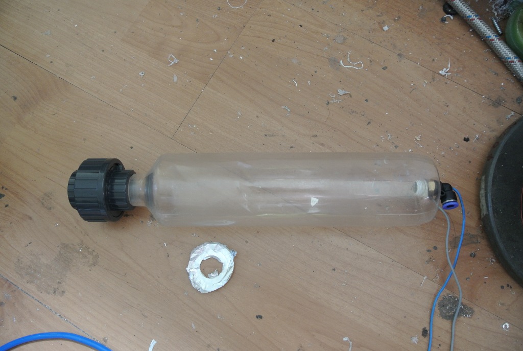

I found a 3/4 pvc coupling that already has an o-ling build inside.
Too bad it's made of pvc if not it would make a neat hybrid. However, that didn't stop me from buying it, so I've saved a transparent plastic bottle for a while, it's made of the same material as coke bottles, but a lot thicker.
So I sanded down the neck of the bottle with a dremel, made the threads on a metal 3/4 adapter then installed the coupling on it.
The bottle is around 1L so it shouldn't be too loud and I'm hoping to make it a easy to use and reliable little cannon to entertain my friends. To do that I thought I'll need a pump for venting and easy fuel injecting, that's why I made a 1/4 thread at the bottom and installed a push to connect fitting, it will be connected to a 5/2 valve witch is connected to fuel meter and a pump.
I didn't want to wast a taser on this so I used a used Bic BBQ lighter, very good quality, never failed to make a spark.
So far I made it work, "BANG" right on the first click, not finished yet of course.

I would, but there are leaks. I could took some time and fix the leaks with epoxy but as it'll mainly be used for entertainment just to show the flame and maybe some crashed potatoes, power never was my goal on a combustion. Also I've to be responsible for my friend's safety, I got to go that extra mile on safety.jackssmirkingrevenge wrote:Nice!

The bottle is pretty thick, so as a combustion I actually believe it's safe, but I don't shoulder fire it anyway Be able to see the gas burning is basically all my reason building this.
