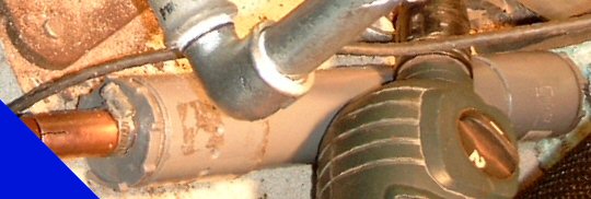

These are the shells I use :
[albumimg]222[/albumimg]
And again :
[albumimg]223[/albumimg]
Pic of the shell, right one, a cheap one, made mostly out of PVC, to the right, a full copper shell :
[albumimg]226[/albumimg]
Pic of the breach with shell in it:
[albumimg]227[/albumimg]
