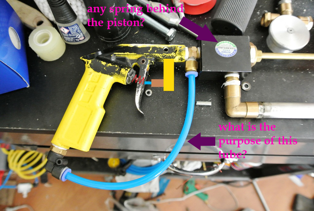

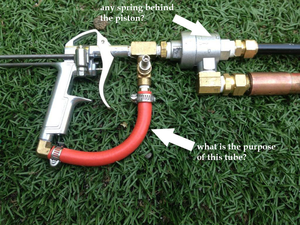

Hi, just have a few question.
1. what is the purpose of the tube?
2. is there any spring installed behind the qev piston?

Blowguns holds higher pressure from the rear than the front. So if you seal the front and channel the air to the back you can use higher pressure in your launcher.

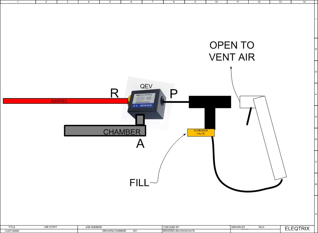

To actuate or trigger a QEV you need to release air from the P port, that pipe is connected to the P port and dumps air through the blow gun from the bottom upwards, For a single shot (dumps all chamber at once) the output of the blowgun could be blocked where it joins the T to the QEV and a small bleed hole drilled to release that pilot air when the trigger is pulled, that's how I would do it. In the first picture there is a schrader valve on the P port side, if that is the fill valve then no spring would be needed in the QEV, that is how they are designed to be used.
That's how this works
Multiple shots get more complicated hence the extra valves to release small amounts of air from the P port.
