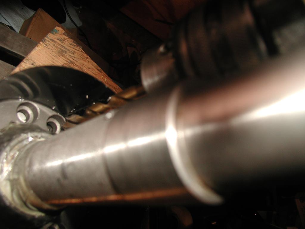

Had to drill my lathe spindle to mount my 4 jaw chuck. I turned/hogged out the adapter (3" spindle to 4" chuck) and used the bolt pattern for my guide. A 9/32nds deep well socket to keep the holes lined up and a piston ring compressor to hold the rig together. It worked very well! :D
Drill bit in possistion to drill the bolt hole.

Sat Aug 24, 2013 7:15 am
Very nice... that ring compressor looks like a useful bit of kit...
