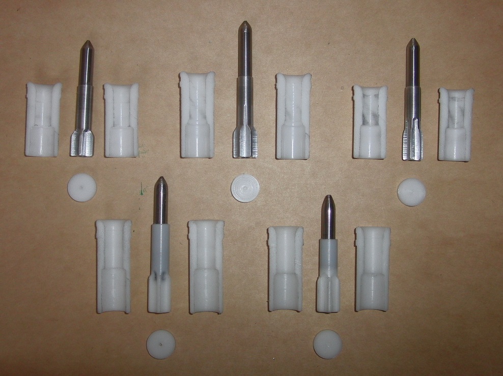

Thu Aug 22, 2013 2:51 pm
Final package for taofledermaus before I pack my tools up :)

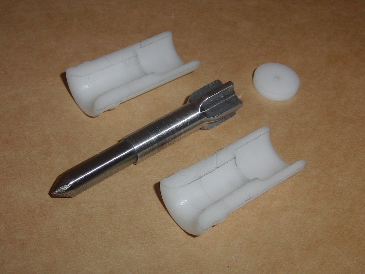

You've probably seen this paper before, JSR, seeing as how it's the first Google search result for "sabot design", but it has a neat little dynamic analysis that explains exactly what went wrong with your first batch of projectiles:
http://www.dtic.mil/dtic/tr/fulltext/u2/a056428.pdf
Basically, that configuration (contact patch aft of CG) is unstable in yaw. Obviously a longer contact patch will be more able to resist this, but that tends to work against the principle of reducing sabot mass.
There's also the more obvious failure mode involving the core penetrating the sabot owing to insufficient mechanical strength in the sabot. Have you investigated your safety margin against that happening? There's a good chance you may have been seeing a combination of the two failure modes I mentioned.
Sat Aug 24, 2013 7:07 am
Yep, I should have known better, those first rounds were a combination of lazy machining and mindless optimism.

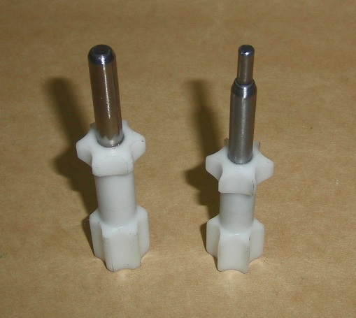

DYI wrote:There's also the more obvious failure mode involving the core penetrating the sabot owing to insufficient mechanical strength in the sabot. Have you investigated your safety margin against that happening?
That's what happened here:
On acceleration, the core slipped through the delrin tail (where it was only a push fit) and dug into the shot cup.
Both factors have now been taken into account though, using more supporting sabots to stop the projectiles yawing in the barrel, and delrin disks to reinforce the base of the shot cup.
Here's the latest batch for demolition ranch, I've been machining like crazy lately to reduce my material stocks before moving to Quebec :D

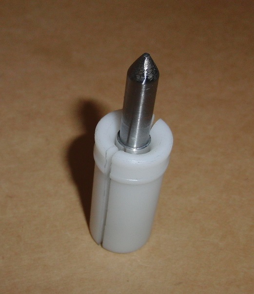

Sun Aug 25, 2013 1:00 pm
Here's the latest fabriaction, fitted with another set of find approximately at the projectile centre of gravity, so that it can hopefully be fitted directly in the shot cup without the need for extra sabot parts:
