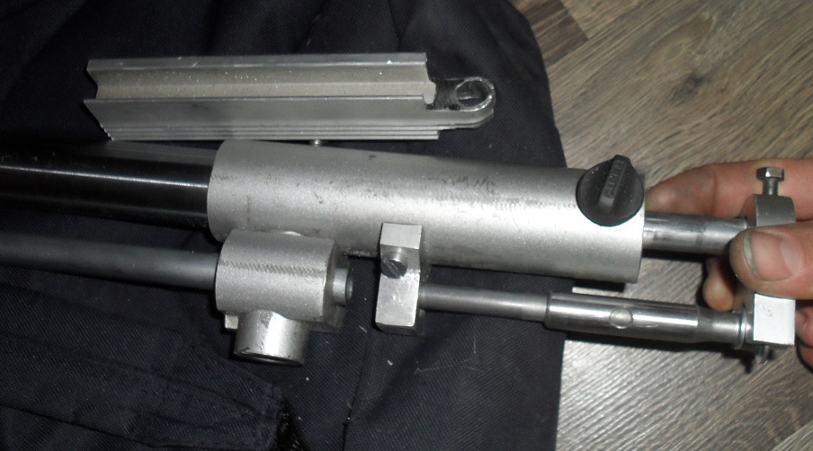

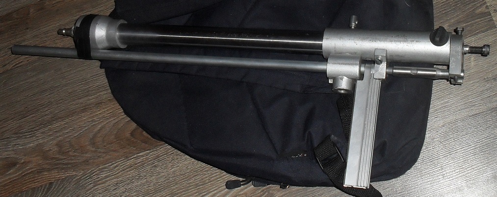

Well...I've restarted the quest for an assault-rifle type launcher.
So far I have a precision 10mm hydraulic tube for a barrel, 10mm BP roundballs as standard ammo..
I used some more seamless tube, 25mm I.D as the main reservoir and the CBHV, wich I have given a tune-up.. :D
The first two testshots I thought something was wrong.
The first one, at just 30 bar shot a hole through my leather welding glove...casually hung over the muzzle.
Usually this catches and stops the projectile.. :roll:
Hmm.must have been a worn spot?
Second shot I decided to use a capped off section of pipe to catch the projectile.
I haven't been able to relocate the pipe.... :roll:

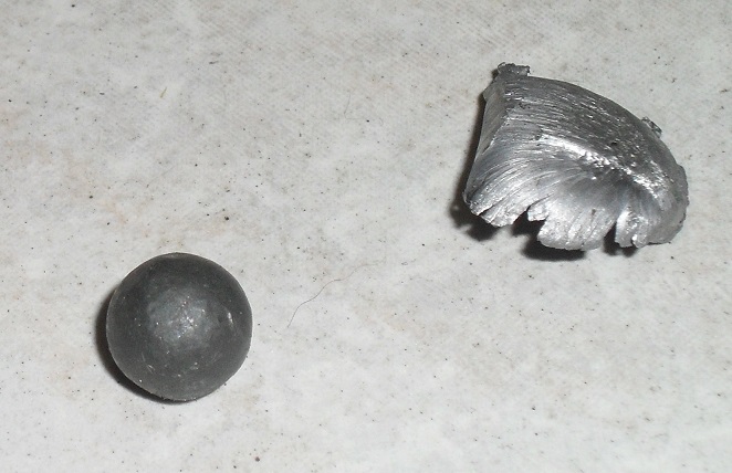

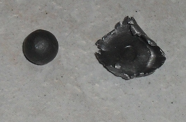

Third testfire was done inside of a forktube wich I had braced against the brick wall...
It completely pancaked the lead roundball..... :D
Looks exactly like those seen in high speed footage of 9mm handgun ammo hitting a steel object...HMM..
All I did was tap the strikerpin with the handle of a small file... :D
No effort at all.
Definately some potential!!
On all testshots the bolt/slide blew back completely...I was worried blowback would hurt performance...seems it works exactly like it should.
The striker runs through a piston to hit the valvestem.
The valve allows some pressure to exit past the valvestem to drive the coilspring backed piston back and load the next shot.
Clearly not yet finished....
I'll have to tinker with it once a semi/full auto hammer/sear/trigger is added as it will most likely respond a bit differently.
I can add a rubber washer as a one-way valve to give the blowback piston more power if needed and boost up springforce if autoloading isn't smooth enough.
The bolt comes from a powdercatridge nailgun..wich I could not use anyway for legal reasons.So I stripped it for parts to use in a pneumatic.
It's such an exact fit !!
The breech is 100%airtight yet the bolt cycles smoothly...without an O-ring seal! :bounce:

Now...I cleaned her up, took away some bulk...and got her to cycle to the point where a second round is about to be chambered...only to grind to a stop about halfway in.
Custom slugs should fix that.
I still have to wrap my head around the issue of the hammer, sear and trigger and how to mount them on the launcher.

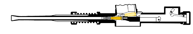

Usually I can figure out how a design works, but this one is something unique to me. Could someone explain how it works, or maybe a rough paint diagram. BTW for the projectile have you tried loose10mm bullets, they are ment for reloading caetriges, and if they r too tight you can keep a piece of barrel material in a vice and hammer then through to size , that seems easier then casting bullets
Netherlands
Posts: 3497
Sun Jan 05, 2014 1:49 pm
It might be a one of a kind solution...but I doubt it.
I made it up myself...I needed a trigger and a stopper.
When the trigger is pulled and held down the bolt comes back, that stopper should hold the bolt untill the trigger is released again.
Once the trigger is released, the stopper is no longer blocked by the triggerthingy,,and the bolt slides forward and engages the trigger.
Shown here in firing position:
Imagine what happens when you pull the trigger and the bolt hits the valve, then gets pushed back by the pressure:
Oh..and the yellow stopper is not that square in reality.It's rounded off a bit to work smoothly.
It can swing both ways.It can turn right to allow the bolt to pass, and in case the trigger is not pressed, it can swing left to allow the bolt to pass forward to the trigger-thingy.
You can see that getting the yellow stopper out of the way would turn this full auto.... :mrgreen:
