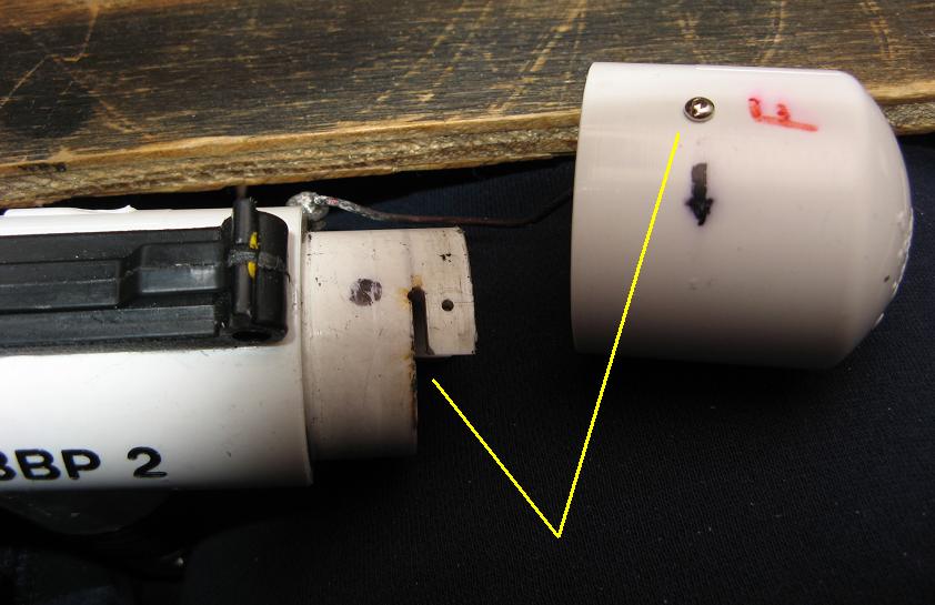

I made a few changes to them though. When i shot a marshmellow from them at my home the rear cap blew off wich im lucky i wasnt holding it up near my face it might of gave me a fat lip. I added a screw to both caps and cut out a little notch to push in, twist and lock so the caps can both be removed but locked on under the pressure.

Maybe you think the caps are threaded?
Ive put 2 safty spots on all of these smaller guns, i put a small allen screw in both caps and i put a key cut in both connections to the tee.
These 2 spots are both pretty weak i could break them off with my fingers. They will let go and blow the caps off before the PVC lets go.
I could test them with a scale using a dowel rod and pushing down on the scale till they break off. We almost have a setup to figure the velocity of the marshmellow. We tried with just the marshmellow but i think we will need to wrap it with foil or something solid to trigger the sensors.
