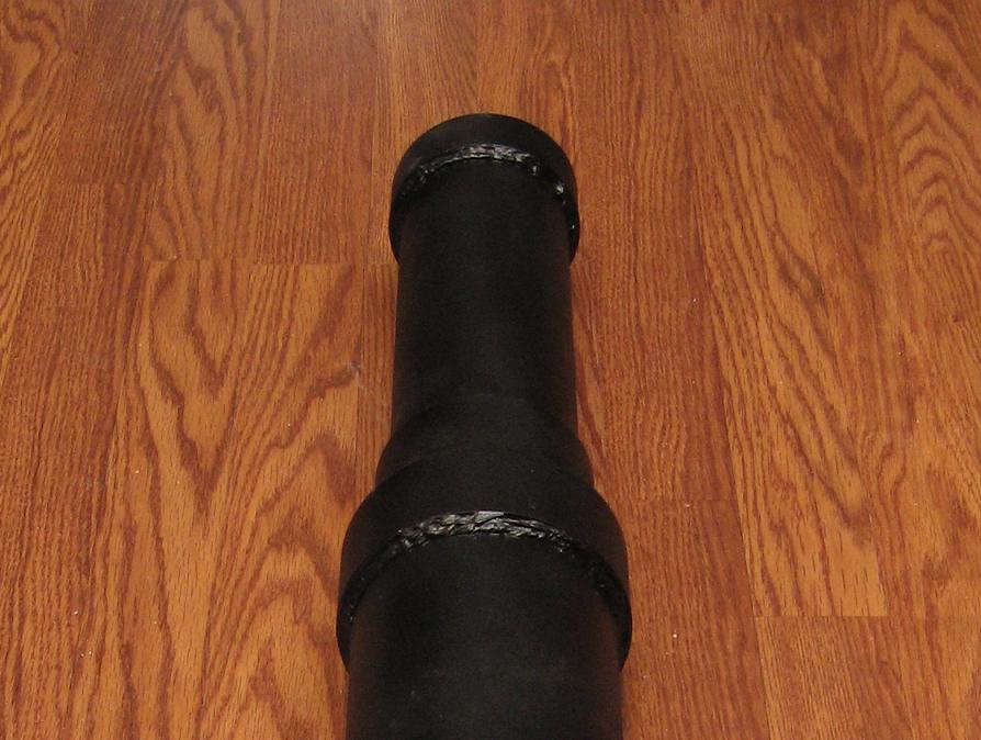

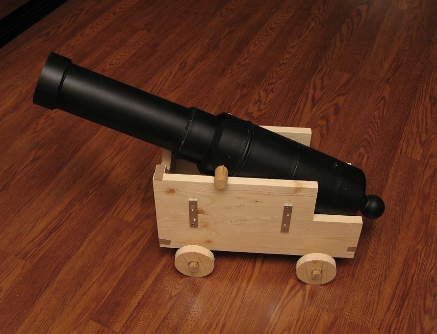

I finally finished it! I call it The Slice, The Wilson Slice
1/2 teaspoon calcium carbide powder grade for cannons, about 1-1/2 cups of water. Shoots the 75mm kids starter tennis balls from walmart. These are low bounce balls with pretty heavy fuzz compaired to a standard tennis ball. The low bounce balls are 2X as soft as far as how firm they are i think they absorb alot of the shock of the blast.
I put a shot 2" rail on th ebottom so i can use a rifle tripod to make it some what portable. Use a large 1/4" door hinge pin in the reducer to stop the balls from rolling down into the breech. Also helped support the cannon while i painted it. I hung it from that pin a few times.
Cant wait to fire it again, ive fired it a few times after i first built it but dont think i fired anything from it. Best one ive built so far.

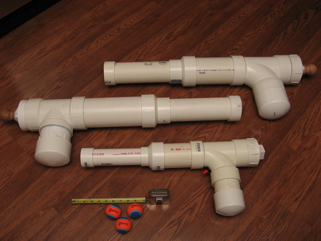

These are the first 2 i built i think i put about 15 shots threw the black one till a guy at my local gun range HAD to have it so i let it go.
The breech cleanout cap has a rod that puts the powder holder, as you insert the cleanout cap and screw it in that dumps the carbide down into the water chamber creating the gas. Wait a few seconds and let it rip!
