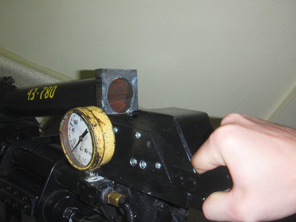

I kinda hate to do this to you guys since it'll be awhile till I can get some actual shooting done, but I'm just gonna leave this here.
Details man, details! What on earth is this wonderful contraption? Is that real CF furniture?

jackssmirkingrevenge wrote: Details man, details! What on earth is this wonderful contraption? Is that real CF furniture?
Ha, didn't want to spill too much before I got to post it for real. I wanted to upgrade my old hybrid, but after everything was accounted for it ended up being a completely new gun. The pressure gauge is the only old part I kept.
The CF is real.
I can't do much shooting in the garage, tested some golfballs and an Al. slug on a 1/8" steel plate. (~2500 ft-lbs)
I cannot believe it but the golf balls survived the impact.
Added a slide/break-barrel for the hell of it.

Love the hinged barrel! Is there some kind of seal involved or let the gasses escape where they may?
I'm glad you did, it adds a certain je ne sais quoi :)
