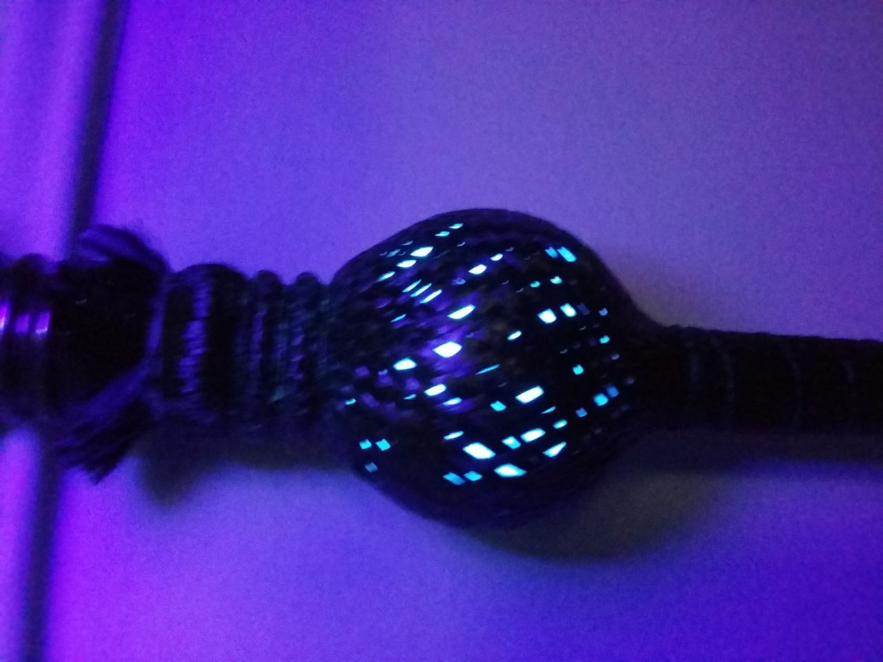

That's a replacement for the grey/pink initiator chamber. This is just a test casting as I have never made any carbon fiber before, and I need to figure out the details. Notice the corrugated steel pipe is a short scrap piece.
The mold inside the carbon fiber is 3D printed and painted with water based poster paint, actually the paint is poster paint for blacklight from another project, but is very well suited for this due to a number of reasons: It is easy to apply to the 3D printed mold, it comes off easy too after is has dried so it acts as a release agent between the epoxy resin and the 3D printed mold, it will dissolve in water and in a dark room with a blacklight torch, I can easily see if I need another layer of carbon fiber sleeve to cover the mold completely.
The epoxy resin is a high temperature variant that I need to post-cure at elevated temperatures, so I also need to get some kind of baking device for the carbon fiber part before it is suitable for sound cannon use. I'm hoping that during the post-cure baking, which will eventually reach 160°C, the 3D printed mold will become so soft that I can peel it out of the carbon fiber part.
