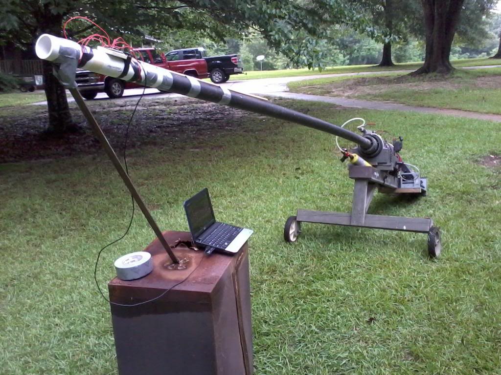

Anybody tried making one of these, does it actually work ?

I think that is a bit more complex than needed. You don't need the IR LEDs since ambient light is usually enough. You can use a slice of a pipe to mount the phototransitors so that ambient light can get to the detectors. Since you don't need the LEDs you don't need to use the USB port.
http://www.inpharmix.com/jps/Jims_chrono.html

If you are really cheap (raises hand) you can just use your phone (or laptop or tape recorder or ...) to record the sound of your gun firing at a piece of wood a measured distance from the barrel (watch out for the ricochet). The recording will have a strong signal when the ammo "uncorks" the barrel followed shortly thereafter by the sound of it hitting the target.

When I made mine I had all the parts lying around (including the Arduino). But starting from complete scratch would require an arduino (~$40), any laptop capable of running Arduino CC (which is any laptop made in the last 20 years capable of running debian: ~$50 - max not defined), and some IR LED's and phototransistors ($10).
Jimmy's method linked on his site is probably your best bet if you have a computer with a sound card (highly likely, includes integrated audio... sampling rates will obviously differ). Although, the software recommendations could be updated a little (*hint hint* :wink: , Audacity can do most of the things mentioned on the page at least on Debian).
If you're transitioning to Larda-level velocities, or you want something dead simple, you can build a break-wire chronograph, which is exactly what it sounds like (a wire carrying a sense current which when broken triggers either the "STOP" or "START" function of your "timer", which could also be a sound card).
