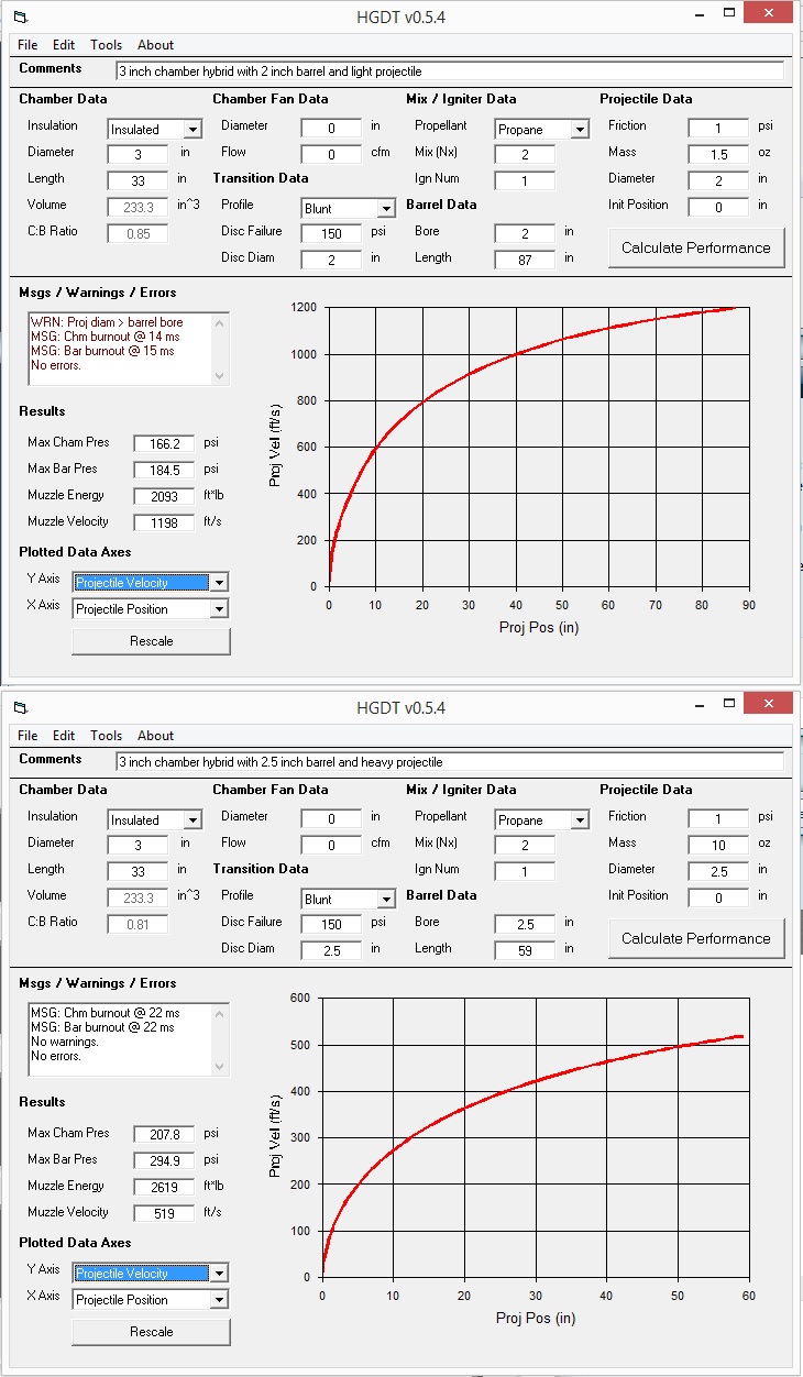

Here's an HGDT simulation of a 3 inch chamber hybrid at 3X where the burst disc is too strong and doesn't burst, a worst case scenario giving you maximum chamber pressure:
As you can see, it maxes out at 330 psi.
Schedule 80 PVC has a burst pressure of 1200 psi and working pressure of 225 psi, safe to say that even in this scenario a correctly manufactured pipe would not burst. In practice of course if you run only at 2X and use an appropriate burst disk, chances of a chamber rupture are virtually zero.
Nothing is 100% safe of course, but in this case competent assembly of fittings is much more critical, as it is more probable that a poorly attached fitting will fail than the material itself.

Thank you so much for that data, unfortunately, I cannot use HGDT as I have a new computer, which is a Chromebookjackssmirkingrevenge wrote:Here's an HGDT simulation of a 3 inch chamber hybrid at 3X where the burst disc is too strong and doesn't burst, a worst case scenario giving you maximum chamber pressure:

No worries, I went head and ran more typical numbers and as you can see with a 4 inch long potato slug you'll have the same energy as a .44 MagnumThank you so much for replying to and helping me.

jackssmirkingrevenge wrote: No worries, I went head and ran more typical numbers and as you can see with a 4 inch long potato slug you'll have the same energy as a .44 MagnumNote also that peak pressure does not exceed 250 psi, well within the limits of the materials if correctly put together.
That is so awesome, I would never have dreamed of that much power!! I know it seems inferior to all you welding machinists, but it is more than I would have dreamed of!!

Hot gas and the instant "valve" certainly gives hybrids the edge when it comes to raw power.That is so awesome, I would never have dreamed of that much power!! I know it seems inferior to all you welding machinists, but it is more than I would have dreamed of!!

Well you'd better sit down for this then, with your numbers HGDT suggests that with a lightweight projectile in the 2 inch barrel you could go supersonic, while a heavy projectile in the 2.5 inch barrel you'll have muzzle energies approaching a 12 gauge shotgun slug:Again thanks for your time, that comment about it's energy relative to a .44 Magnum has completely made my day!
(I was riding my horse and all I could think were the words "...more energy than a .44 Magnum...")
This means a hefty recoil too, you're probably better off with an inline as opposed to an over-under design that will avoid putting torque on the elbow.
