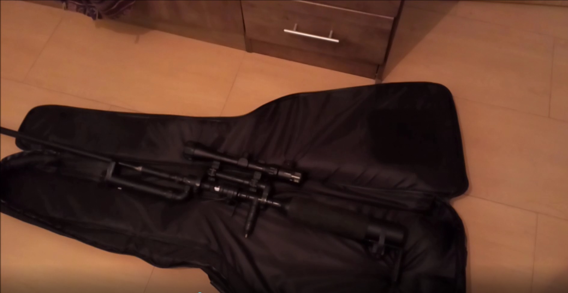

Hey guys,
All the info is in the video if you're to lazy to read :lol:
So i've been working on a new PCP, my main goal was to get more than one shot per fill while maintaining power and accuracy. What I came up with was a 48" long QEV and Slide valve air rifle with a 25" 14mm diameter barrel.
I tried to keep the build on the cheap side so other than the the QEV & Slide valve from ebay i used what i had or found.
It's got a 600cc air reservoir that i got from an old soda stream machine, the reservoir is connected to a tee with a schrader valve. on the other side of the tee there is a 1/2" QEV (modified with a spring) with a 1/2" slide valve as a pilot valve. the QEV air port is connected to a 1" diameter 20cm long plumbing tube (which gives me around 100cc of volume). last, the output port of the QEV is connected to a 14mm diameter, 25" long aluminum tube that i have found. Ration beetween the air reservoir and the firing chamber volumes is 1:6 (in favor of the air reservoir :o )
the performance from this rifle were better than i expected: First, it's really comfortable to shoot. I get 5-7 good shots with one fill of 160 PSI (that's as high as my bike pump can do) , it's really accurate (so far i've only fired it from up to 25 meter away) , and it really powefull, more the enough from small game.

Great job!
160 psi is relatively low for small calibers, if you manage to go to higher pressures it will really be a revelation as to what the power potential is. If I were you I would consider getting a paintball HPA bottle that will give you a regulated power supply for more consistent shots.
A Ninja tank like this one has an adjustable regulator that can be dropped to about 450 psi output, and you would be able to fill it with a PCP pump (and give yourself a good workout!).
replacing the barrel with a 10" diameter barrel so i can shot 10mm bearings with it (didn't find any bearing that fits this barrel)
If you're interested in usable accuracy, this is the way to go in the circumstances, but make sure you get proper bearings and not something sold as 3/8" slingshot ammunition to make sure the diameter and shape is consistent.

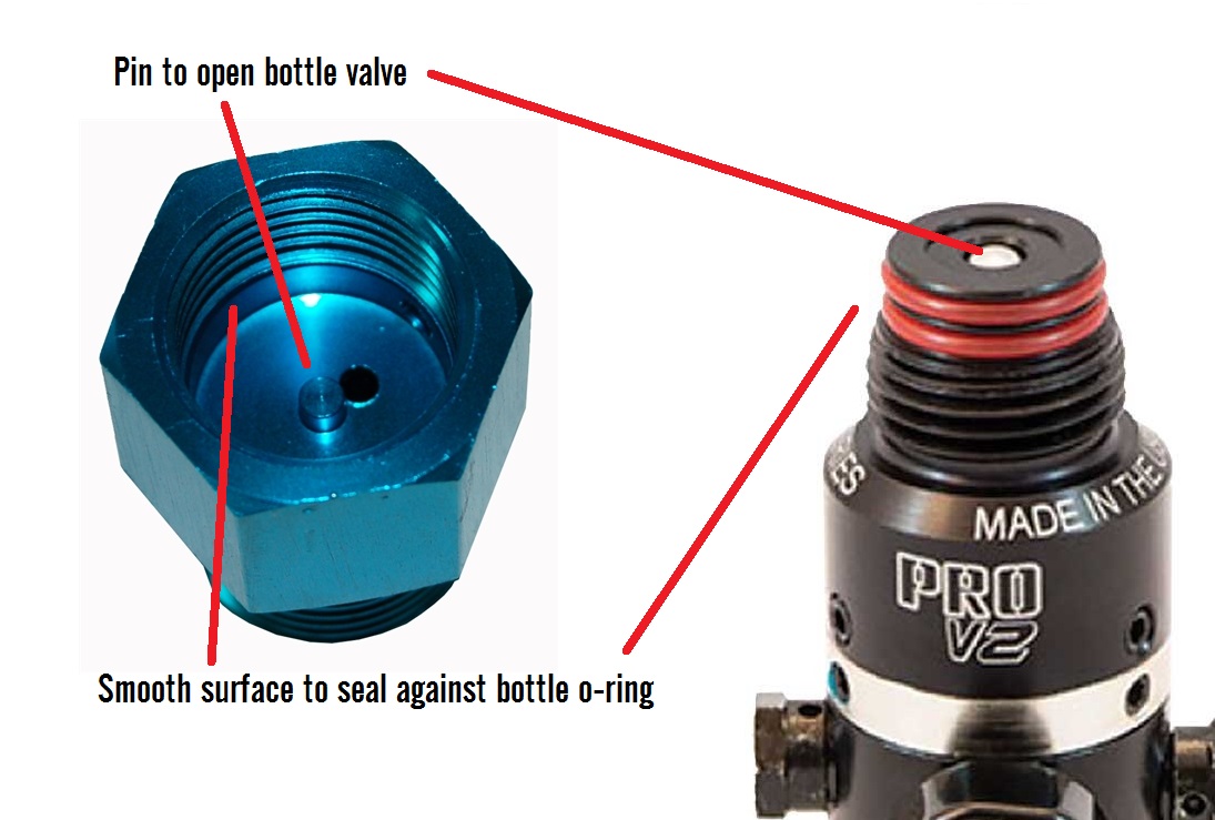

1/2" BSP is the same as the ASA thread on paintball tanks, here's one in a 1/2" BSP ball valve:
You will however need a smooth surface inside the fitting beyond the thread for the o-ring to seal, and some sort of pin to open the valve on the paintball tank.

In as much as they have the same thread size, yes, but there's a caveat, paintball fittings have certain attributes to mate with bottles:
In order to use it with a plain BSP fitting, you would have to put thread tape or sealant to have the bottle permanently fixed to the launcher, and you would have to remove the bottle valve.
