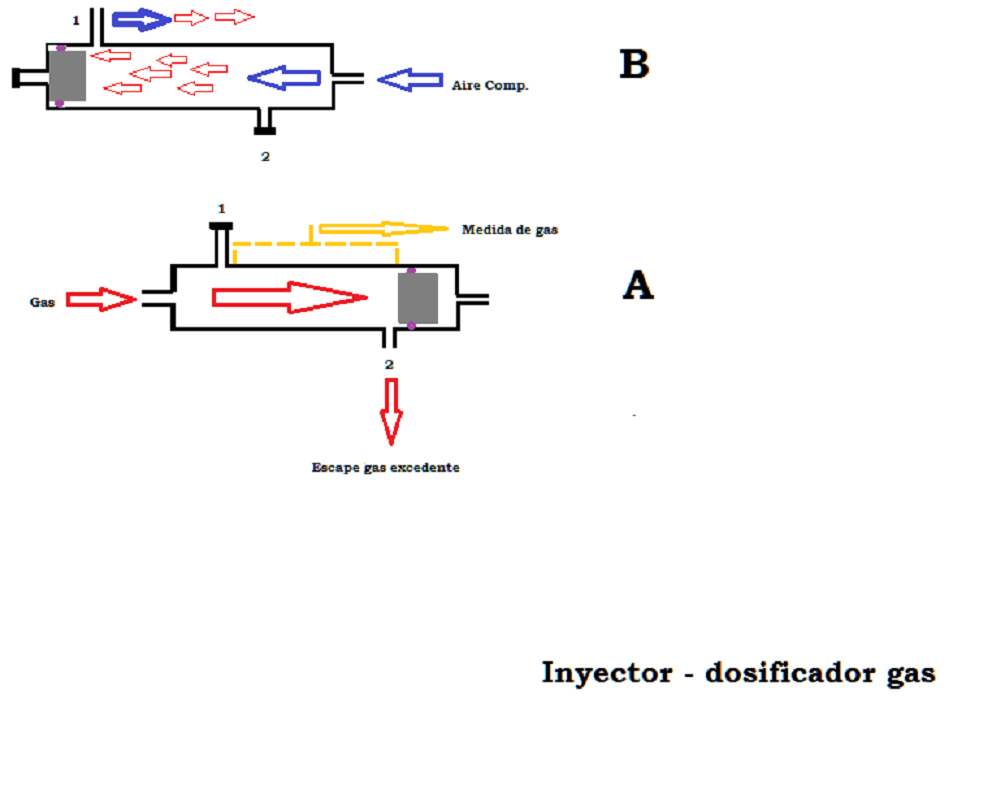

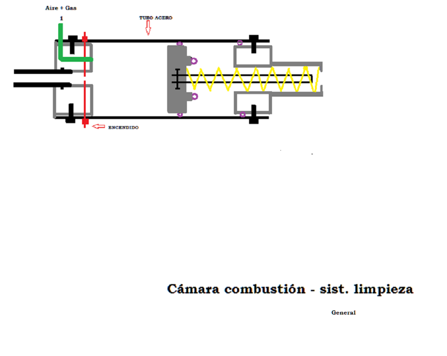

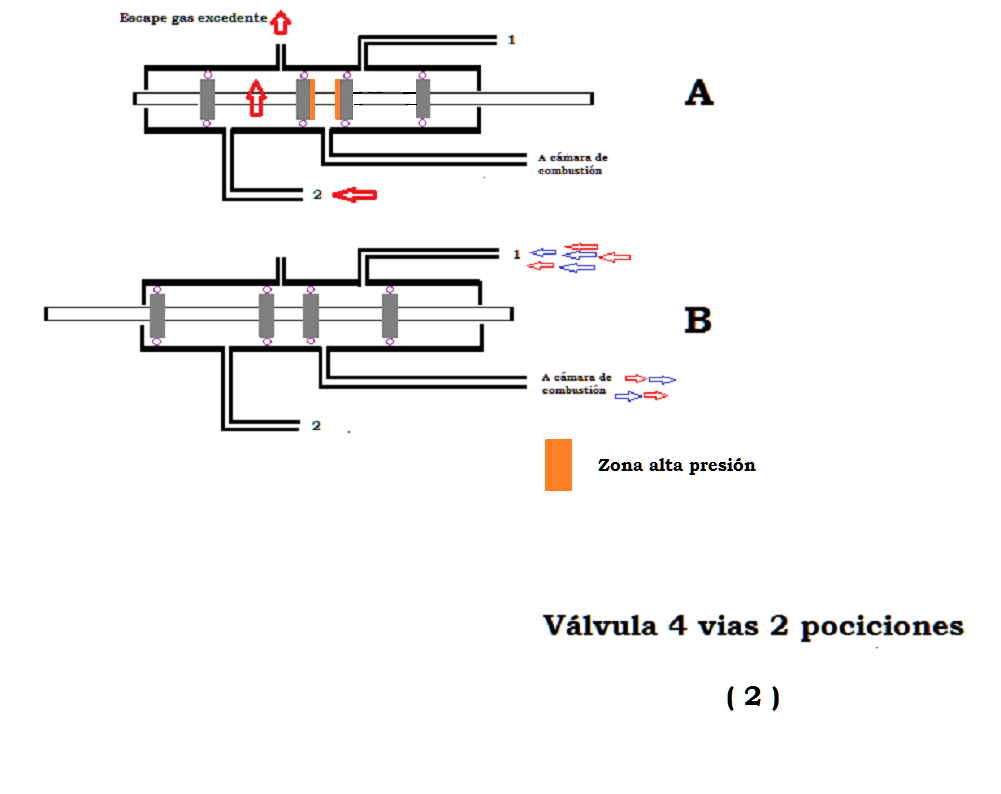

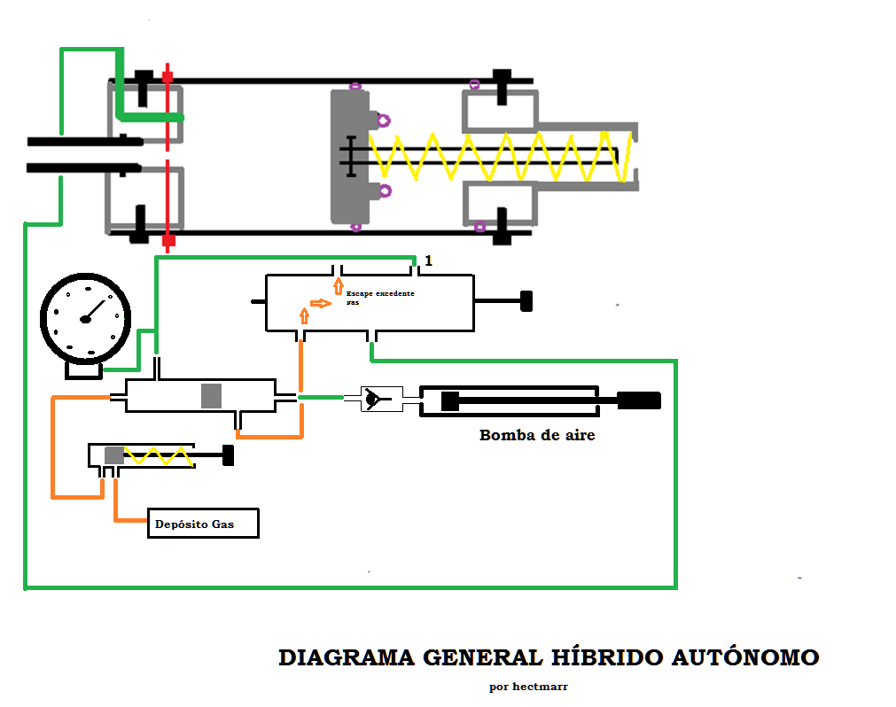

When the 4-way valve is closing the combustion chamber, position "A", this valve resists the combustion pressure, so it must be resistant.
This prevents the injector-doser cylinder and the filling line from being subjected to high pressure.
At the same time, it closes the line of the manometer, before the firing, so that it is not destroyed, because the pressure produced by the deflation is much higher than the maximum pressure that supports the manometer.
At the same time, in this "A" position, the 4/2 valve releases the pressure on the side of the piston in the diagram, thus remaining at atmospheric pressure to be able to go to this side when gas is recharged again.
This valve is self-built, and is reinforced with glass fabric and polyester resin. The 10ml syringe is only useful for the plunger with the o'rings to slide smoothly. The zone that supports high pressure, has double o'rings, so that it does not fail.
I have disregarded the one I am using ... The Bourdon tube exceeded its elastic limit by forgetting to manually close the line when it was performing the first tests. Stupid me :|
I upload the diagrams again. I hope they look better.
I hope you understand the diagram and my English as a translator. If not, let me know and I'll try again.

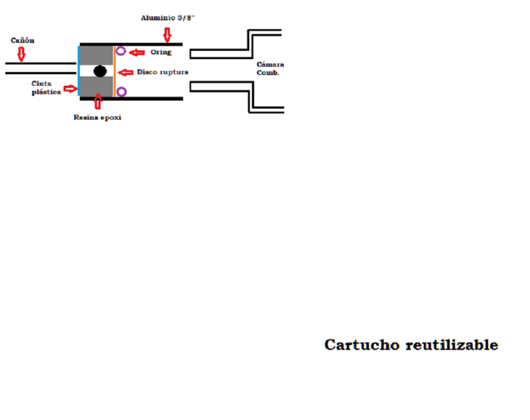

Wow, much more ingenious than I initially understood. I hadn't realized you were using burst disks on you "cartridges"!
Once again, excellent work!
Argentina
Posts: 1064
Location: Argentina
Has thanked: 274 times
Been thanked: 276 times
Mon May 01, 2017 9:50 pm
jackssmirkingrevenge wrote:Wow, much more ingenious than I initially understood. I hadn't realized you were using burst disks on you "cartridges"!
Hello ! Thanks again!
Yes it is. I thought I had mentioned it sometime. I'm using thin aluminum foil as a rupture disk, the kind that have cigarettes. With two disks of these the engender works :?

hectmarr wrote:Yes it is. I thought I had mentioned it sometime. I'm using thin aluminum foil as a rupture disk, the kind that have cigarettes. With two disks of these the engender works :?
It was hard to comprehend from your microscopic diagrams before ;) if you want a "healthier" alternative, I found that photo paper makes an excellent burst disk for small calibers.

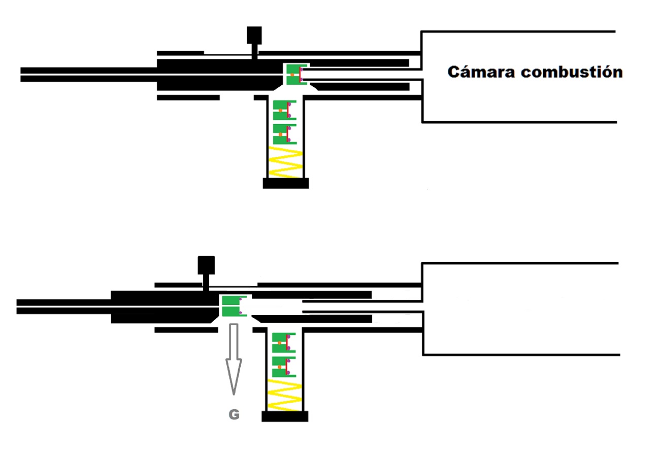

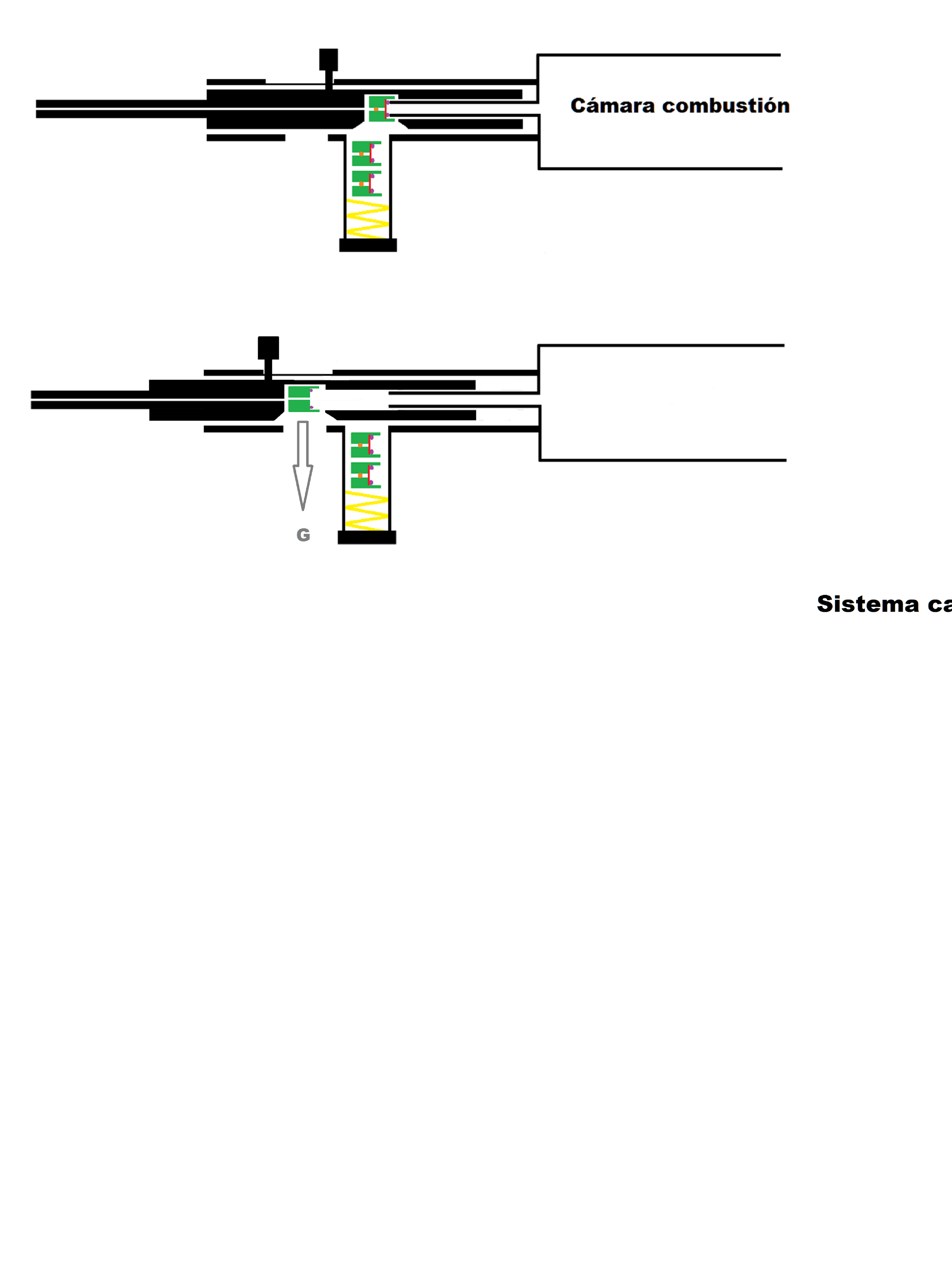

I was trying to make progress in this small hybrid project
Autonomous, trying to improve it.
As an improvement, the new prototype has a loading and ejection system
Of the cartridges very simple, which is in the diagram that I attached.
The other improvement is that it shoots between 5.5 and 6X.
In addition, it has associated the change of position of the distributor valve
To the movement of the cartridge loading lever.
Few steps to the next shot, that's what I'm looking for ...
I have also added a check valve that lets the flow through the
Combustion chamber, but not vice versa. This was necessary because the explosion
Is stronger and the valve distributor was sufficient in prototype 1 to
Contain the explosion pressure, you can no longer alone ...
I built it with two couplings, a 1/4 "steel ball and a small spring
To be normally closed. It worked perfectly so far.
The sequence to shoot was as follows:
1- Charge gas
2- Load the ammunition and at the same time expel the used cartridge.
3- Inject air with the pump
4- Take out insurance and PUMMMM !! :bounce: :bounce: :bounce:
As soon as I have free time, I will upload a video of how this works, I mean
System of loading and ejecting cartridges, and also upload some photos.
The woods, trigger and grips of the weapon are still to be finished.
Sistema carga y eyección cartuchos híbrido

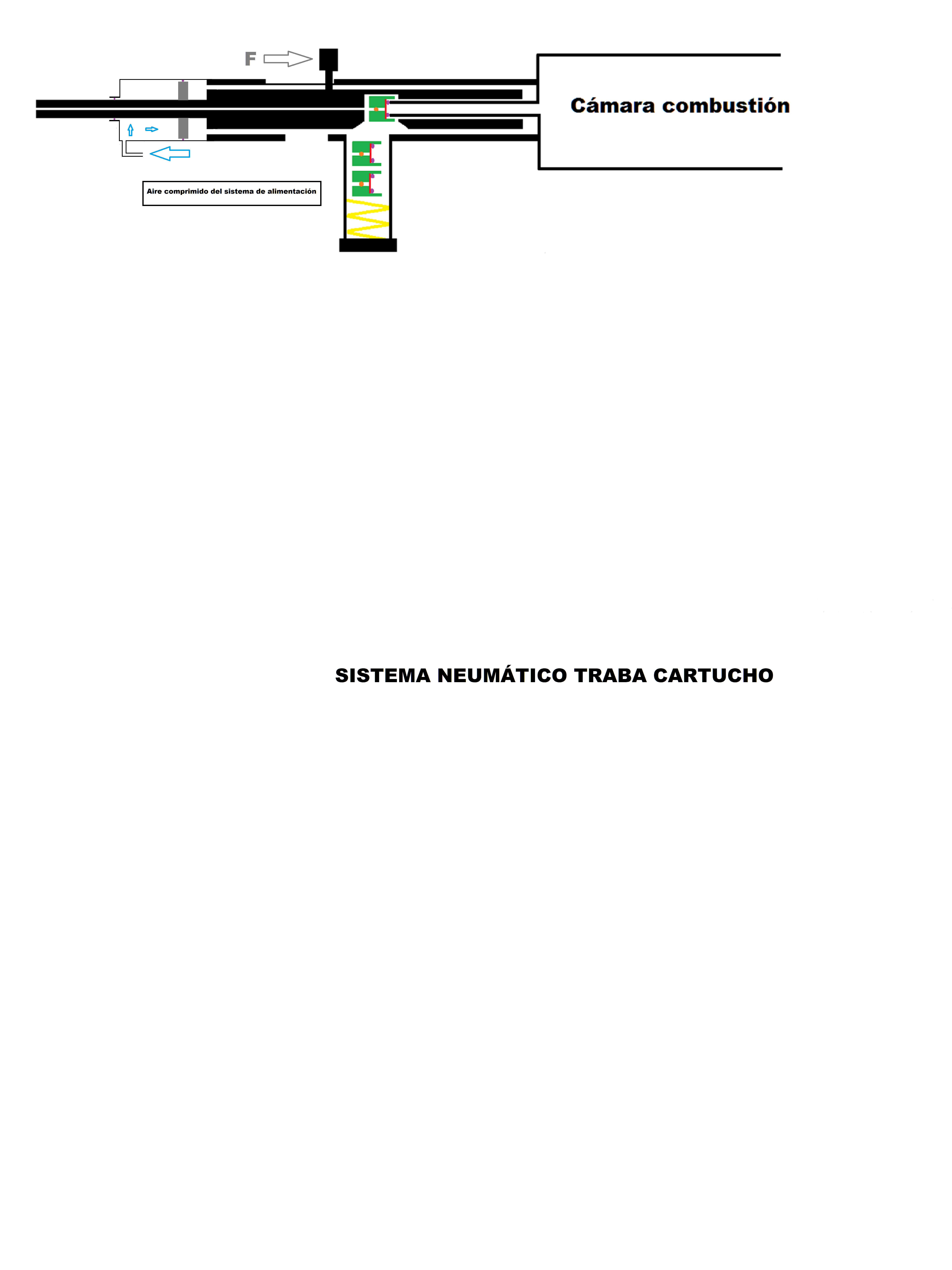

An interesting possibility is to obtain the force necessary to lock the cartridge so that it does not lose air, and to be a more firm seal, is to exert that force with a piston and compressed air of the air pump, as it is drawn in the diagram.
The problem I am having is that the mechanical lock I am using, has to make enough force so that only 6X there are no leaks. In this way I tell you, there would be no wear and tear on the metal parts that are touching and worse pressed against each other, which is the method I am using in the present.
Likewise, with the addition of a spring can open and close the device, I mean, load and expel the ammunition not manually. Without air, it would expel the cartridge and with compressed air making force against the plunger, load the cartridge and lock on the oring. This could be commanded with a simple valve coupled to the pneumatic gun circuit.

Have you considered using the pressure itself to force a seal? It's a little complicated to make without a lathe as you would need o-rings but the idea is feasible, I have done it in the past.
Argentina
Posts: 1064
Location: Argentina
Sat Aug 12, 2017 10:20 am
jackssmirkingrevenge wrote:Have you considered using the pressure itself to force a seal? It's a little complicated to make without a lathe as you would need o-rings but the idea is feasible, I have done it in the past.
Yeah right. That's what I'm interested in to improve sealing. It is more complicated, but it would be worth a try. In the drawing is the way to do it, always based on what I have built. In my case the firing barrel moves, and the option would be to adapt a piston attached to it.

Wed Aug 16, 2017 4:09 am
Something like this:
For it to work, the piston has to be in close contact with the disk and seat before the gas is introduced so the pressure will lock it in place.
Argentina
Posts: 1064
Location: Argentina
Wed Aug 16, 2017 7:05 am
Nice idea you drew. :bounce:
