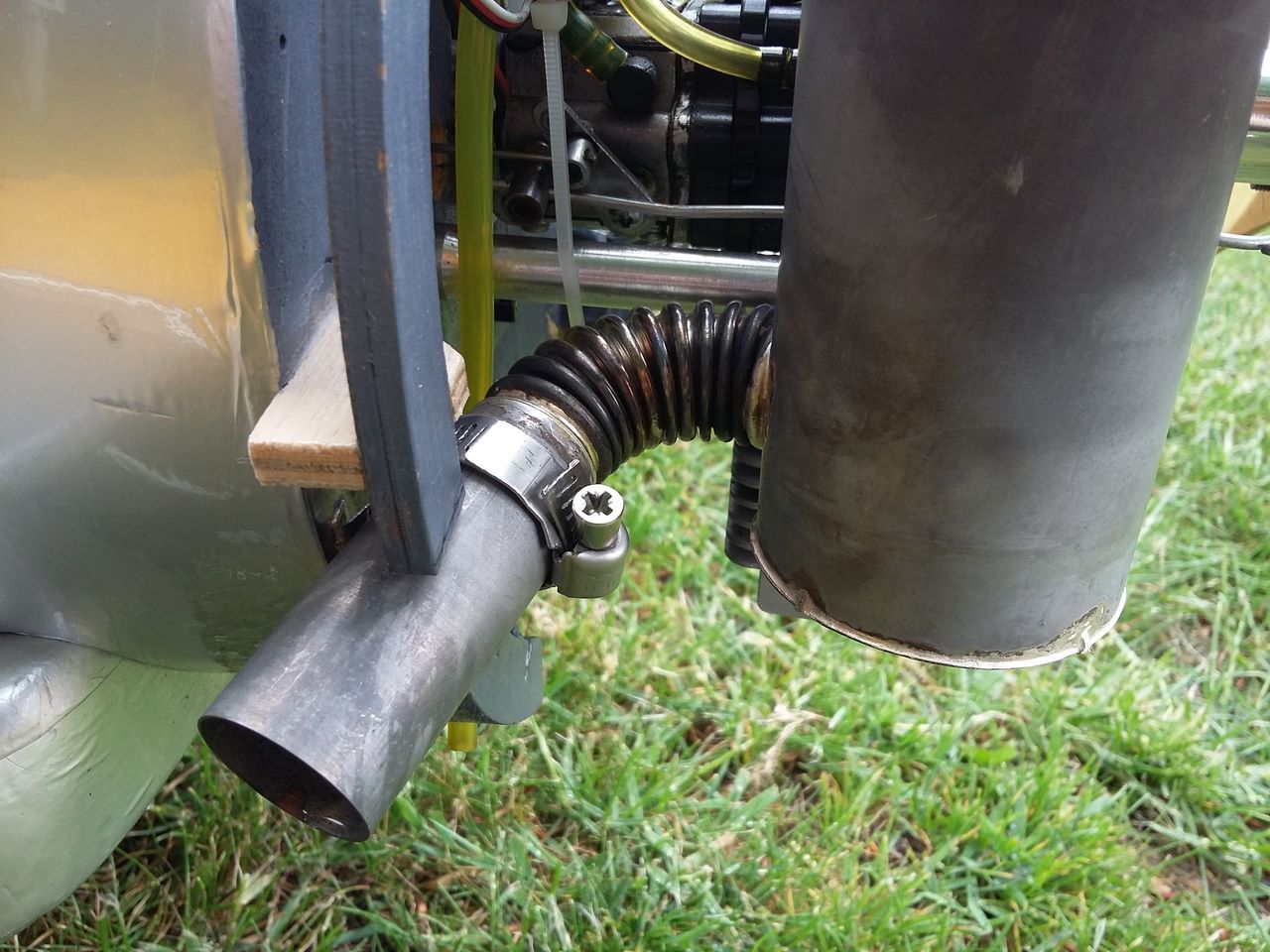

I don't want to ruin the looks of the RC plane, so I wanted the air intake for the cannon to be the scale engine air intake on the model. Problem was, it is located right behind the exhaust stingers from the gasoline engine. I can't really feed the cannon with exhaust gasses, it needs fresh air.
So I decided to make a whole new exhaust for the engine, and I made it so the actual exhaust pipe was located as on the real plane. It took ages to silver solder a whole exhaust, so I'm glad I now have a TIG welder, because at some point, I might want to make a lighter exhaust from aluminium, it could also be a lot smaller, but I went for the bigger volume to get another sound from the engine.
