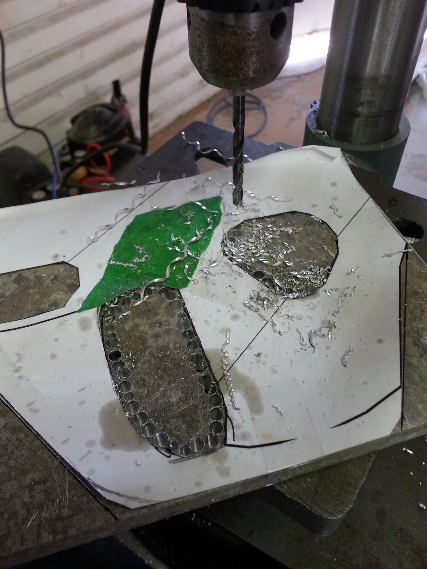

Wed Sep 06, 2017 6:38 pm
A bit of drilling, this is going to be a lot of work :o

Your dedication to this painstaking form of construction is very admirable.
Thu Sep 07, 2017 2:31 pm
No jig saw available? Hacksaw blade? Working with what you got??? Sometimes I still have to wrap a blade with a rag and saw like crazy to get a job done...

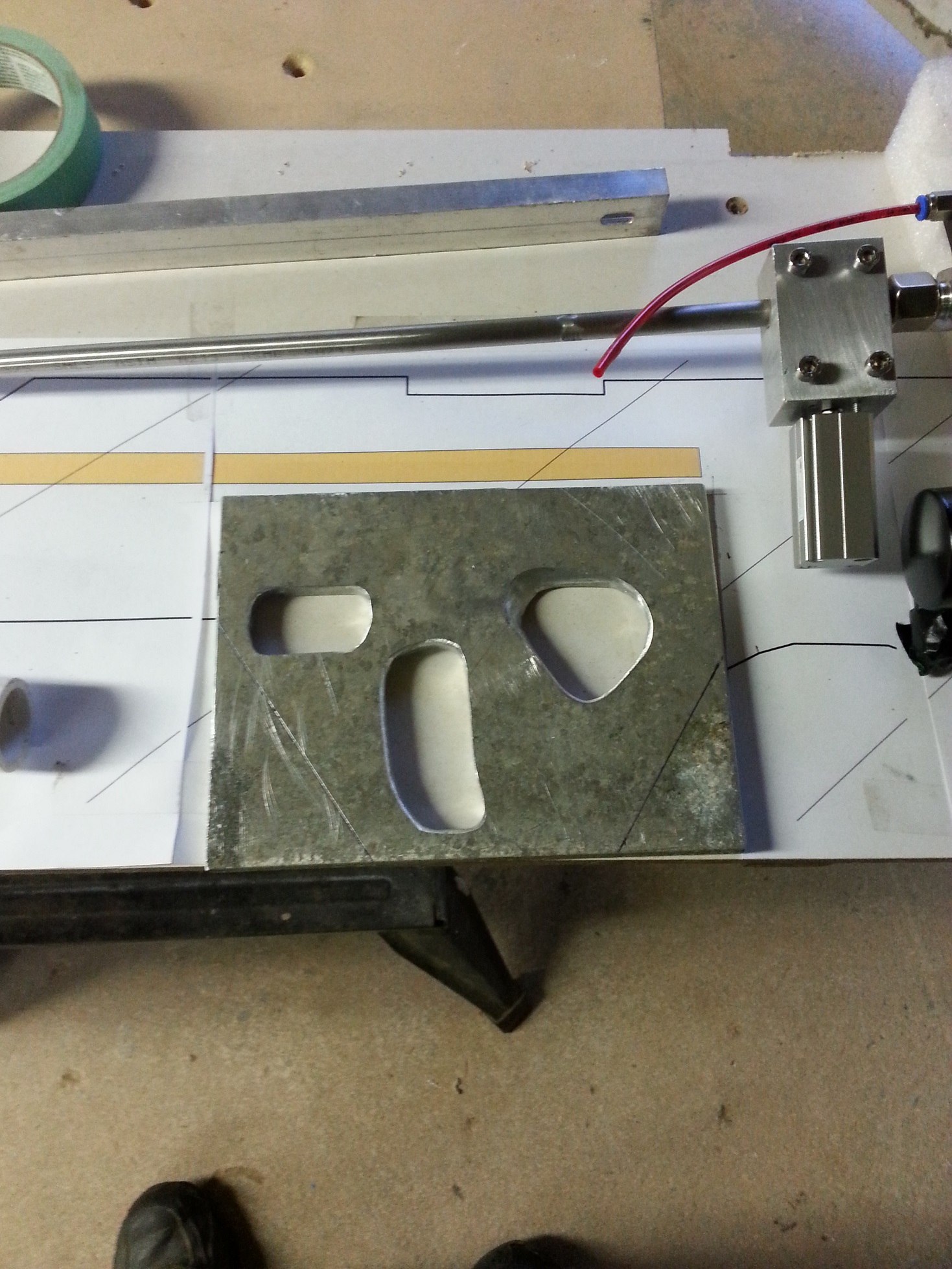

jackssmirkingrevenge wrote:Your dedication to this painstaking form of construction is very admirable.
Drilling holes and filing is my therapy.
10mm thick alluminum and tight corners not so jigsaw friendly, took me an hour to get that far :| Did a bit more today, made trigger and started to mount trigger valve.
Sort of got most of it worked out in my head, but anything can change, and usually does :idea: :idea:

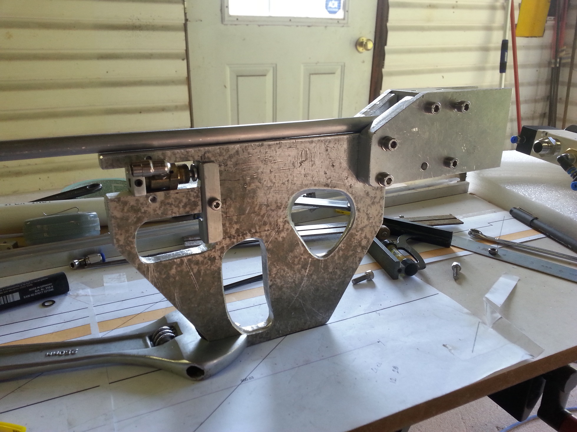

Sat Sep 09, 2017 4:05 pm
A bit of afternoon drilling and filing

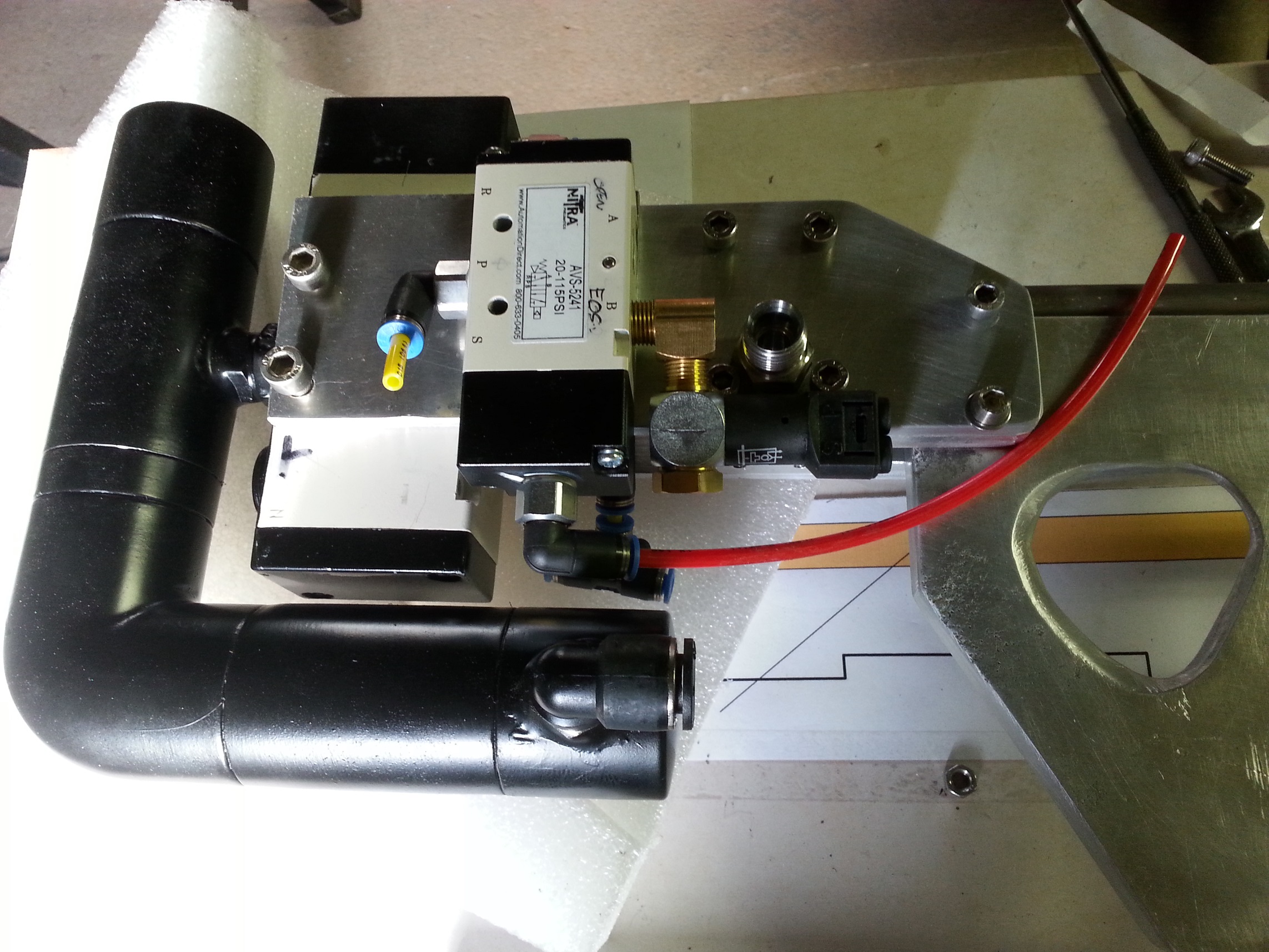

Sun Sep 10, 2017 4:50 pm
+ gets you out of the house...sorta.
Workshop is 50 feet away from the house, so it does :D no heating though so I don't do any work in the winter much :cry:
Control valve pretending to fit on RH side
