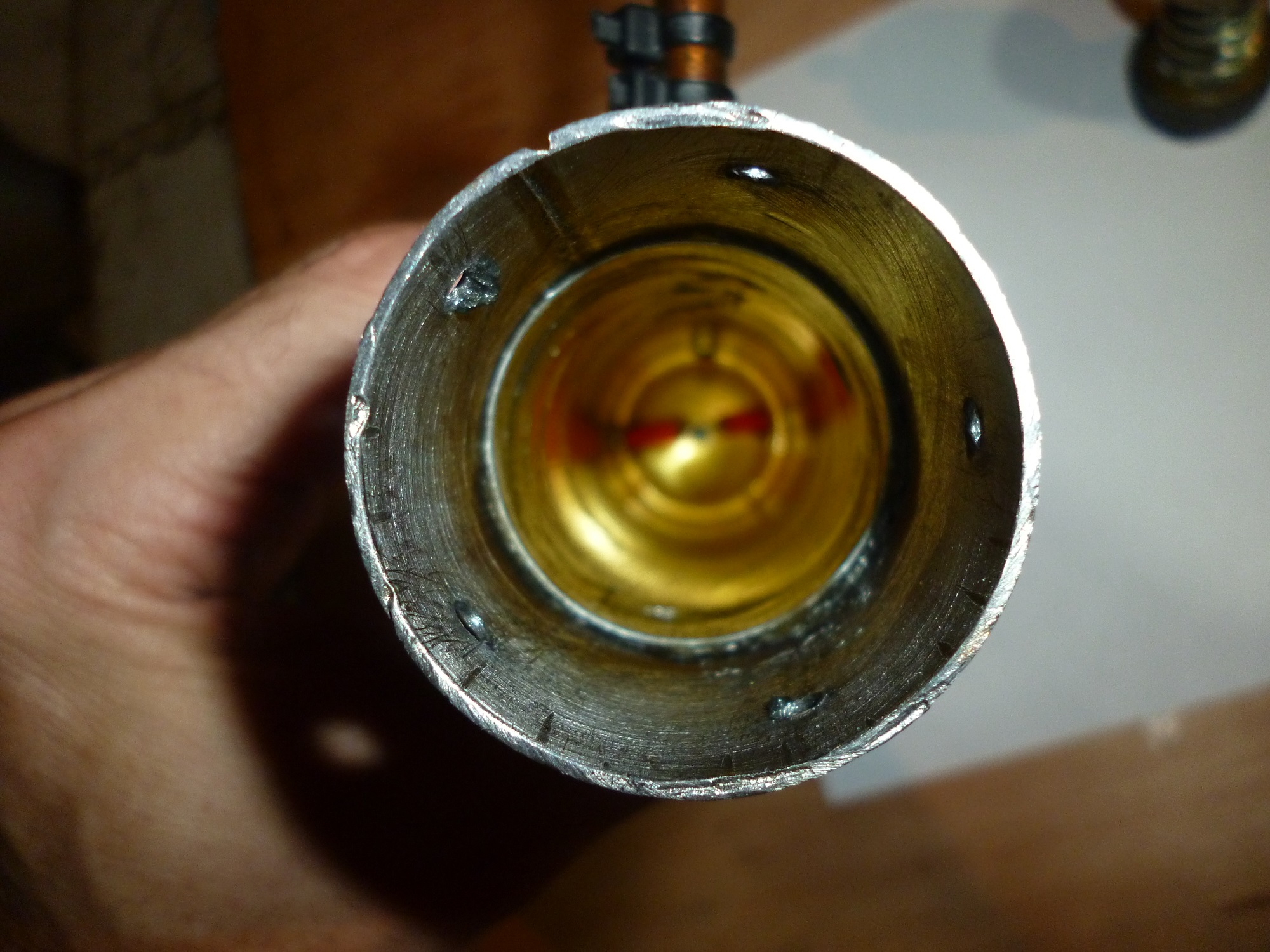

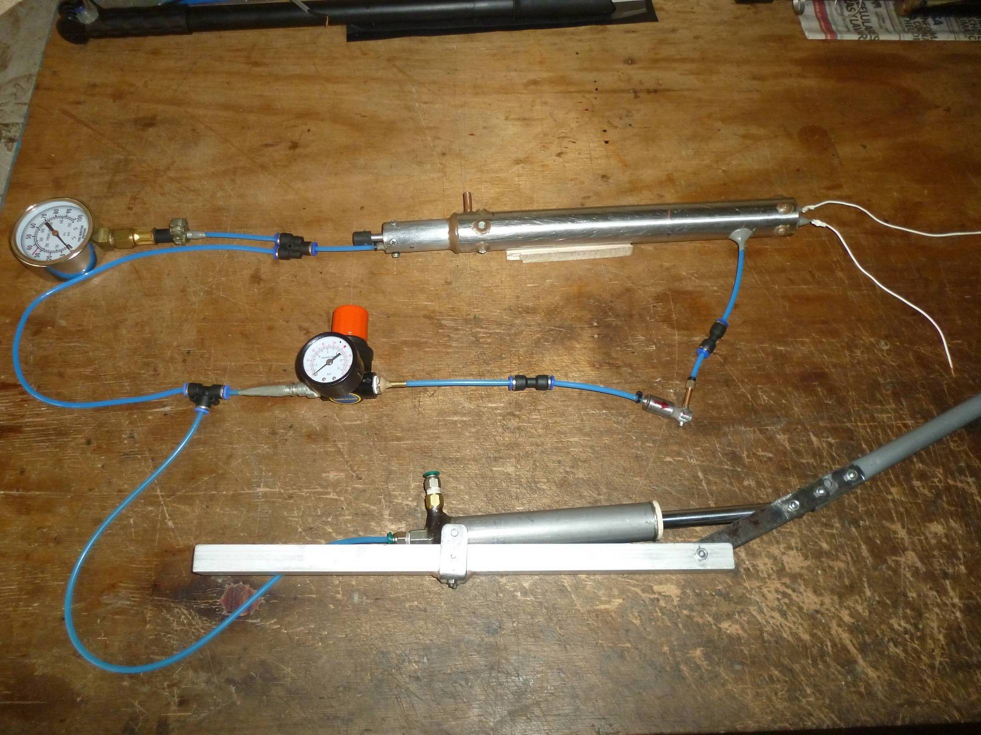

Images 1 and 2 are from the recent test.

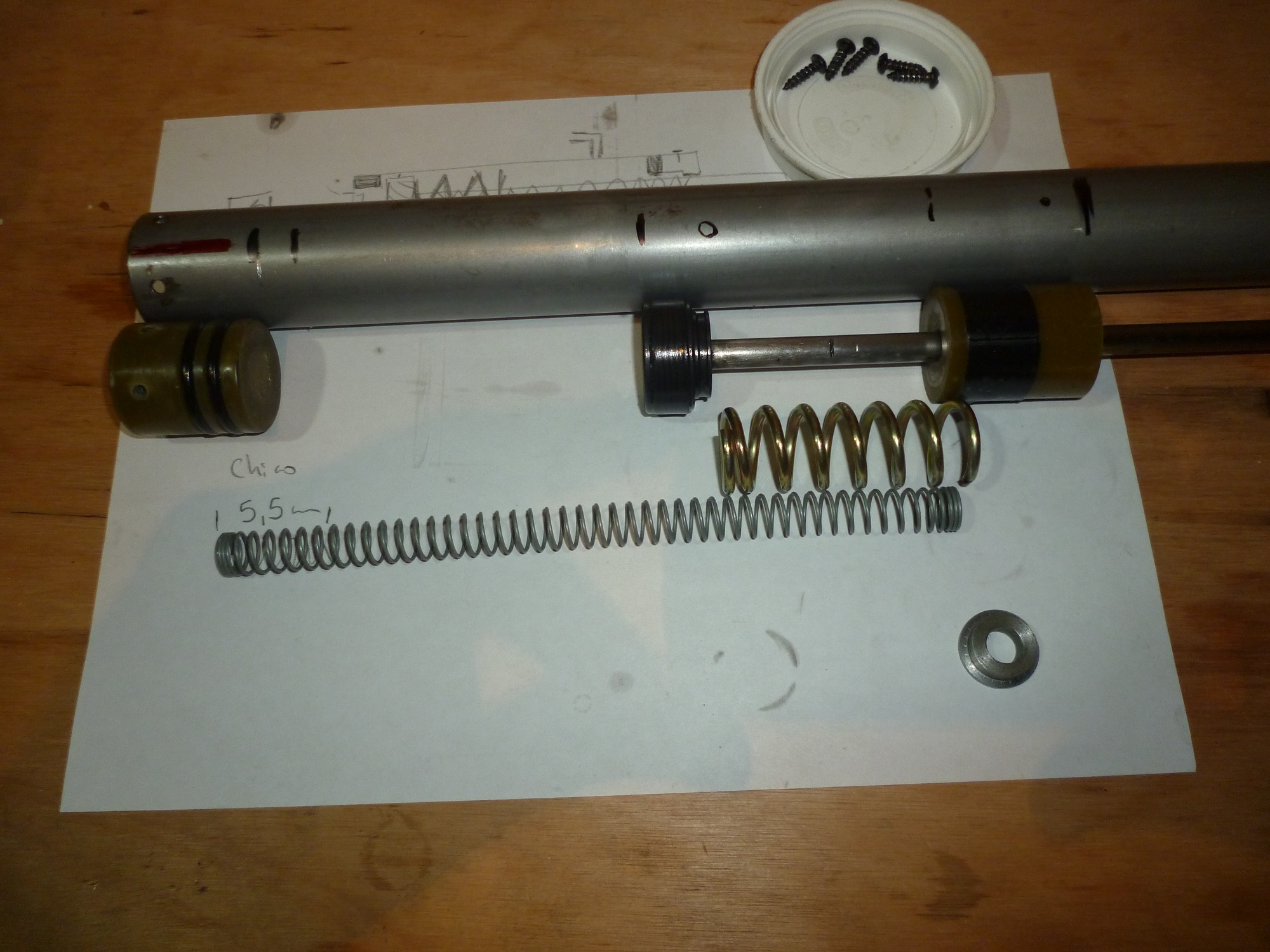

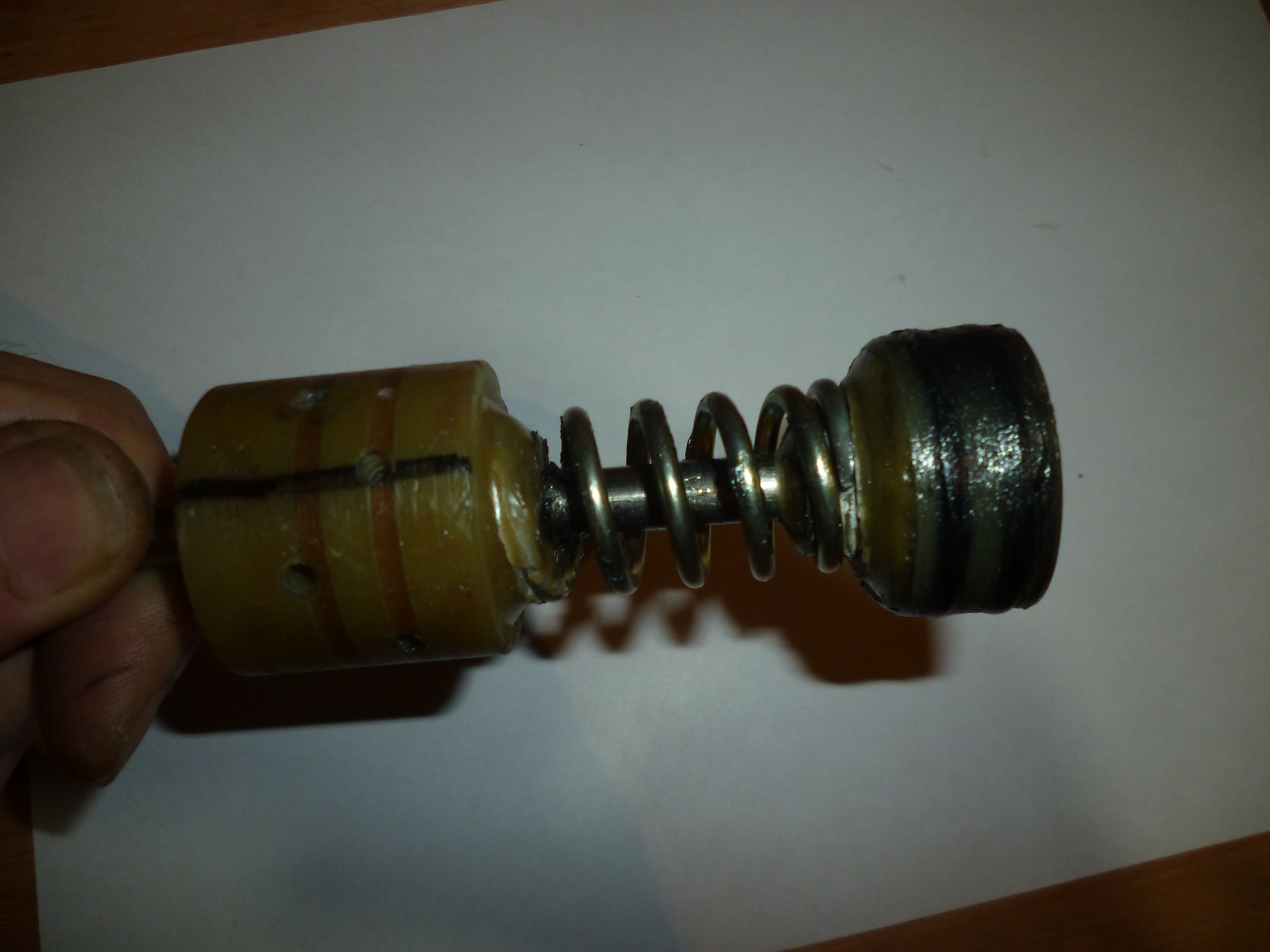

Image 3 is a new one that I am building. 8)
This has double spring. One is to return the piston and clean the combustion chamber, it is the thinnest. The other, the largest, is responsible for retaining the piston in its position when compressing the air-fuel mixture. The small spring runs inside the large spring, which is very hard. When combustion occurs, the pressure peak further compresses the large spring, and the outlet orifice is opened.
