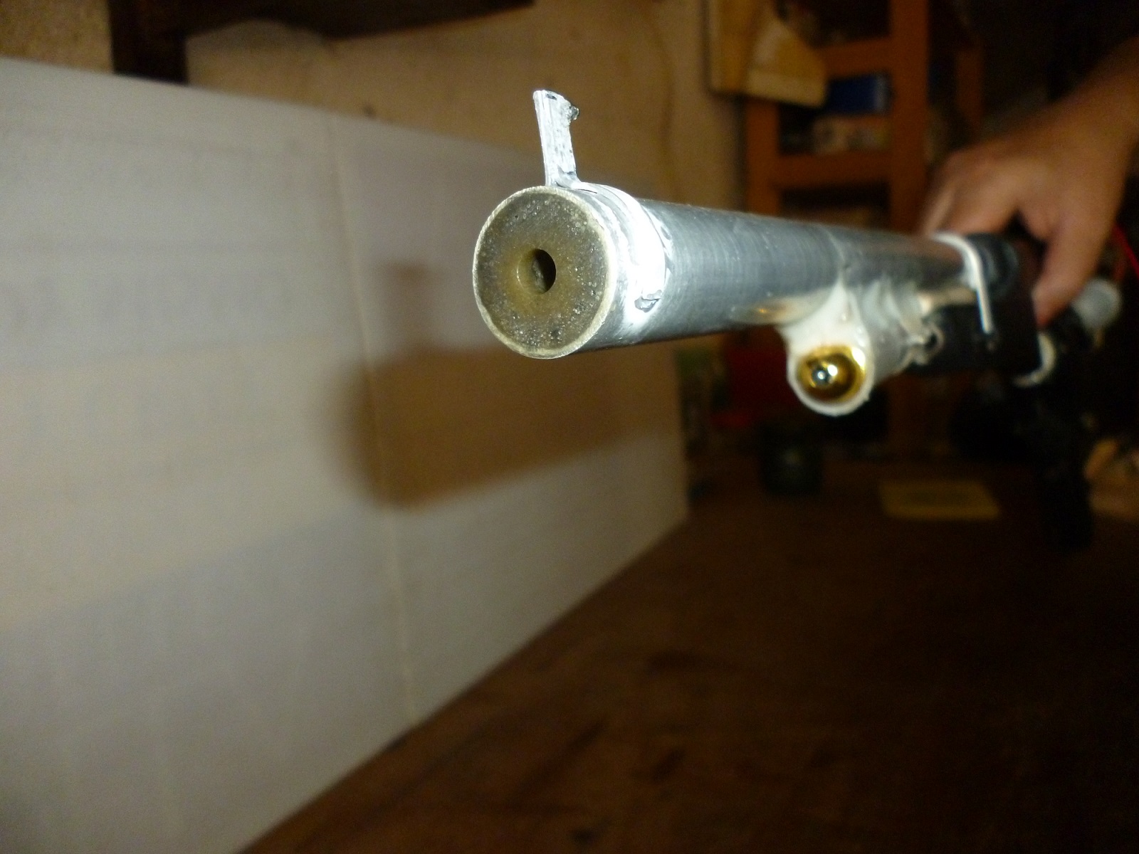

I make my own pipes with a metal tube and epoxy resin. You just have to get a rod of the caliber you need, straight, center on the big tube, on both ends, cover one of the sides and fill with epoxy. You must not forget to oil the rod that determines the size because if it sticks ... it does not work at all. The rod that determines the caliber you are looking for must be removed without much effort.The rods can be of any material but must be completely straight.

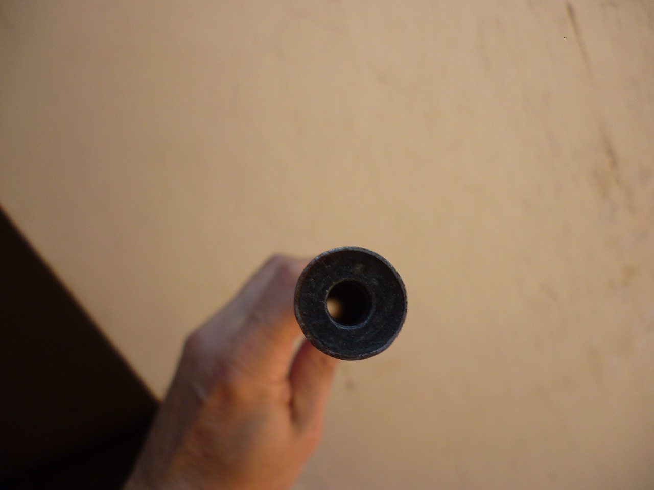

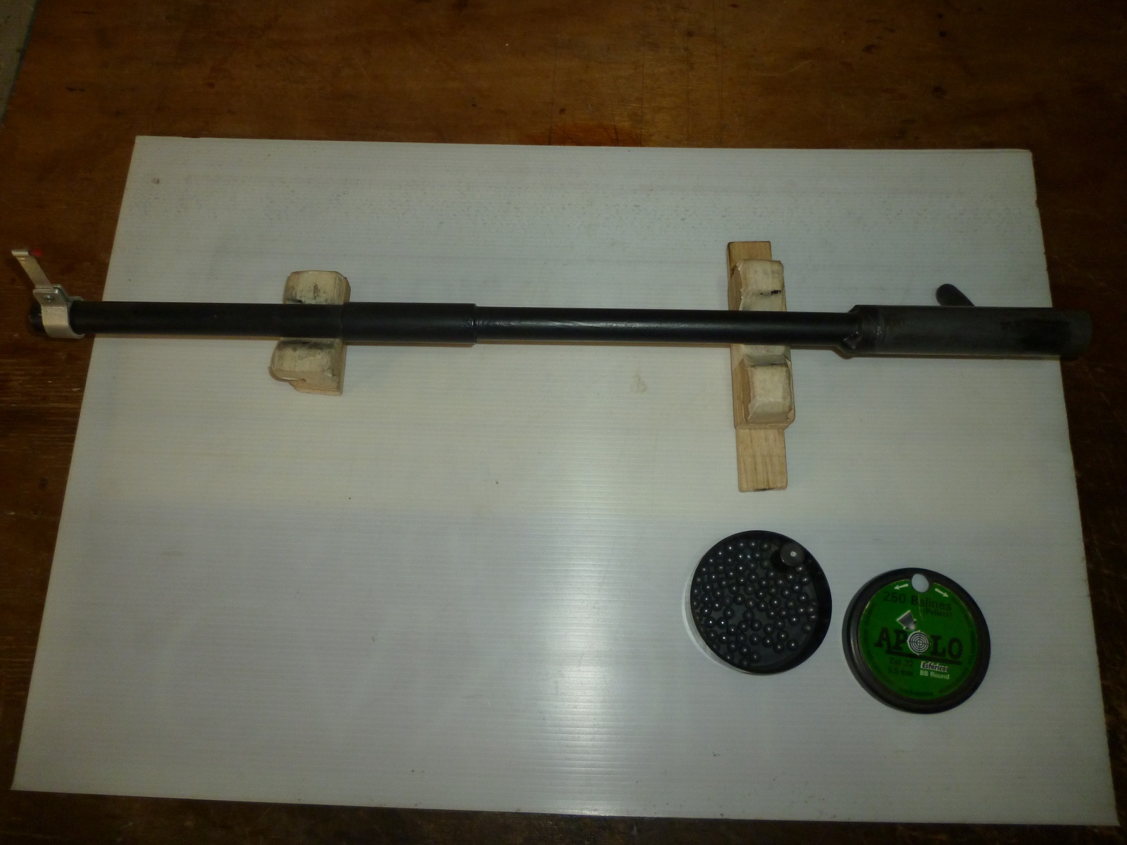

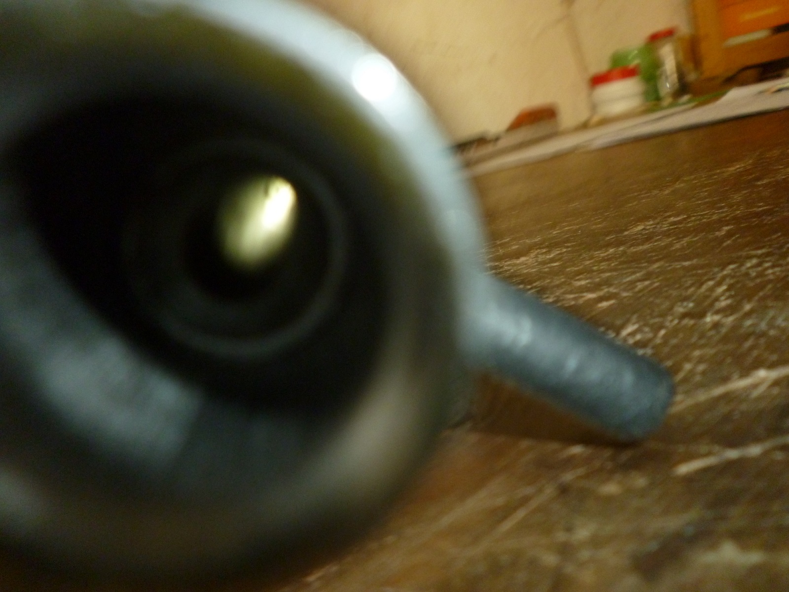

I see that it did not work in your tests. Possibly you omitted the lubrication, I do not know.
My procedure is to paint with a soft pencil the rod that gives the size of the caliber of the barrel. When the rod comes out, that was when introducing it of bright black color, by the graphite, it leaves without anything of this. Everything has stuck to the resin on the inside surface where the ammunition passes. The adjustment is intermediate, neither very olgado nor very fair. Ammunition does not fall by itself due to gravity. The rod that I use are plastic and hollow, Inside I install a carbon rod to leave it completely. The outer tube, which contains the resin, is 5/8 "structural pipe, sanded inside and degreased so that the resin sticks perfectly.
This photo is from the small hybrid prototype 1 cannon that has already shot more than a thousand times, about 4 boxes of .22 spherical lead ammunition and it is perfect. This cannon is united because it was short.
In prototype 2, the one with the loading system, of the last video that I published, has already shot 6X 682 times, and it is perfectly fine. I have not uploaded photos of this canyon because it is armed and I am using it at this time.
Well, I wanted to explain to you how I did it.
