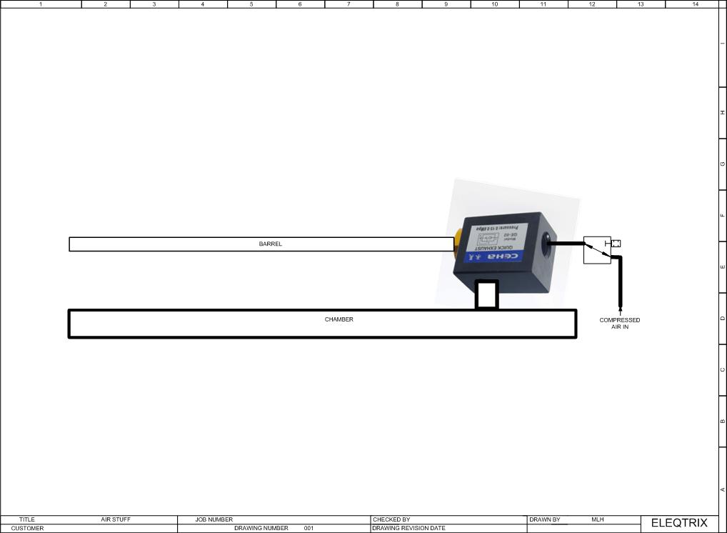

Currently not happy with the trigger i have..it needs to be held down and will then fire once released...so a little backwards. :roll:
Would a slide valve/trigger set up be a better option? Or should i find a better trigger?
I naturally thought a trigger system would have been my best option, but what i have here isn't great.

it will work if you replumb it

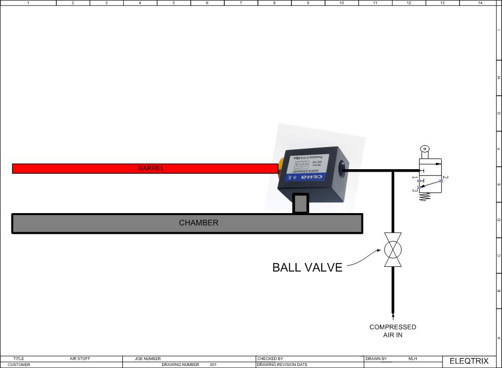

farcticox1 wrote:it will work if you replumb it
Not sure what you mean F1...would i have to open it up or anything like that?

I think this layout will work if these are the parts you have
Or you could make a lever arrangement that holds the trigger closed (spring) and releases it when you pull the trigger, I might actually do that myself for the pistol project as I have a normally closed valve that would make a nice QEV trigger. :idea:

Hmm not sure i want a ball valve on there as well..but thanks F1 appreciate the help. :)

Yeh I wouldn't want any extra valves either, that's why I fill through the trigger valve, so it has to be normally open.

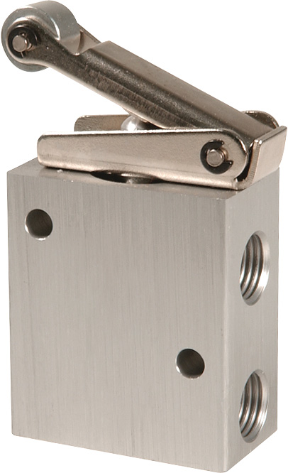

You have a much better trigger valve than mine, i have pulled mine off and almost binned it...slide valve is back on....spent the last hour trying to figure out a way to attach it to a trigger..not as easy as i first thought...also air guns dont open my qev,,:(

I got mine from McMaster Carr, but Princess Auto do a nice 3 port 3/2 :idea:

Thats a nice one you have, very low working pressure rating i noticed?
