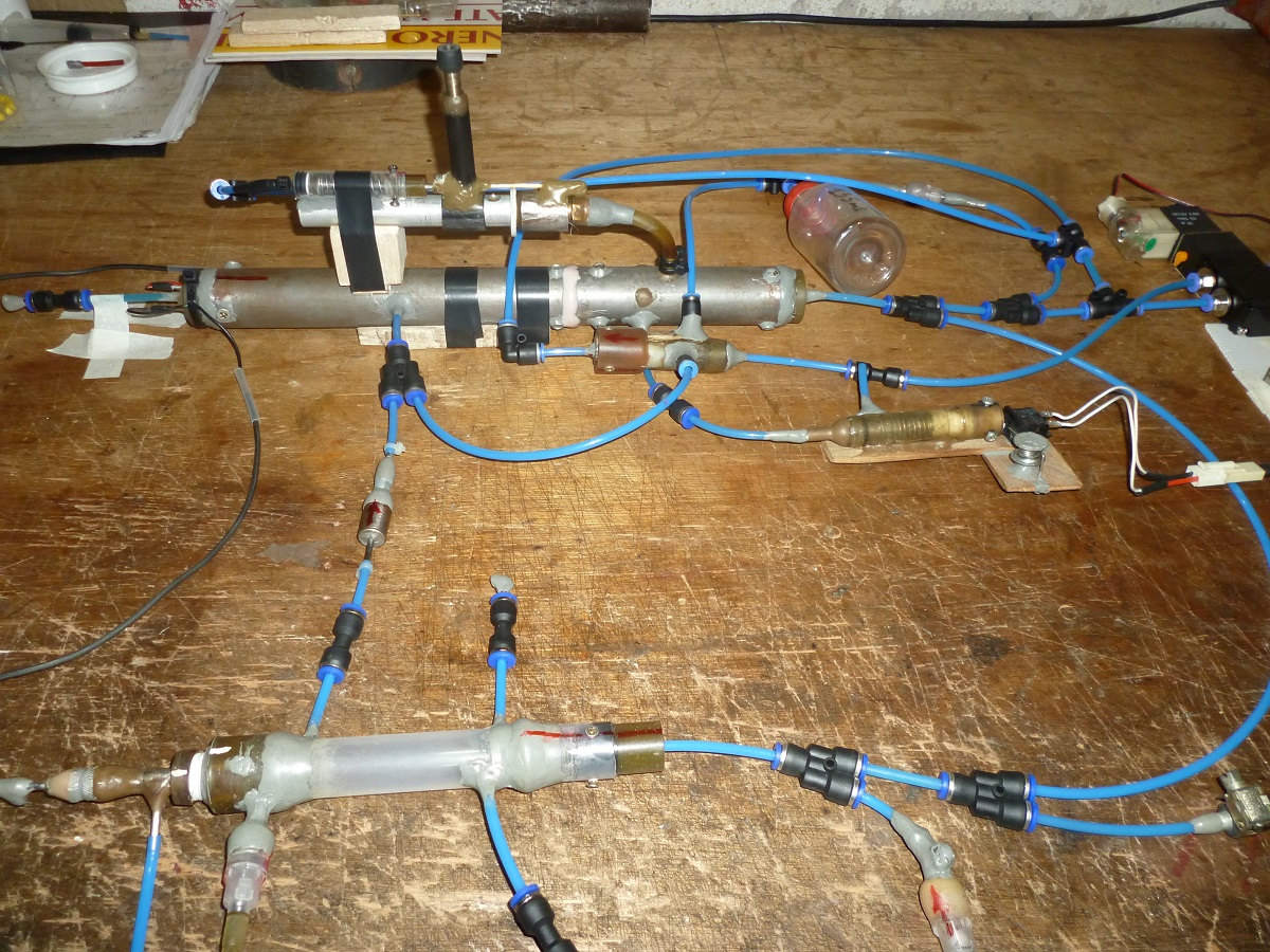

:bounce: :bounce: :bounce: Between your Jack and farcticox1 have inspired me to call the future prototype "FRANKY"
Speaking a bit about the "Franky", I am rapidly manufacturing the automatic ammunition loading system. I'm going to use 6mm airsoft balls to test, since they are not very harmful, if you keep in mind that I'm on top of the "little monster" circulating in front and back and sides. When I have it ready, I film it and show it to them. 8)

I have integrated into the "Franky" a 6mm airsoft ammunition loading system, test. It is simply the same system that I have in the combustion weapons that I have built, but in this case, moved by a pneumatic actuator, commanded by the electro valve. It is of improvised construction, but it works correctly. With this, the design concept tests are concluded. As soon as I can, I'll upload the video of this working.

The horrible noise that is heard is a check valve that sounds .... It is the Franky that begins to breathe !!
On the other hand I had to move before, and with more care, the small 100 mm long gun, so that all the holes do not coincide in the same point

Hi. Yes, what you want to know about this experiment, just ask me. I have tried to leave all the information in this post.dturner wrote:Hello can i get more information about it.
Apart from this, I see that you are new. You are welcome!

Just wow, really amazing to see this in action. You have succeeded where so many others have not even dared to try, kudos!

Thanks Jack! Actually I think that few are interested in complicating the experience of doing something simple and shoot, with a thing like this that I show here. It is an experiment that I wanted to do so as not to be left alone with drawings. In the future I will try to build a prototype with the data that I have compiled neatly from all these experiences that interest me and are very much in themselves. There is still a LOT to simplify and optimize but until now, at least I have a real idea of what the problems of a semi-auto hybrid are. I am in the stage of experimenting, and I still have to try two or three more ideas, which I am thinking about. I play in this way simply because I like to experiment.jackssmirkingrevenge wrote:Just wow, really amazing to see this in action. You have succeeded where so many others have not even dared to try, kudos!

This is an obvious simplification of design. Avoid using a piston rod that scans burned gases and a spring. It works better than the spring. The only precaution is to give the right minimum pressure to the left part of the combustion chamber, where there is only air, because the blow it gives when the pressure of the air - gas mixture disappears, at the moment of the explosion, is very strong . I have not differentiated the sound of the explosion of the shock sound of the piston against the limit of the combustion chamber, when it returns. I have pressurized it with 0.6 bar, and it is more than enough to fulfill its function.
