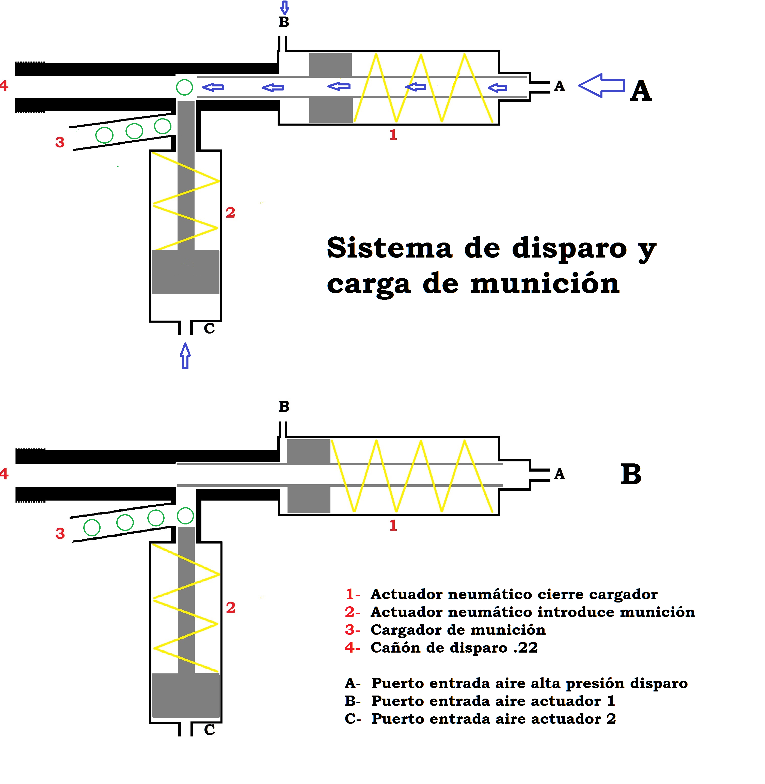

Sat Feb 10, 2018 9:04 am
My system is like that. Can shoot semi auto and full auto. :D
