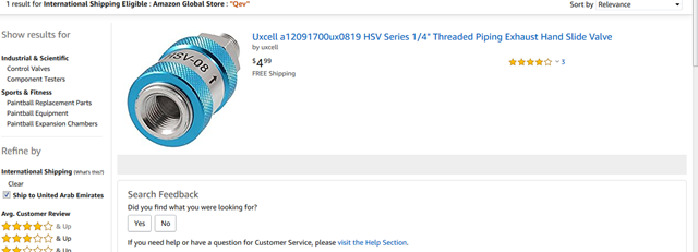

QEV, slide valve, schrader etc easiest combo to make a decent gun but i can't even get some of those here in local shops and the only thing that can be shipped here by amazon is the slide valve whose shipping price costs more than the item itself.
I cannot order airguns from outside the country the one sold here only locals can buy :cussing:

Got reply from airgun depot and fedex, they said they wont ship.
The QEV and slide valves from Chinese sellers are cheap but they aren't making clear of other charges like recently this country implemented VAT.
